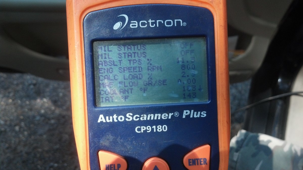

Hi everyone new to the site and so far learned a lot from everyone and its been very helpful. I own a 1999 Volvo S80 2.9L and like a two months ago I noticed that I was leaking coolant. I did some inspections around the radiator and found a crack. Well I get a new radiator and begin to install it. In the process of changing the bottom radiator hose I took off the upper part of the air box without disconnecting the MAF. Now while I was finishing the installation of the radiator I noticed that the left 02 sensor cable was pinched by the metal plate under the car that goes over the cat. Well I loosen it and brought around and tied it up with zip ties.
Now here is my problem, I turn the car on and BAMM!!! CHECK ENGINE light ON. Now I take my OBDII scanner and I get P0102 low input. I always noticed that while with this code. my scanner showed no OHM reading on the screen. I buy a couple of used ones and get the same code. Later I buy a new one online (cheap) and gives me a code of P0103 high output. I bring it to a Volvo place and paid $50 for the scan (just to make sure) and he said that it was the MAF and the left O2 sensor (gave me a price of $911.25). Finally after the frustration and headaches I go to a local auto parts store and buy a OEM one which is # 8670112. I Installed it and BAMMM! gives me same code from the beginning P0102 which is basically no reading like the pic. I was very discourage and down so I called a dealer and told them my problem. The technician said well you need "VOLVO" product not "OEM". I told him that VOLVO doesn't make parts BOSCH does. I bought OEM BOSCH #8670112 came in yellow box with Bosch red letters certified with their seal. But they told me that no that I needed VOLVO parts. Now to me it makes no sense, I already know that my car does not need an update to install the MAF. But paying $337 for 02 sensor and $325 for MAF just because it says VOLVO on the outside box when Bosch is the one who makes them its ridiculous. At least I was able to return the OEM sensor at the store but on a dealer I cant do that.
My point here guys is that my car is losing power and now when I hit the gas wont even drive pass 20 MPH I got to drive it like if its manual to pick up speed. I just want to know if there is a way to check if the wires are messed up. If the 02 sensor is triggering the MAF once I loosen it from the pinch Or should I spend all this money to basically end up broke and my car still with the same problem.
I need help guys. I love this car and its messing up, Thanks.

Have you tried running the car with the MAF unplugged to see if it runs any better ? It's a simple way to rule out if the other components are failing.
As far as parts and Volvo's go, I have found that OEM used is better than any aftermarket new "OEM" part. It's not uncommon to get bad aftermarket sensors off the shelf at your local parts store, the quality control on these aftermarket parts are not the same despite them being the same manufacturer.
Have you checked the voltage coming into the sensor and the grounds? If this is out of your scope of skill I suggest taking the car to a professional before you waste any more money throwing parts at it.

Thanks BradF80. I did unplugged it before and the car stayed the same, running rough. But two days ago I unplugged the sensor and the car shut off, I guess that means that the sensor was bad. I put another one in and still running rough but ill check later on again to see if it shuts off with the one that's in.
I have three OEM used sensors but the do the same roughness. Well I have an OHM reader but I don't know much about electro mechanical issues. how do I check the ground? What's the voltage reading that it should give me? (if you know). I tried a couple of places and some told me they don't work on Volvos. Again thank you and ill keep everyone posted.
