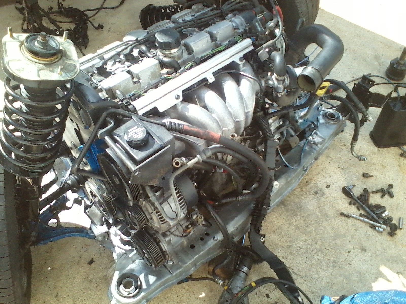

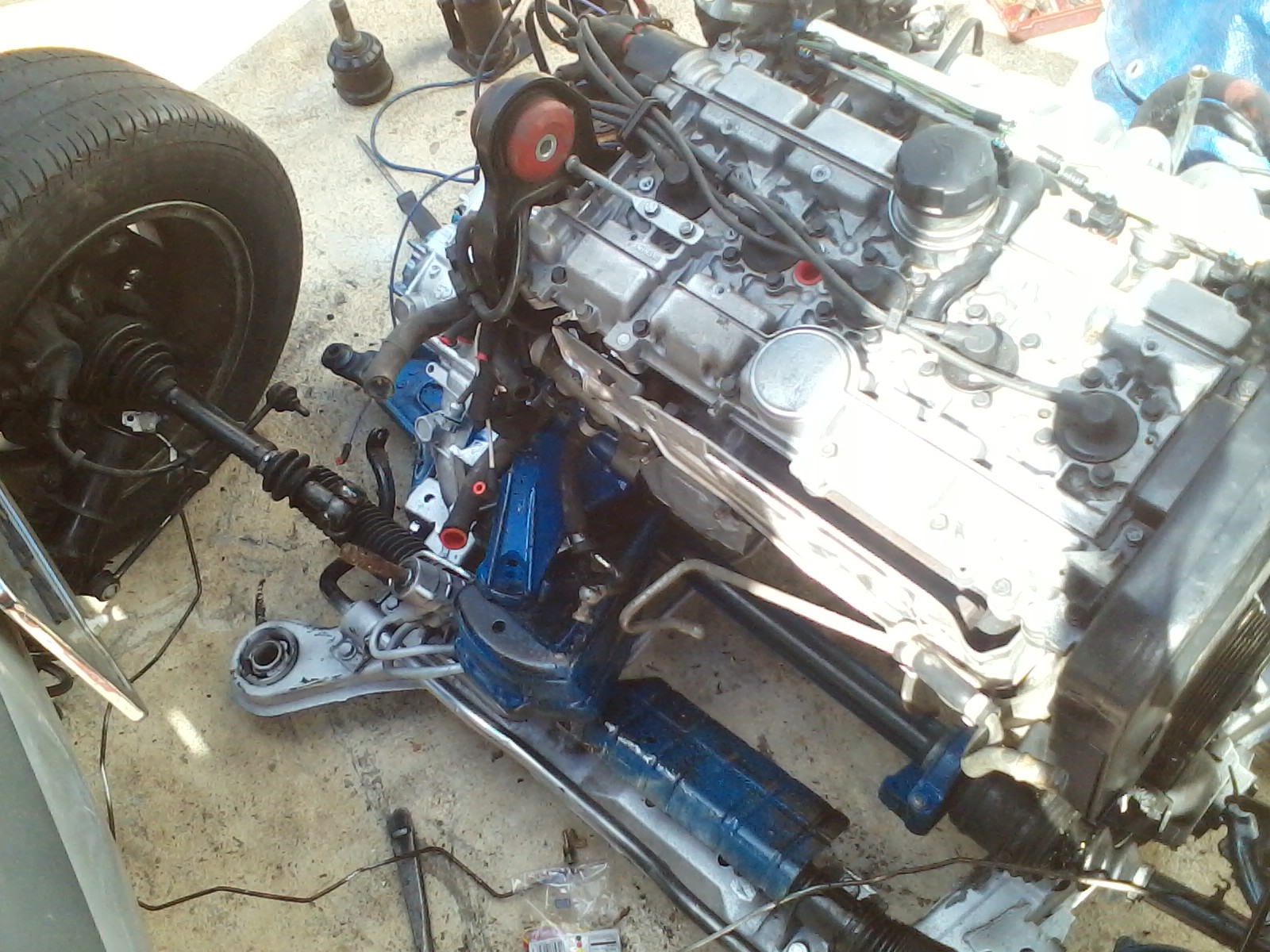

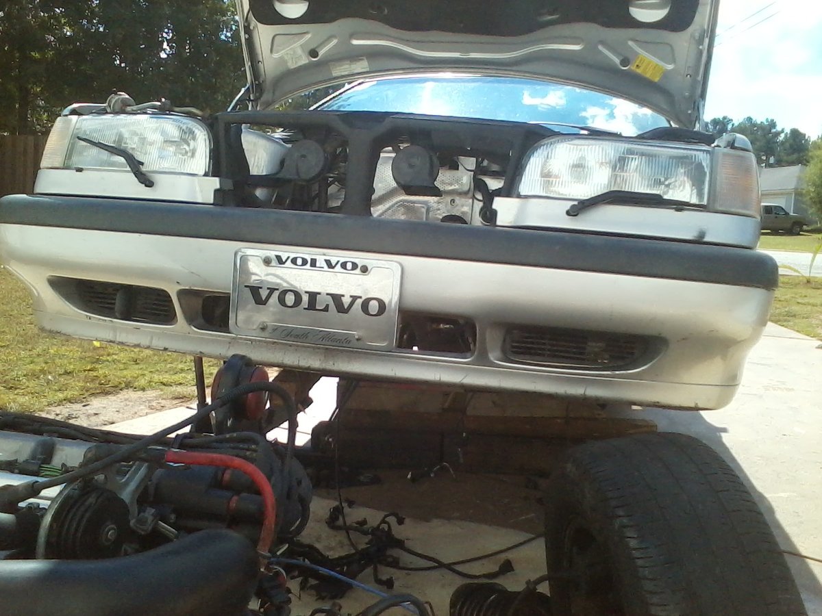

OK, so my mechanic has the subframe out and already replaced the new engine and attached it to the tranny.
I'm real bad with a camera sorry about the photos, Thanks for the advice. I ended up having to buy new axles because mine where shot but the o2 censor was fine before and should hold up
