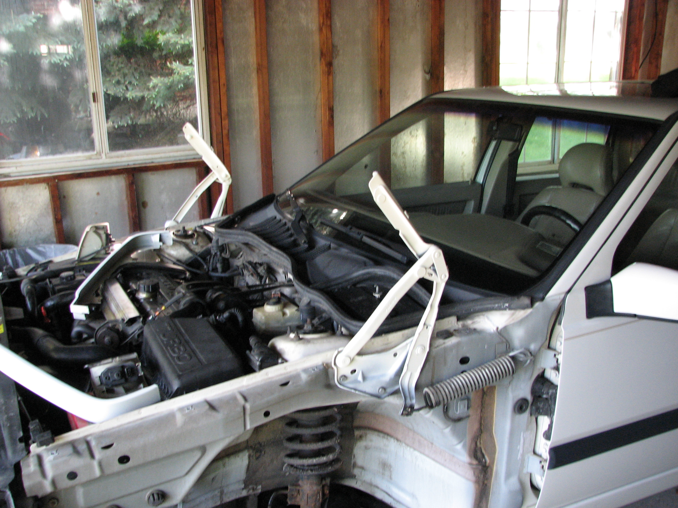

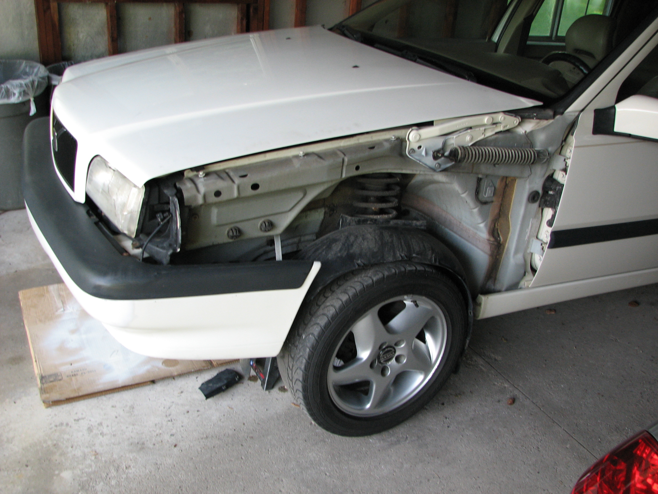

I can show you an example and get in depth with the procedure if you have questions. Look at my wagon in the maintenance log here,
https://www.matthewsvolvosite.com/forums ... 35&t=56550

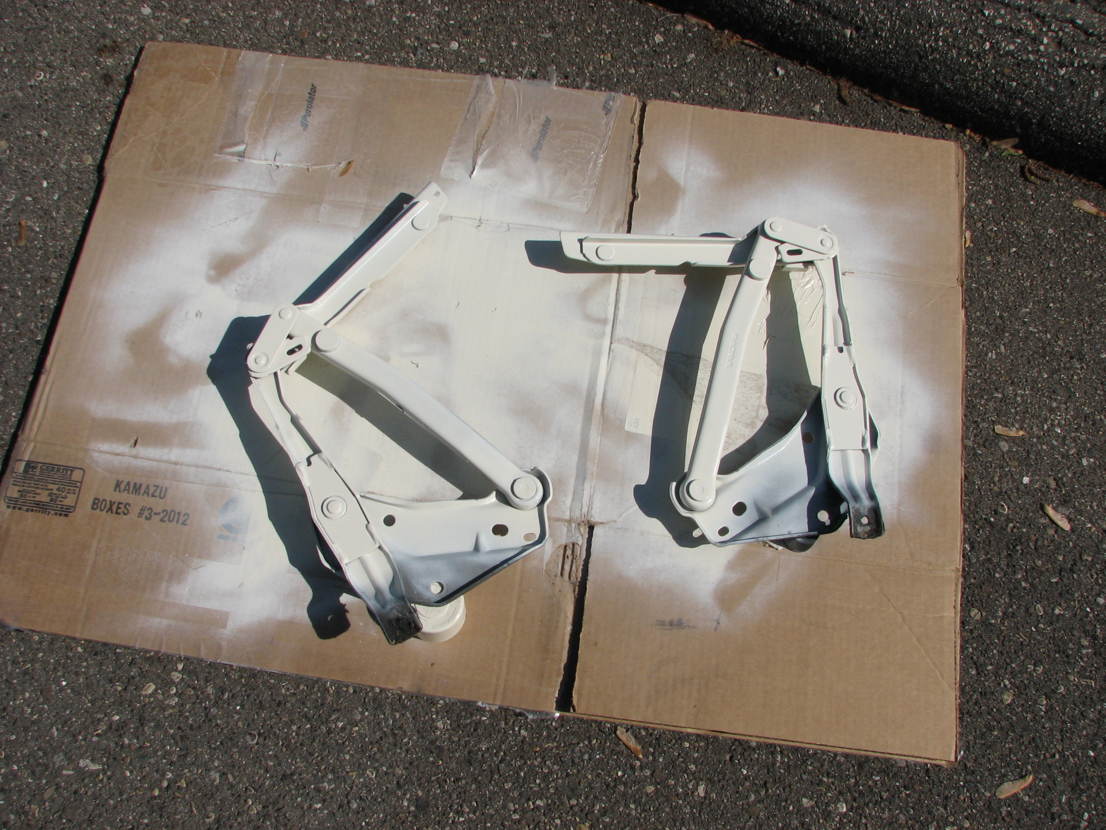

The previous owner had done that, (the hood flip). It involves new hinges, fender removal, and what I had done with a rubber mallet. I had used a wooden plank with mallet to smooth the corners of the bent hood after installing the scrap hinges. These were approx. $8. ea. which I sprayed white to match my car.
Get back with me if you need. Good luck.

Thanks for posting that video Robert. I did not want to bend my fenders while removing the hinges. I had also needed to remove the bumper and did all at the same time.
My log shows what I had done.

When the hood flies, it destroys the hinges. They can be bent back into shape, but replacing is easier. Even if removing the fenders is needed. It is.osman wrote:The fenders only need to come off if you are replacing the hood and the hinges otherwise just the hood is rather simple. Only thing is you have technically 3 hood latches one over each headlight that work from the cable and actually hold down the hood then the third manual one which only is a handle to pull up the hood but must function, it is often repaired with a zip tie or wire hanger.
Trust me.
Edit: Use an 1/8" drill, or there about to remove the rivets from the fender liner. It is quick and easy.
