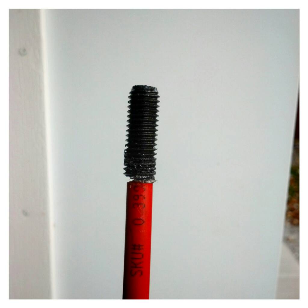

The broken bolt cam out with suerglue and a dowel, after I noticed it was backing out while drilling with a left handed bit.
That's the head and cam cover as it came back from the shop, and the new valve. Last is the burnt valve that caused all this.
