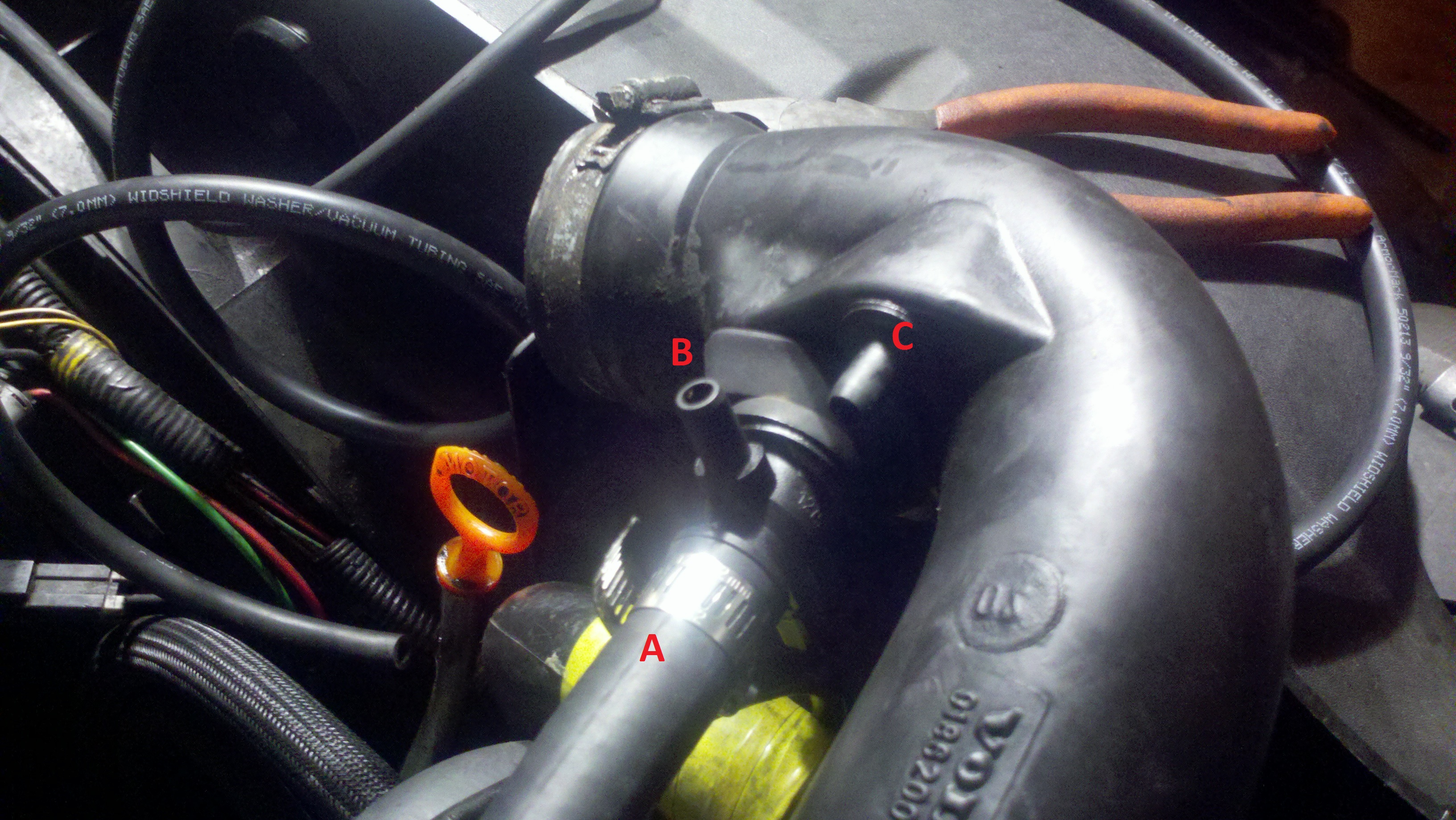

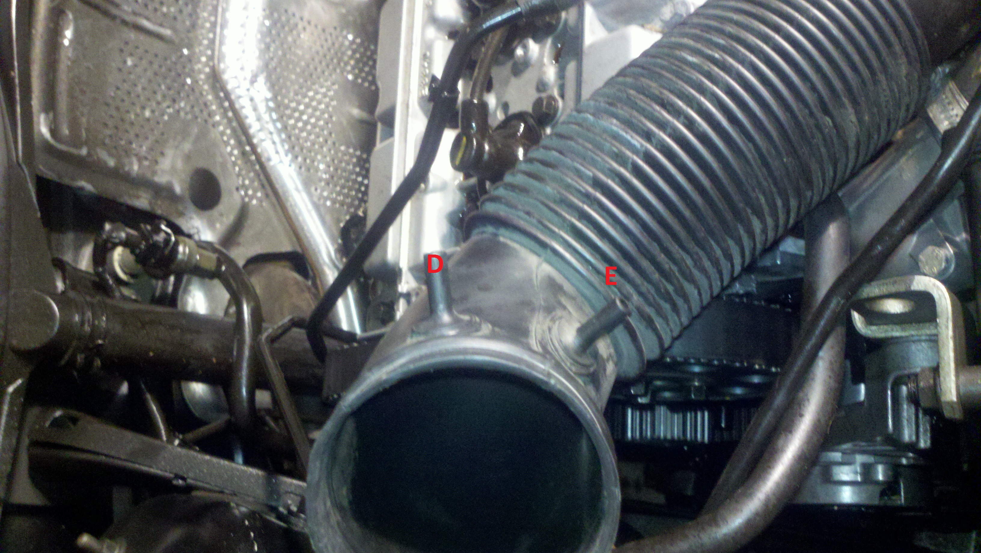

I am in the midst of performing cn90 PCV mod to the s70 and a couple of other mods. I ran into a problem. I removed my plastic intake hose to clean the PTC and did not label the 5 hose connections like an idiot. I have the vacuum hose diagram but I can only find four and it does not state exactly where on the intake hose they go. Help!
A = New I.D. 5/8'' hose to Oil Trap (thanks cn90)
B = New vacuum hose to side of intake manifold (thanks matthew1)
C = ??? Fuel Pressure Regulator?
D = ???
E = ???
1998 S70 Intake Hose and Vacuum Locations

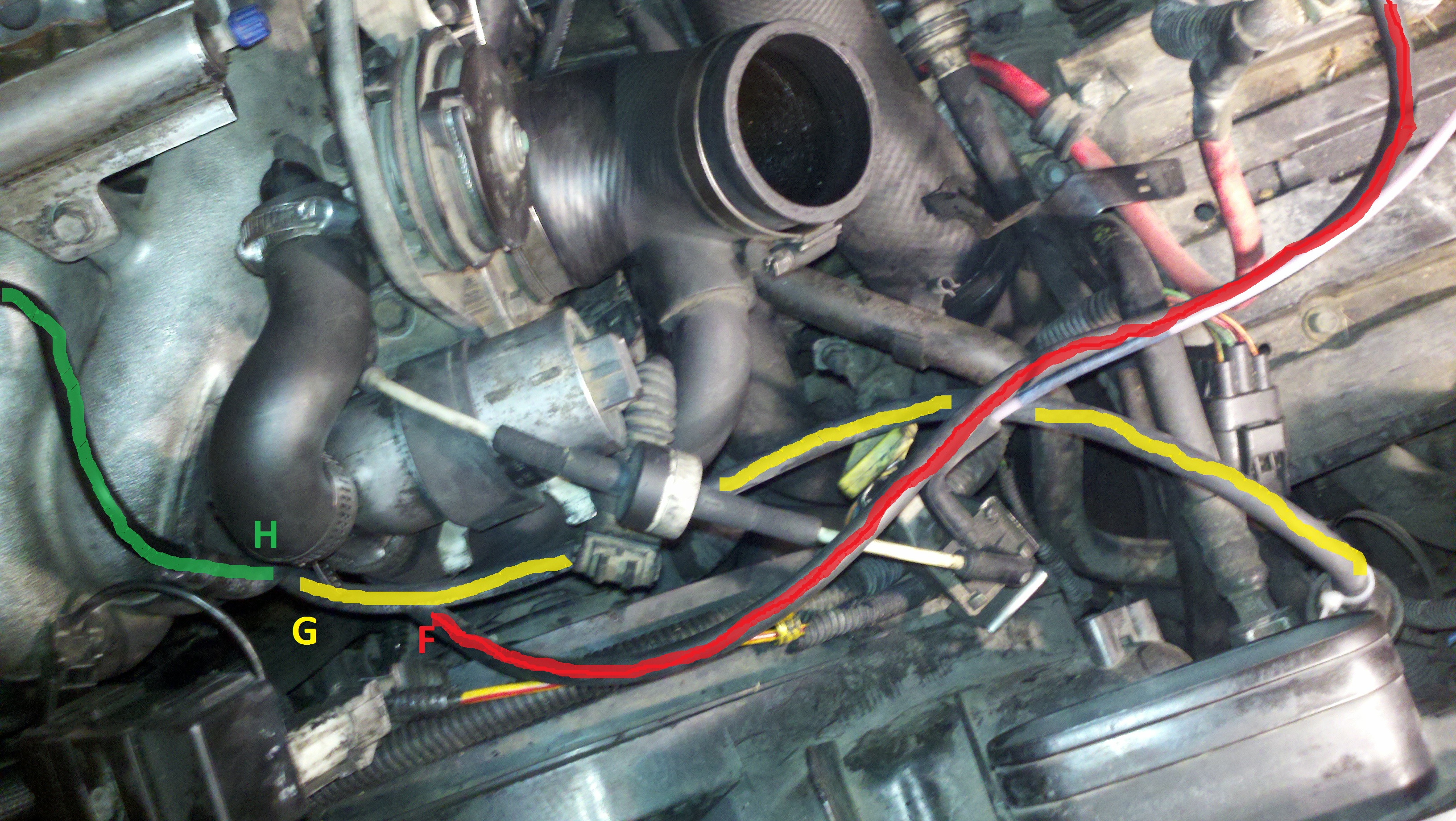

I am also having some technical issues with 1 of the 3 hoses coming off of the intake manifold.
The line in question is Red "F".
F = ???
G = Vac Line to Blk/Wht Inline Valve

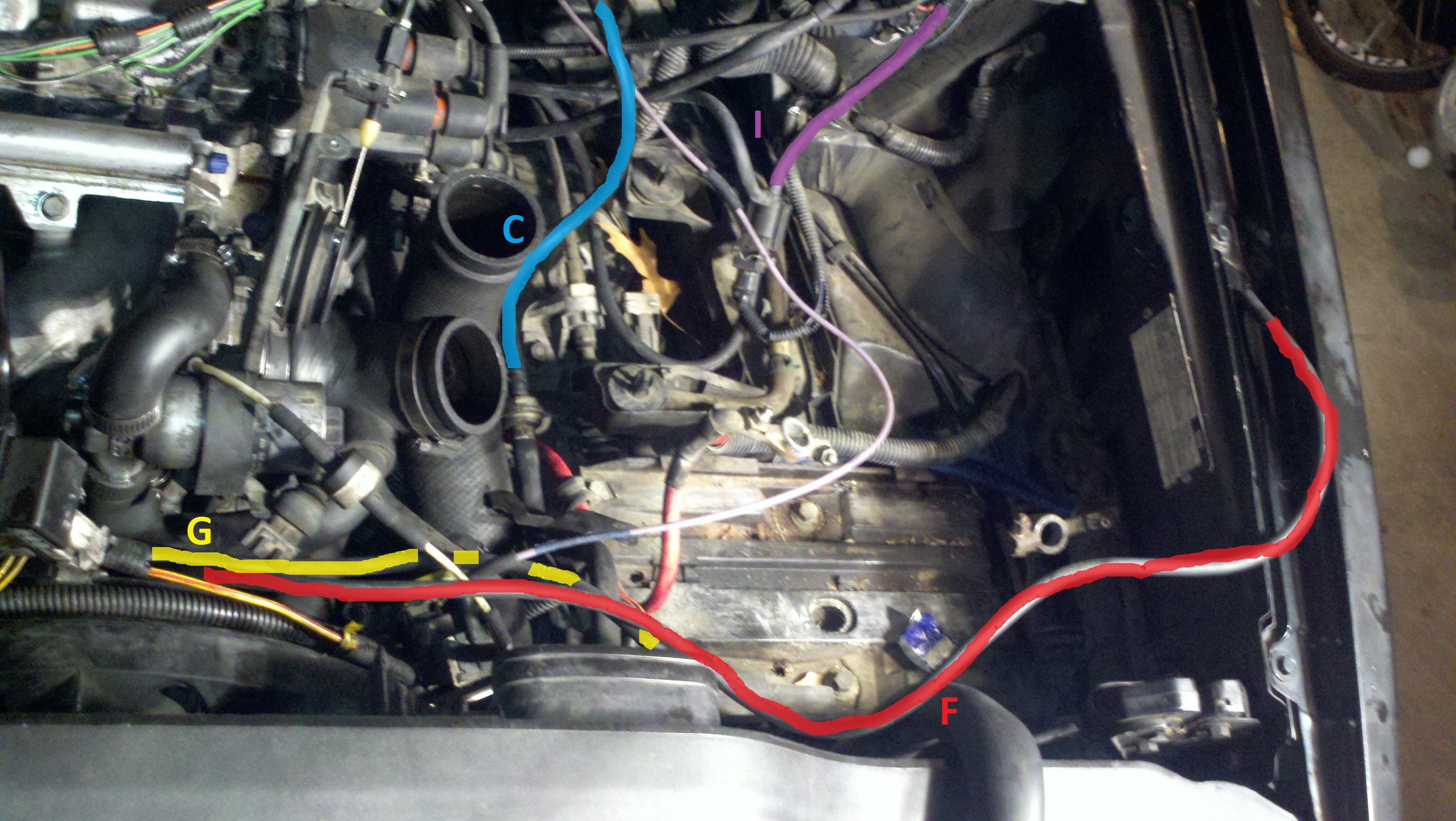

H = Fuel Evap Line w/ new vac line elbow Here is another picture of hoses pictured above. I am 95% sure the Blue "C" is the hose that hits at the bottom of the plastic intake hose NEXT to the PTC nipple, not on it. Purple "I" is a line to the clip that mounts on the air box. I think it routes to one of the nipple on the top of the plastic intake hose pictured above at possible D or E location.
C = Next to PTC to Inline Wht/Wht Inline Valve ?
F = ???
I = ???
F = ???
F = ???
I = ???

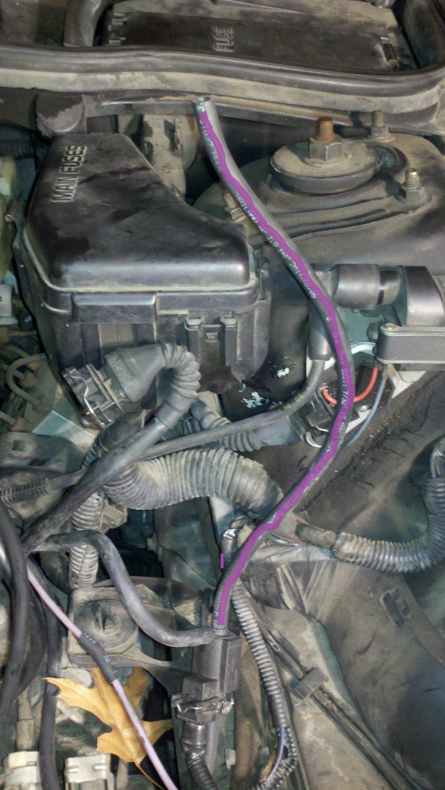

Here is another view of Purple "I" and the clip that connects to side of air box. I am thinking this is a vacuum line to a nipple on the TOP of the plastic intake hose, I think labeled D or E from above.
I = ?
I = ?

your blue C line goes to connection C
your puple I line and red F line goes to the connections D, E
Connection B should go to the elbow on the passenger side of the manifold
That should cover it

D = F
E = I
C = C
I think that does about cover it! Maybe I can edit my previous posts as *Resolved* for a possible sticky for vacuum hose diagram that is a little bit easier than the diagram posted under the hood.
E = I
C = C

D to F seems counterproductive to me. D is obviously going to have suction from it being routed off of the plastic intake hose but to me it seems as if F would also have suction from it being routed off of the intake manifold. Can anyone else confirm that hose F, from intake manifold, routes to nipple D on top of plastic intake hose?
kickin_it
- Posts: 213
- Joined: 27 Oct 2011, 00:52
- Location: Franklin, Tennesse
I think this diagram finally reveals where the hose form the manifold ends up and it is on the turbo and not the plastic intake hose.
- The green hose connects to one of the nipples on the intake manifold
- turbo.jpg (67.97 KiB) Viewed 7110 times
