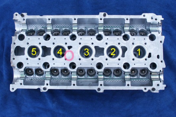

That hole gets posted about every couple of weeks. It is not a breather hole, it is a leftover from the early models (93-94). On your car it should be sealed from underneath and when it is, no oil can leak out of there. It should be bone dry.
So either the cam cover didn't get sealed properly and it is leaking there, or the oil is coming from somewhere else (filler cap gasket and PCV line are two very common sources) and accumulating there.
Do the standard drill: clean up all of the oil, watch where it is coming from as it starts to accumulate.

Thank you. I went out and did that. I can watch the hole fill with oil coming from the bottom of it. Look s like i will re seal the cover, and hopefully be good. Again, thank you for the reply.

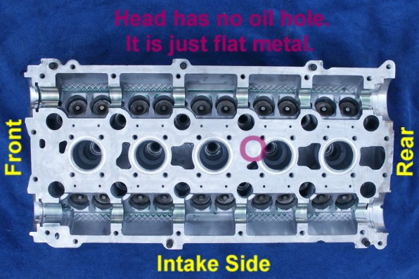

Where did you get the head from? That hold should have been blocked.

Cover hole should seal over flat spot on head.
