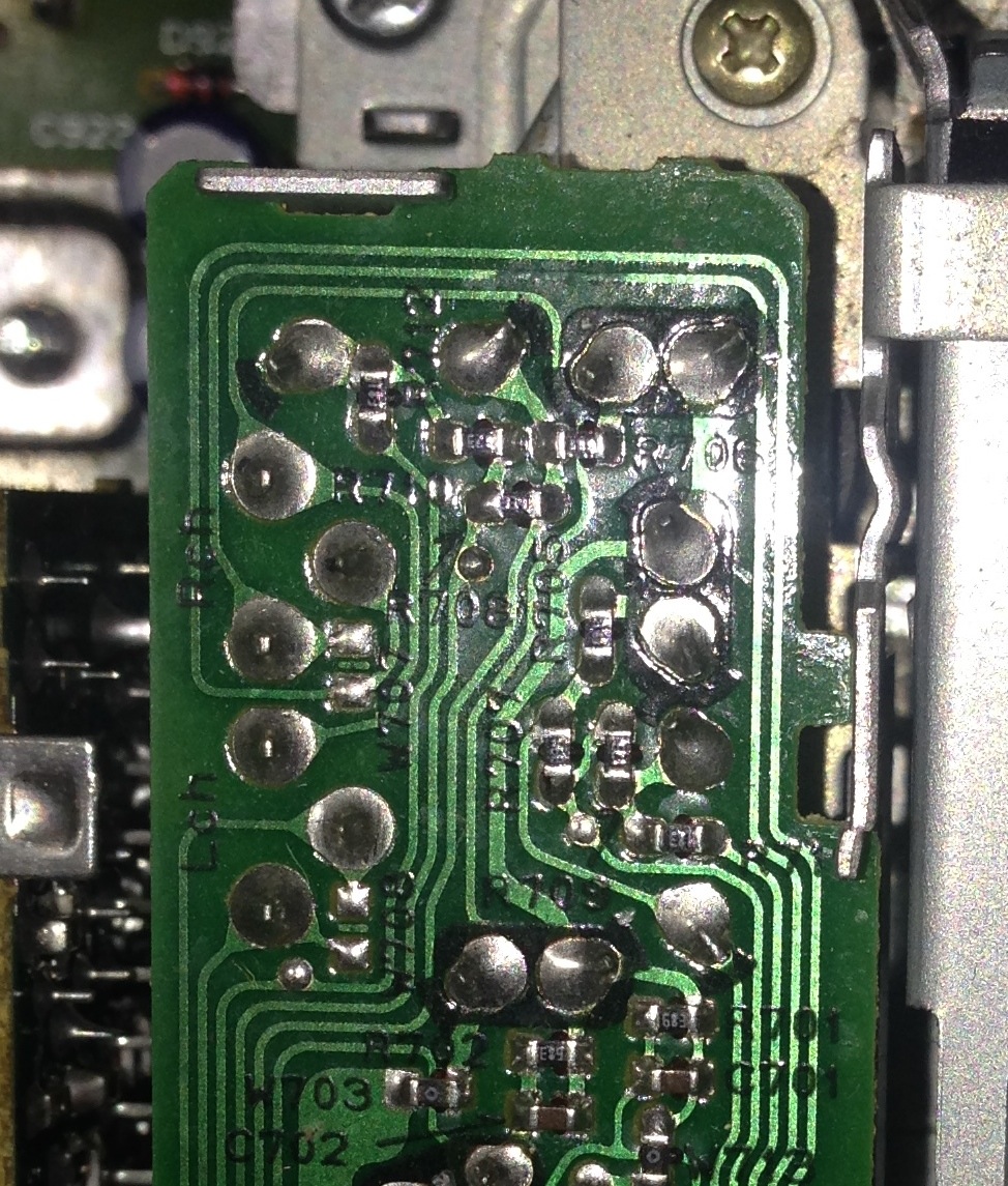

Im putting in an iPod onto my SC816 tape deck and have a different circuit board then the thread in audio
Here is a picture of inputs - can anyone guide me to the L/R for this system? The L-Channel and R-CHannel markers are as useful as birdcage full of goat manure...

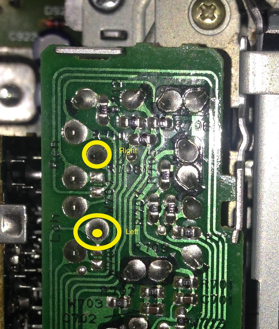

Found it at
http://www.atthetipwebs.com/technologyi ... ct8131.jpg
I will confirm and put picture here as most of the other links are broken
- VOLVO SC816 Tape deck Circuit Board.jpg (460.74 KiB) Viewed 3053 times

Works like a charm, thread moved to AUDIO Forum

If you look at the circuit board it is notated Lch and Rch right near the edge.

You cut a 3.5 mm iPod jack and solder the wires to the points indicated in the picture.
Now you plug your IPod into the radio, select tape, and play music from your iPod through your stereo.

Select tape. That was the key piece of information.
This modification injects a signal by wire into the tape subsystem, hopefully after the magnetic pickup preamp. If so, it would result in good signal quality, on rough par with CD. If not, might as well just use one of those cheap tape adapters.

Sound quality is on par with CD. I did both my V70 and the SWMBOs BMW over Xmas
