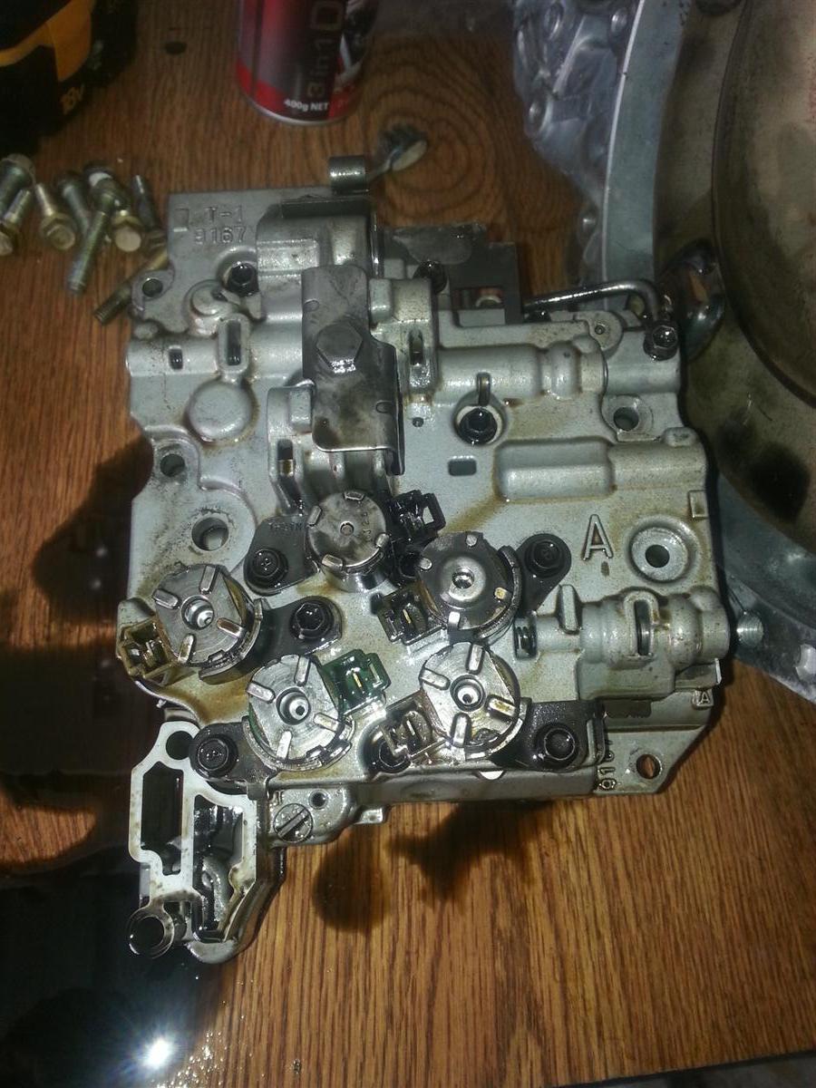

I have an "A" series valve body. These were the second ones produced. Earlier ones had no marking.
So far SS1 through SS5 have passed the ohm tests and are between 11 and 16 ohms (@70deg F or 21degC)

SLT, SLU & SLS solenoids were checked for electrical tolerance and are all within 5-7 ohms between the pins. However this doesn't mean they are mechanically OK. They could be so packed with foreign matter that they don't operate at all.

The valve body will be disassembled and new gaskets fitted as well as the Transgo kit items fitted.
Valve body (yes the fluid was really THAT black!! )

Did some more testing today on the SS1 through SS5 solenoids. I get no actuation of solenoid 4. It draws current and has the usual ohm reading.
See what you think: :)

I believe that S4 is stuck on. This would explain no reverse. I'm going to run some solvent through them tomorrow evening and see if S4 begins to actuate.

I cleaned up S4 only to find that the spring return has failed on it.......when the solenoid is shaken by hand the armature rattles inside. If it lands in the right position, applying voltage creates the right noise however it only happens once, then you have to shake it and reapply voltage.
I don't know if that functions list is correct DGM. S4 has function for reverse If I recall correctly all solenoids are off for reverse according to ATSG. There are several functions lists depending on valve body model. Perhaps that one is for another car or simply incorrect.
The oil pressure forces S4 into an unnatural ON position because of the failed return spring.
