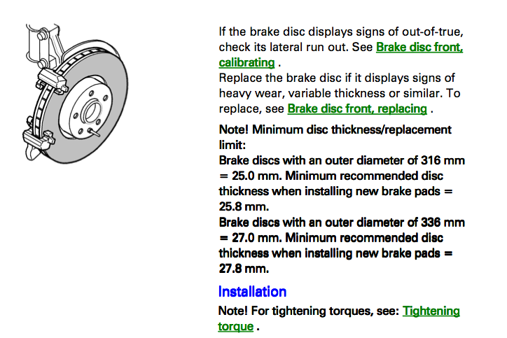

Do you know off hand what the minimum rotor thickness should be?

tailor
- Posts: 570
- Joined: 12 November 2006
- Year and Model: 2004 XC90 2.5T AWD
- Location: Toronto
- Been thanked: 2 times
Here you go!

walleye vision
- Posts: 10
- Joined: 26 October 2013
- Year and Model: XC90 Sport, 2008
- Location: Minnesota
Awesome, thanks!
