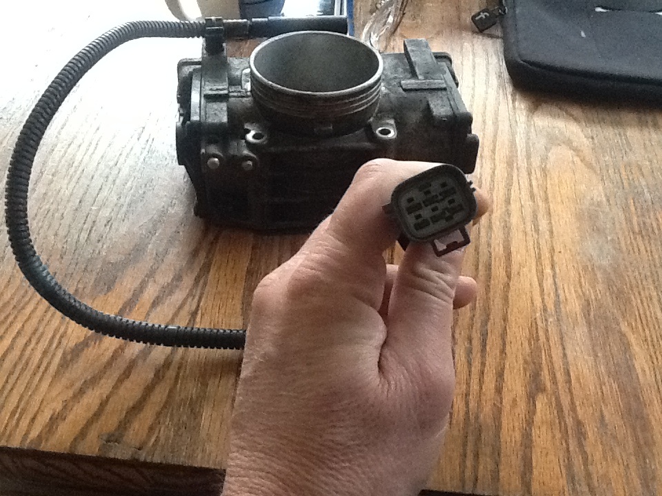

I would first clean this connector. You may have washed in debris. If this does not clear the code follow the write up on how to clean the throttle body. it would not hurt to attempt a cleaning before you shelled out bucks for the XeMODeX. We did have to use this Mod and it solved all our problems. Great product.

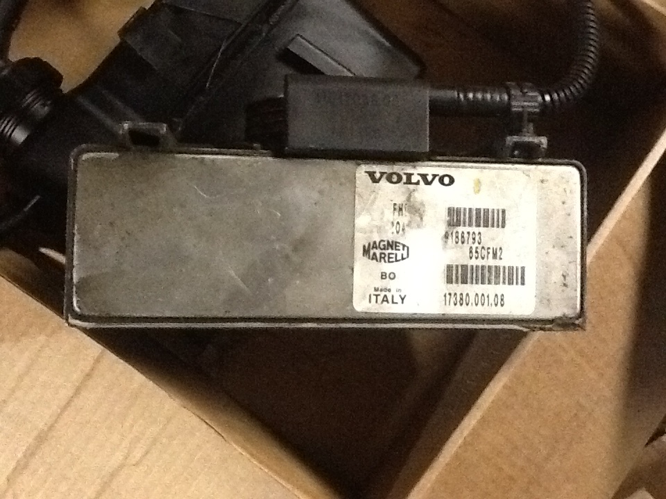

being down this salvage road before I am not aware of any sure fire way to evaluate if a salvaged TB works. It is a gamble. You can increase your odds if you find a TB with a yellow label. The factory installed TB have a white label. A yellow tagged TB means the donor car has had it's TB replaced at some point in time at a service center.

A junk yard version with a yellow tag may require programming at the dealer to work.
