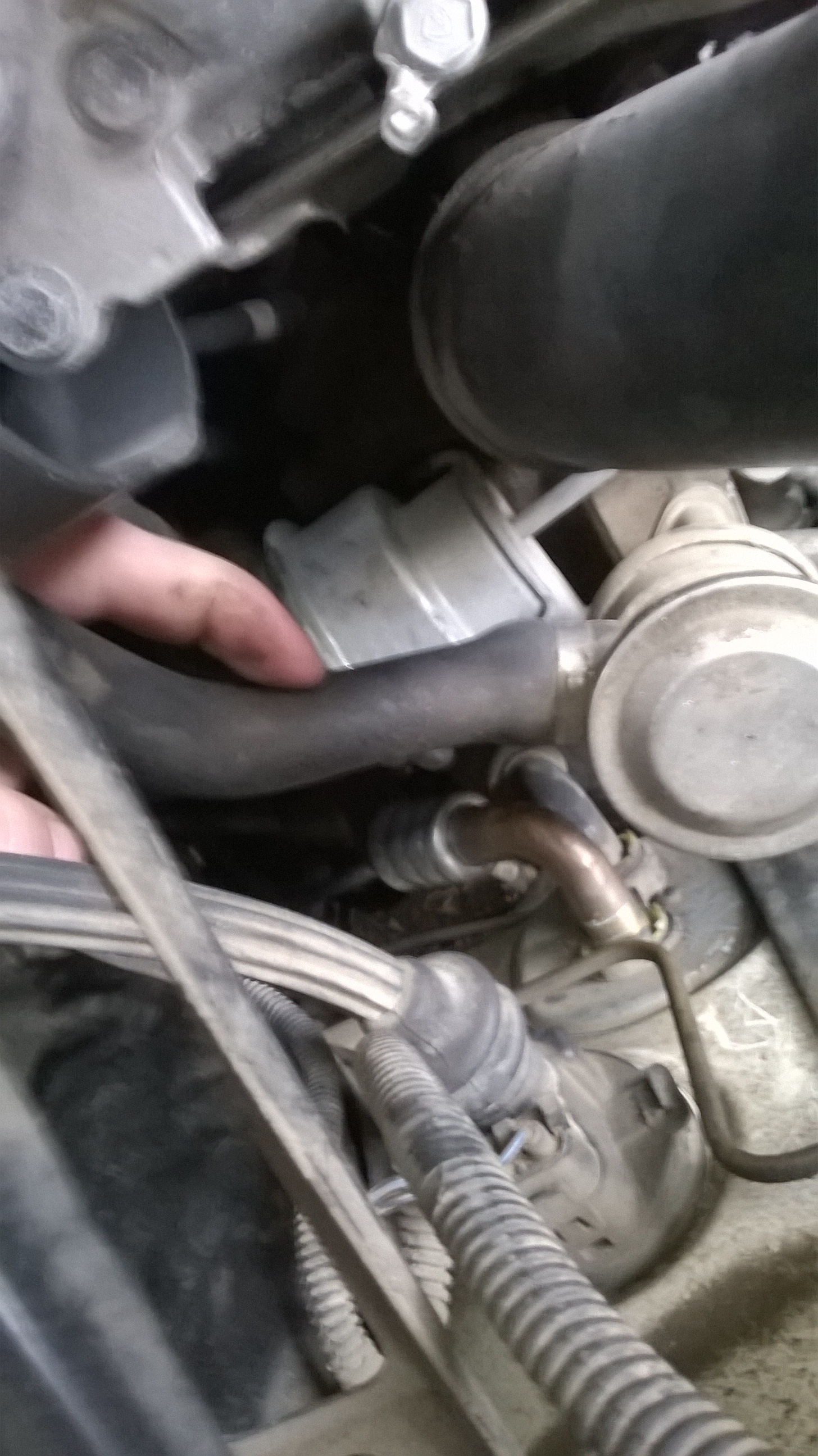

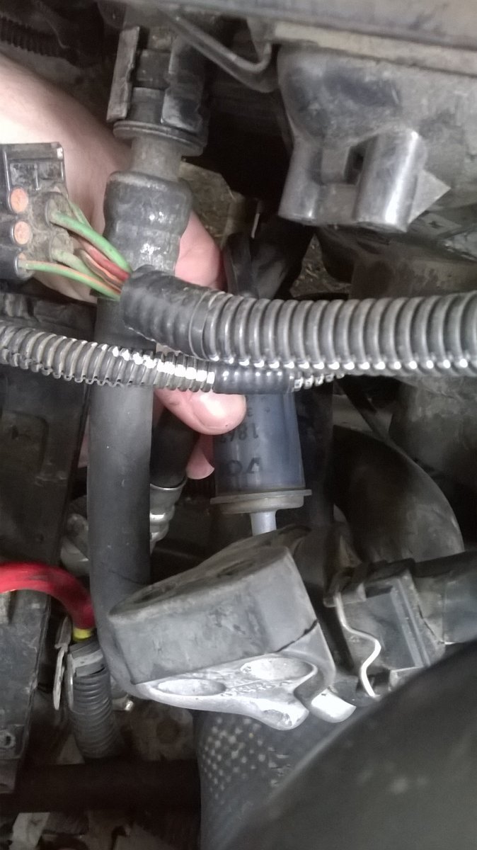

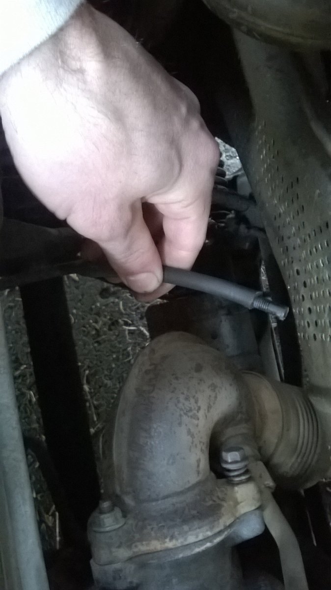

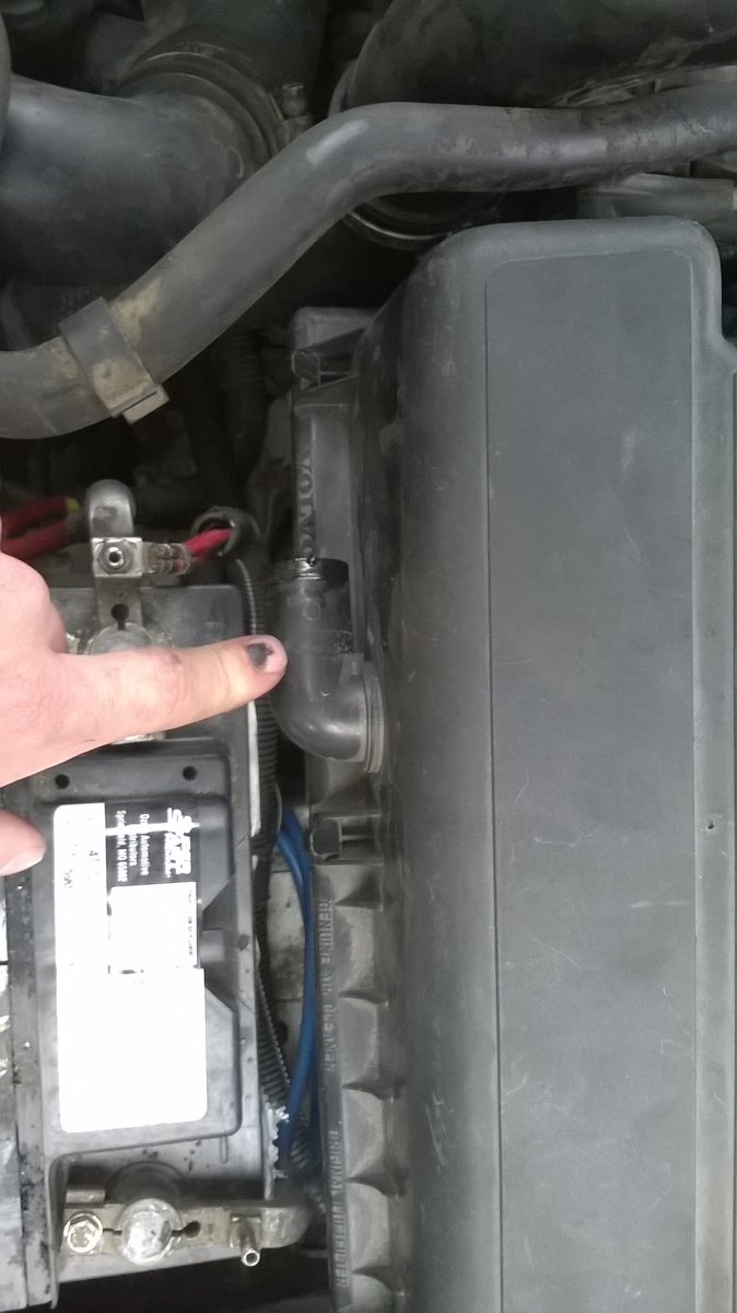

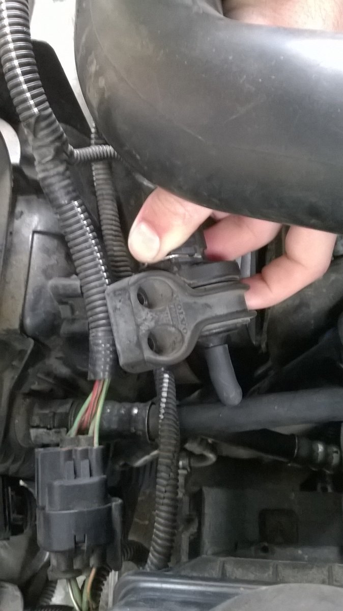

Ok. I am posting the requests for pictures along with all of my other questions for hoses, electrical connectors and what not. hope this helps!

#1 attaches to the vacuum tree area at intake manifold. That is vacuum for the fuel pressure regulator.
#2 attaches to the output of the SAS air pump (under the battery tray)
#3 is the input for the SAS air pump.
#4 ??????????
#5 - attaches to the radiator bracket, you can actually see the mount on the left hand side of your picture. That is the EVAP purge valve, not a pump.
#4 ??????????
