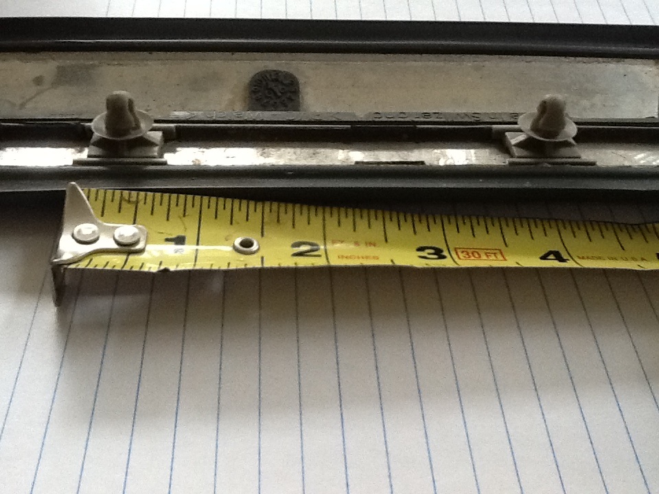

As you may have seen in the picture, the mounting holes for the front left quarter panel molding rusted out, and I lost the molding on the highway.... oddly, my passenger side looks pretty solid. I would like to weld in some new metal and reattach a new piece of molding. However, I do not know (and cannot find any pictures of) what the mounting holes should look like. My idea was to remove the passenger side molding and make a template of the holes... Does anybody know how to remove this piece of molding? It is clearly different than removing the door moldings.

I removed that piece of molding on my '97 855 last summer. I think you have to slide it forwards and then pull it off. I remember I broke one of the clips during removal. I used a little adhesive to hold it in place when I reinstalled it.

here is a picture of the back side of that trim piece.

Glue it.
