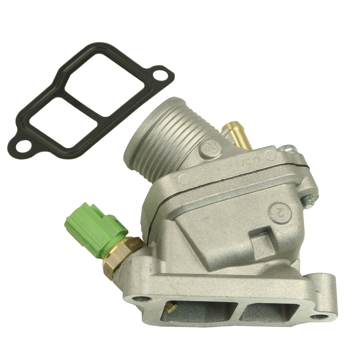

The 2002 had a different (non separated) thermostat which looks like the pic attached or the fitters of your engine swapped the 2001 thermostat and housing to the 2002 engine (same gasket and mating surface). If yours is correct the thermostat housing will have a long lead from the temperature sensor instead of the stumpy temp sensor design pictured.

My thermostat housing looks different than the one pictured.
