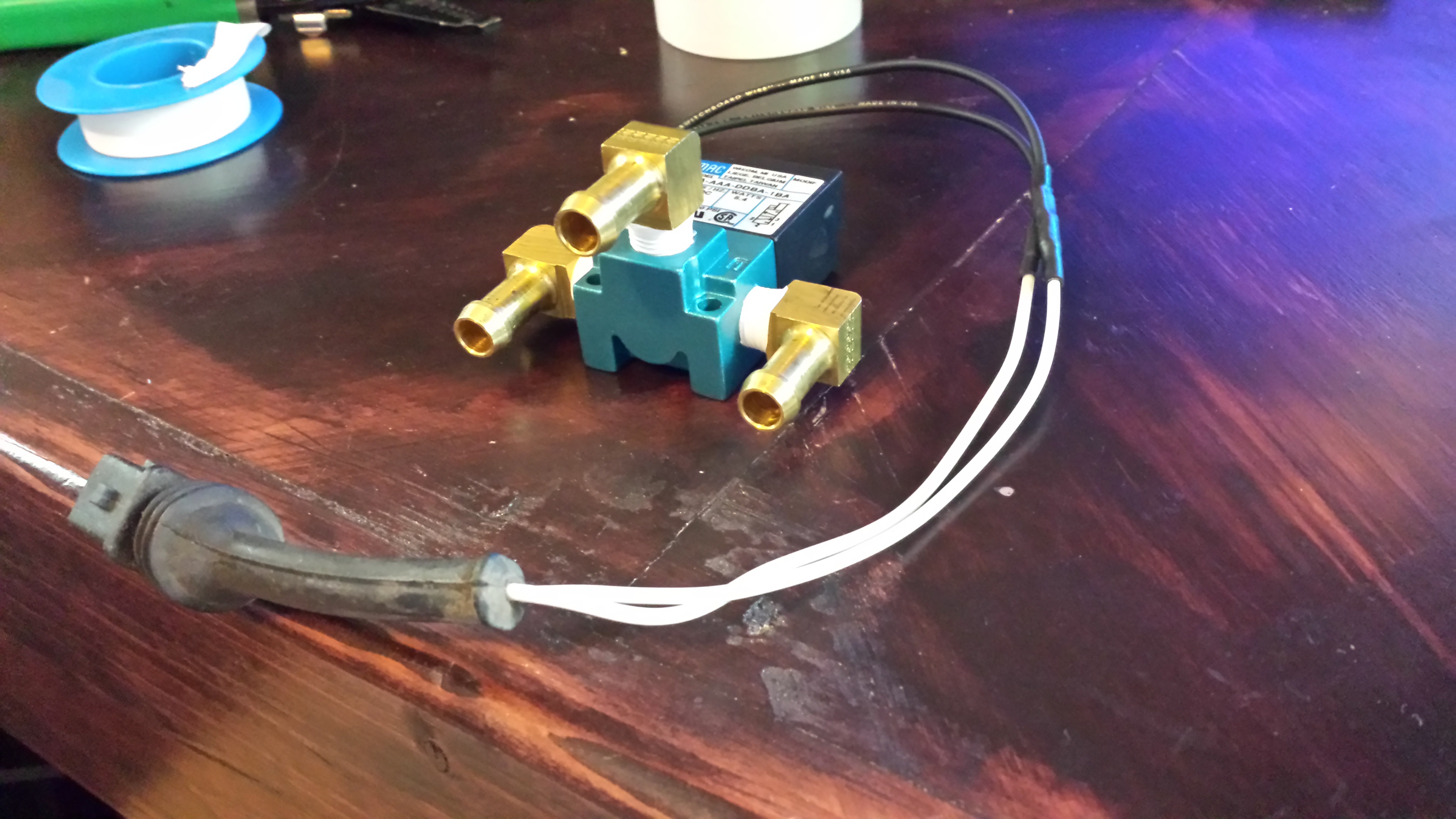

All hail Brett Borders for this info!
Everything

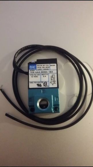

MAC Boost Control Solenoid Valve BCS MAC 35A-AAA-DDBA-1BA
$25.95 New in eBay Motors, Parts & Accessories, Car & Truck Parts
http://www.ebay.com/itm/261433744015?ss ... 1439.l2649
10 Pieces, 1/4" Hose Barb x 1/8 NPT Brass Fittings
http://www.ebay.com/itm/131056710293?ss ... 439.l2649w
$11.00 New in Business & Industrial, Construction, Building Materials & Supplies

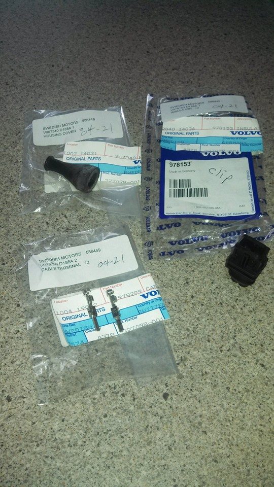

VOLVO PARTS - TERMINALS 978299 X 2 $4
BOOT INSULATOR 967340 $3
PLUG 979153 $4
Also -> Amazon link

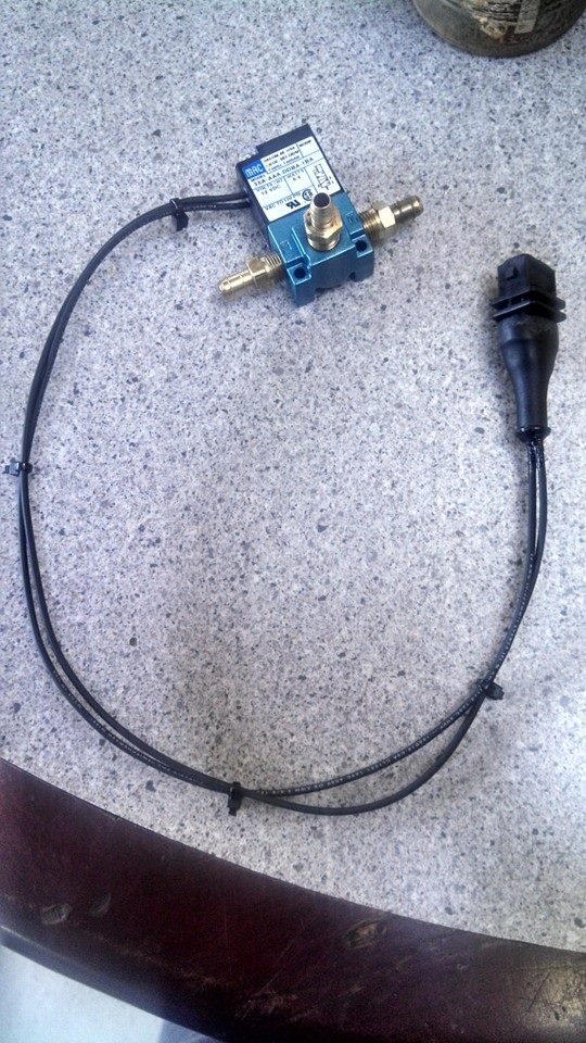

Finally got one of my own build up. Got the connector from a older 240 o2 sensor found up on the firewall on the pass side. Hope to get it installed tomorrow. Crimped the connections and used hot melt heat shrink to make it waterproof.

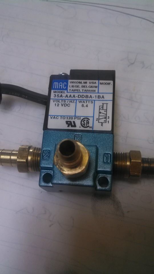

In case anyone is wondering, the hose routing of this model is exactly the opposite of the IPD HD TCV. It should be connected:
Port 2 - compressor
Port 1 - wastegate
Port 3 - fresh air (or block it off like I did)
You will kill your engine if you get them mixed up, so to be safe blow through the sides ports - the side you can blow through should be connected to the compressor, the other side to the wastegate. Basically, without power, the TCV should supply the compressor pressure to the wastegate.

Are you sure about that? I used the same MAC solenoid back in 2010 for a 98 S70 T5 and I used:
Port 1 - fresh air
Port 2 - wastegate
Port 3 - compressor
Here's a Volvospeed thread where a guy used the same solenoid on his 2007 V70r
He appears to be using Port 1 as fresh air(evidenced by the blue dot on the hose)
Here's another URL using the mac solenoid for an internal wastegate turbo
cjep wrote:In case anyone is wondering, the hose routing of this model is exactly the opposite of the IPD HD TCV. It should be connected:
Port 2 - compressor
Port 1 - wastegate
