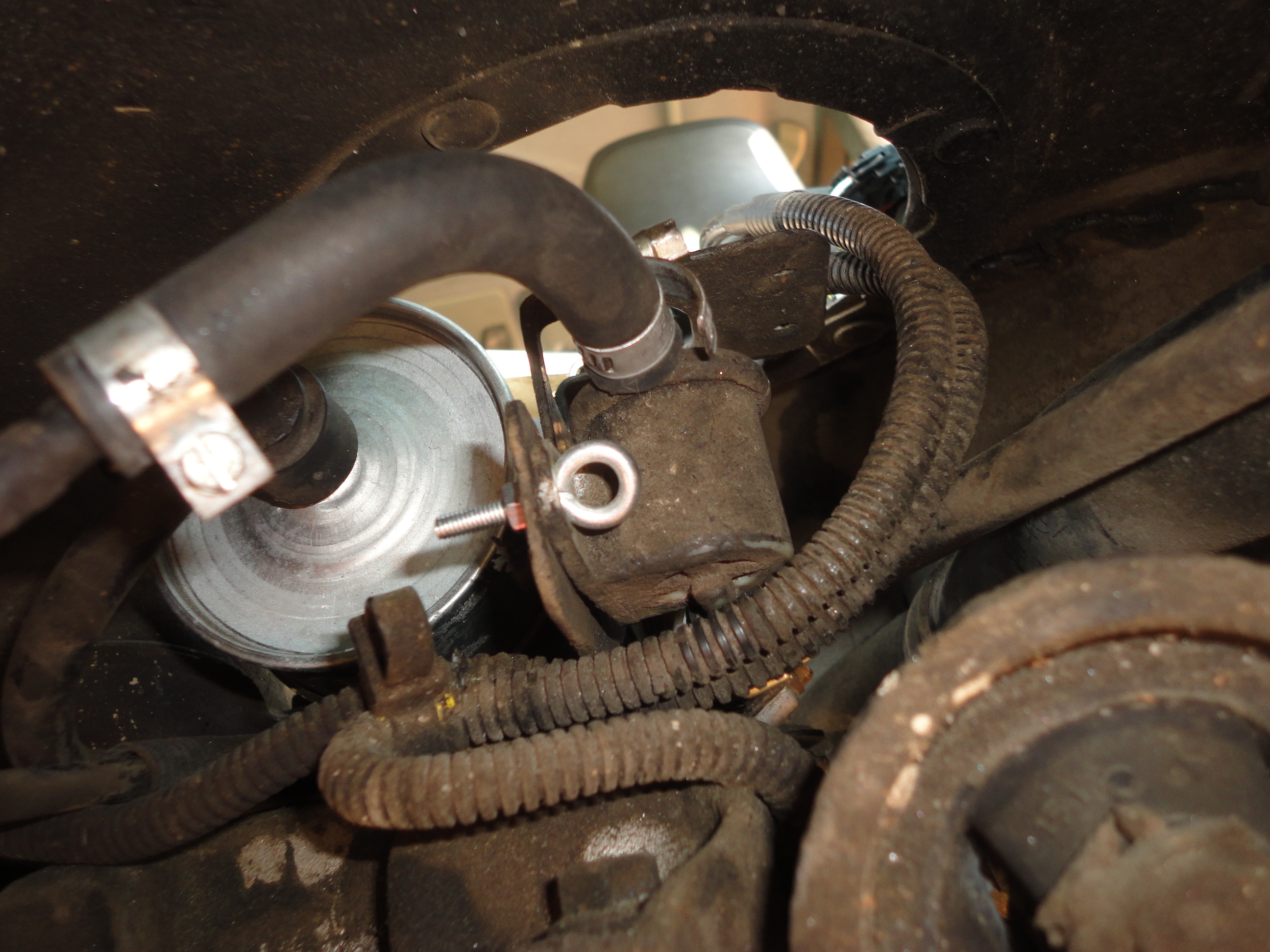

1) I started with the Evap Canister (to the left of the front driver's wheel when looking at the car head on). Use a 10mm wrench to remove the small bolt at the bottom of the canister and drop the canister down. Some folks have talked about removing the fender skirt to gain access, but I didn't find that necessary.

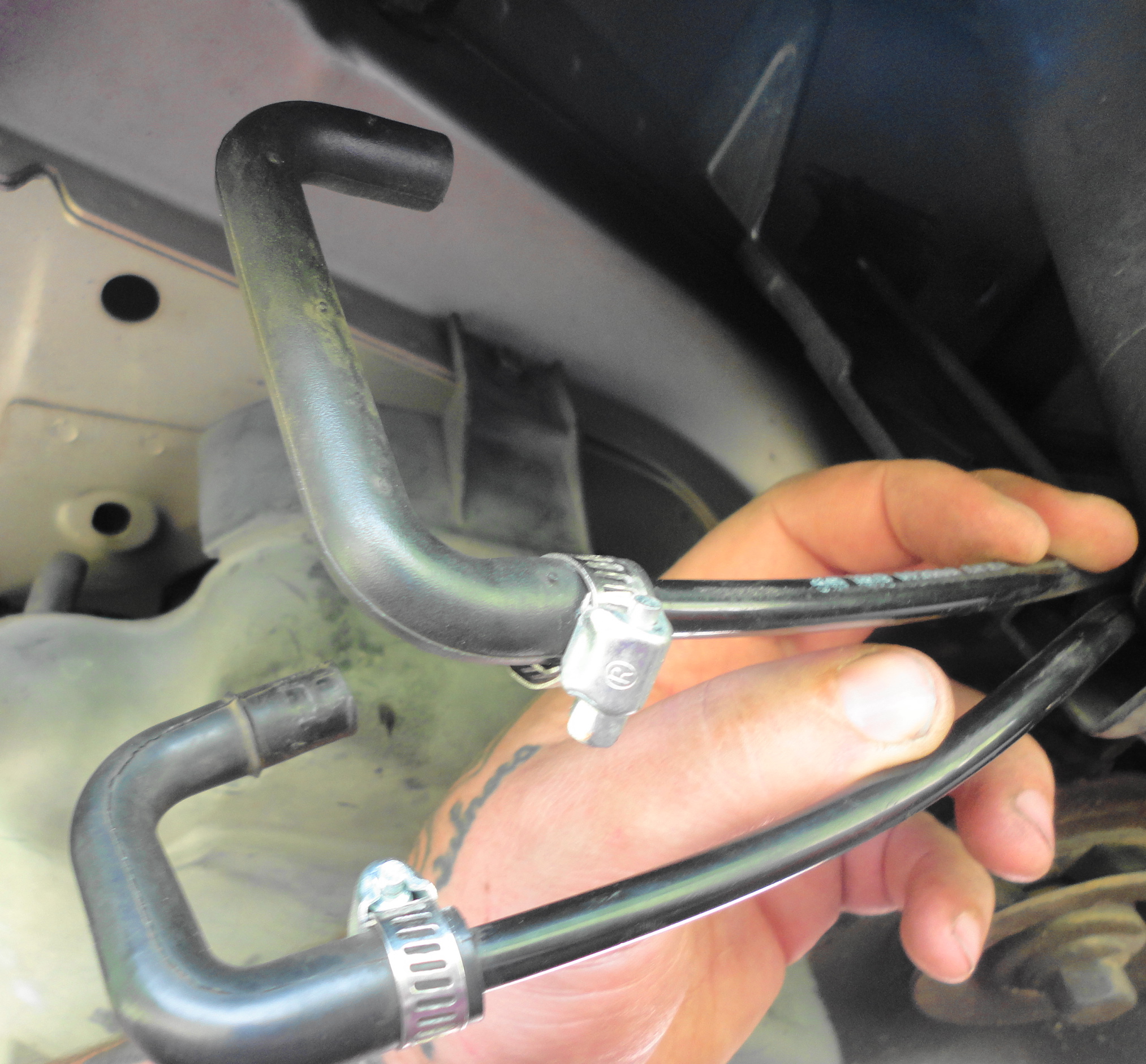

3) I used two molded molded U hoses and hose clamps to connect the lines coming from the tank and the purge valve (hoses #16 and #4).

Two lines going to canister.  The top one was my purge.  The bottom went to the rollover valve.
New U hoses and clamps.

Top of canister.
Top of canister.
Removing canister is one 10mm bolt.

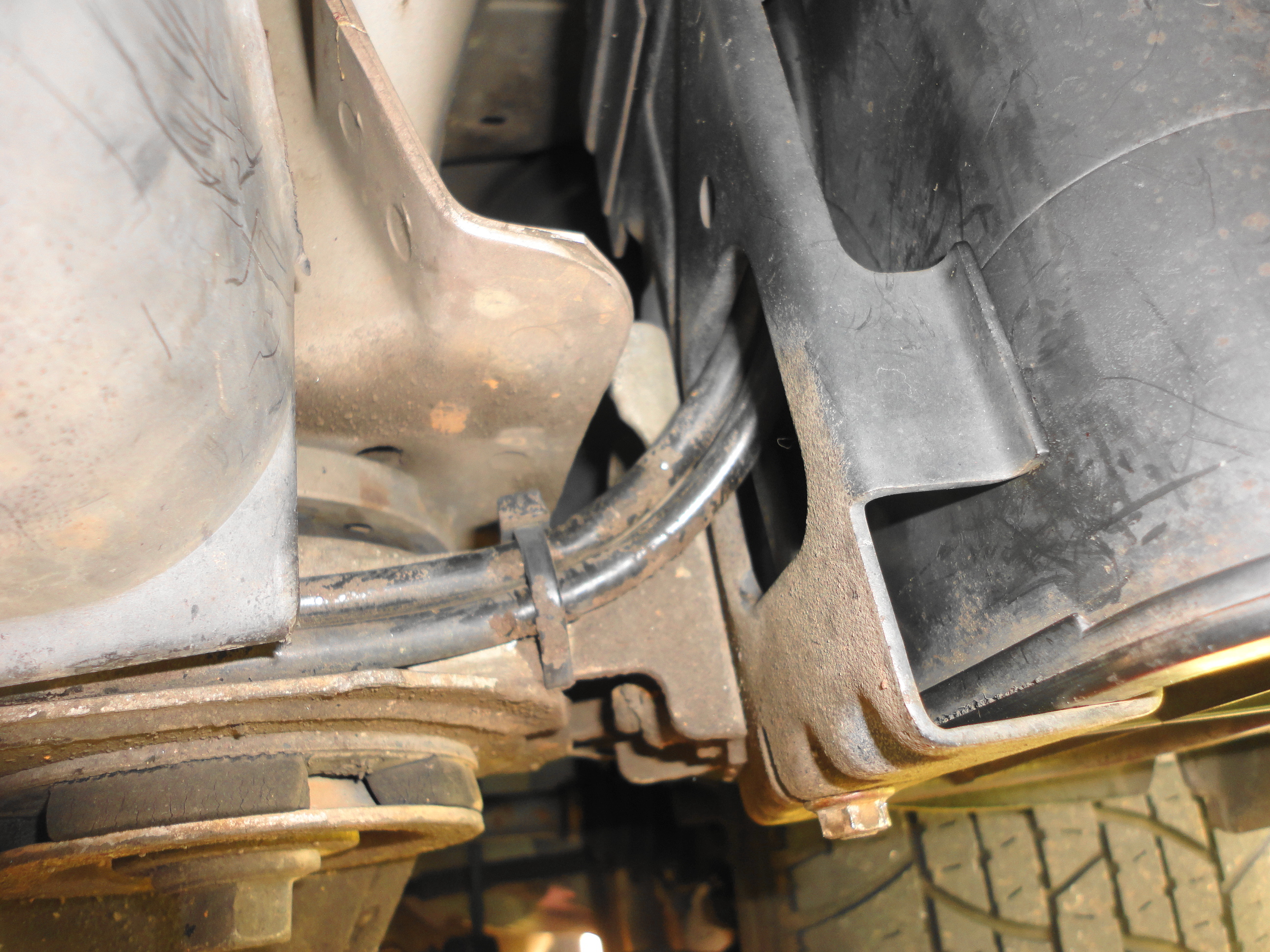

Should have included this in the original write-up so I went ahead and also replaced the hose from the "air" portion of the EVAP canister to the shutoff valve (hose #20 in diagram to valve #18). Used 3/8 heater hose from AZ. To gain access on the V70 it's necessary to remove the bolts and bend back the driver's side fender skirt. Used 3' of hose to run from the shut-off valve over the wheel well and plug into the "air" portion of the canister. Total time around 30 minutes. With the above, this completes the hoses in the EVAP system.
Eric

Peel back the fender skirt and there she is!
Removed wheel to gain access to rear of fender skirt.  Shut-off valve is behind this.
