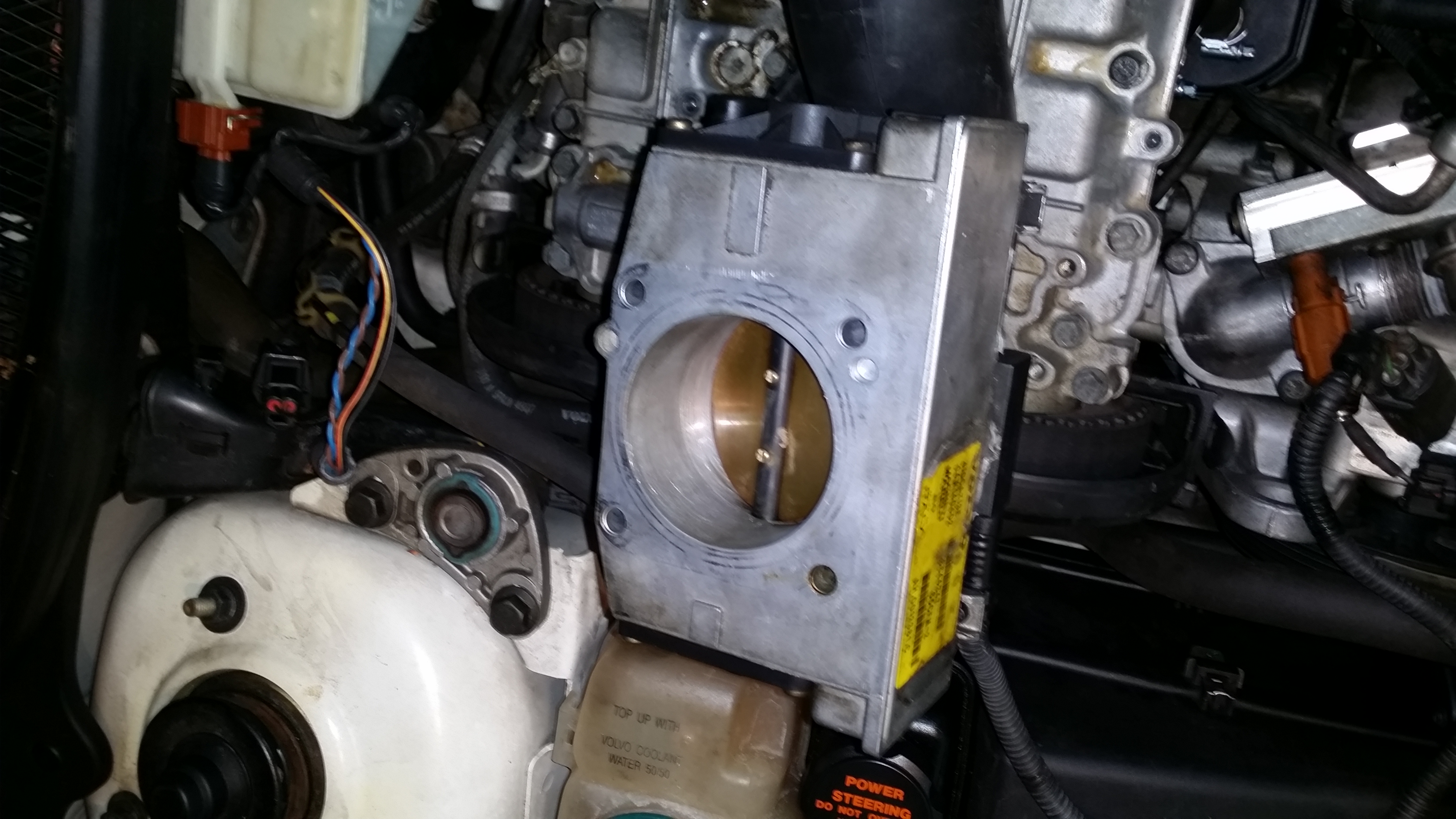

Thanks to the suggestions of the knowledgable folks on this forum I seem to have got this fixed. I figured from the input from this group that it might be caused by one of 3 things:
1 - Turbo (Boost) Control Valve
2 - Fuel Pressure (MAP) Sensor
3 - Throttle Position Sensor/Throttle Body
I put them in this order because that the order of lowest cost (and effort) to highest cost (and effort).
I just installed a new Turbo Control Valve (I purchased a stock one, not the heavy duty version), and lo-and-behold, no more surging/hesitation on the freeway, and now the cruise control works properly. Interestingly enough it did seem to take a the car a little while to get used to the new valve. The first few hard accelerations at higher revs resulted in a pretty loud hissing noise, which I assume was the waste gate venting unexpected pressure. After 15 mins of varied driving it seems to have adjusted itself and I'm not getting the hissing anymore.
I need to drive the car a bit more to verify that this has fixed the issue, but so far so good. If it starts to struggle again once it's fully adjusted to the new valve, then I'll move on the MAP sensor.

Well sadly that wasn't the issue, still hesitating and stumbling a little while cruising on the freeway, and dropping into limp mode under prescribed circumstances in cruise control.
I bought a fuel pressure sensor and started the work, only to find that my particular car doesn't have a fuel pressure sensor. This seems bizarre to me, but anyway. I guess if I really want to take this on I'll have to replace my throttle body now.
