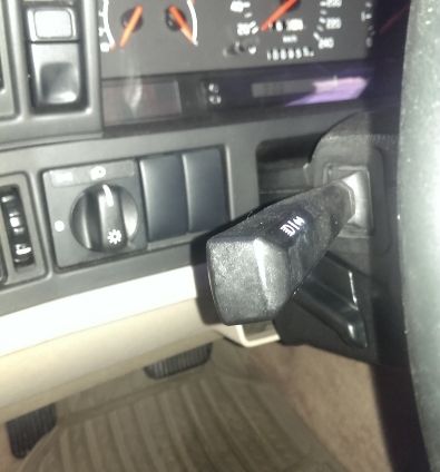

No nothing on the stalk for Cruise

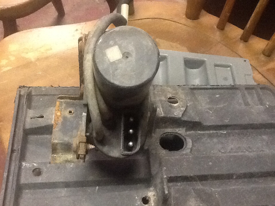

Well at least there are ten, or so vacuum lines you don't have to worry about.
Not to mention the silly little pump mounted directly under your battery tray.
They are fun to use though, when they work. Sorry, in your case, if you don't have it. I also thought all 850s had cruise.

My guess is that at least all of the wiring is there so it wouldn't be all that tough to get the parts from a salvage yard and add it. If this was a country specific deletion it may in fact all be there except the stalk to activate it.

Look under the battery tray for the pump or a three pin plug that goes into the pump. Following the previous posts you should be able to install the components to give your car cruise.
