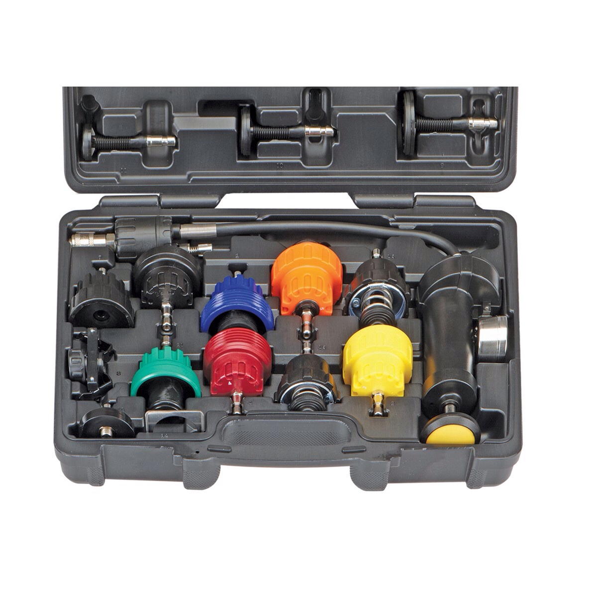

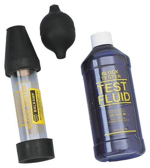

Purchase radiator pressure tester from harbor freight or local auto parts store to determine leak or air in system. To test the head gasket, purchase a block tester from napa auto parts. Instructions on how to test block is on youtube. Here the items you are looking for

- image.jpg (47.56 KiB) Viewed 3620 times
- image.jpg (259.36 KiB) Viewed 3620 times

Definitely need to pressure test. These cars need substantial pressure in the cooling system to stop coolant from boiling.
