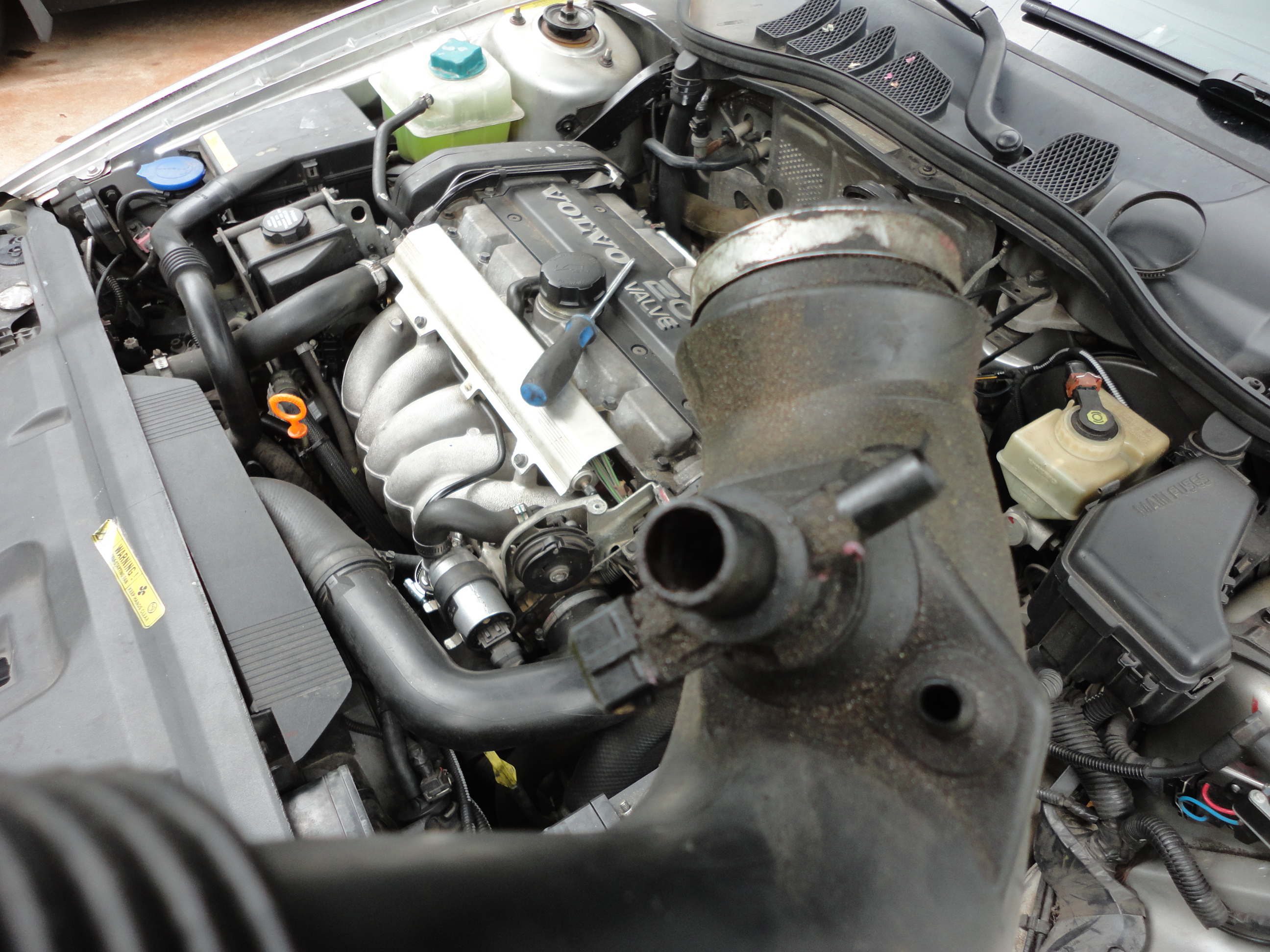

2. Remove MAF sensor connection, smog pump hose, and upper hose clamp from turbo air pipe (see photos).
3. Remove air box from engine compartment.

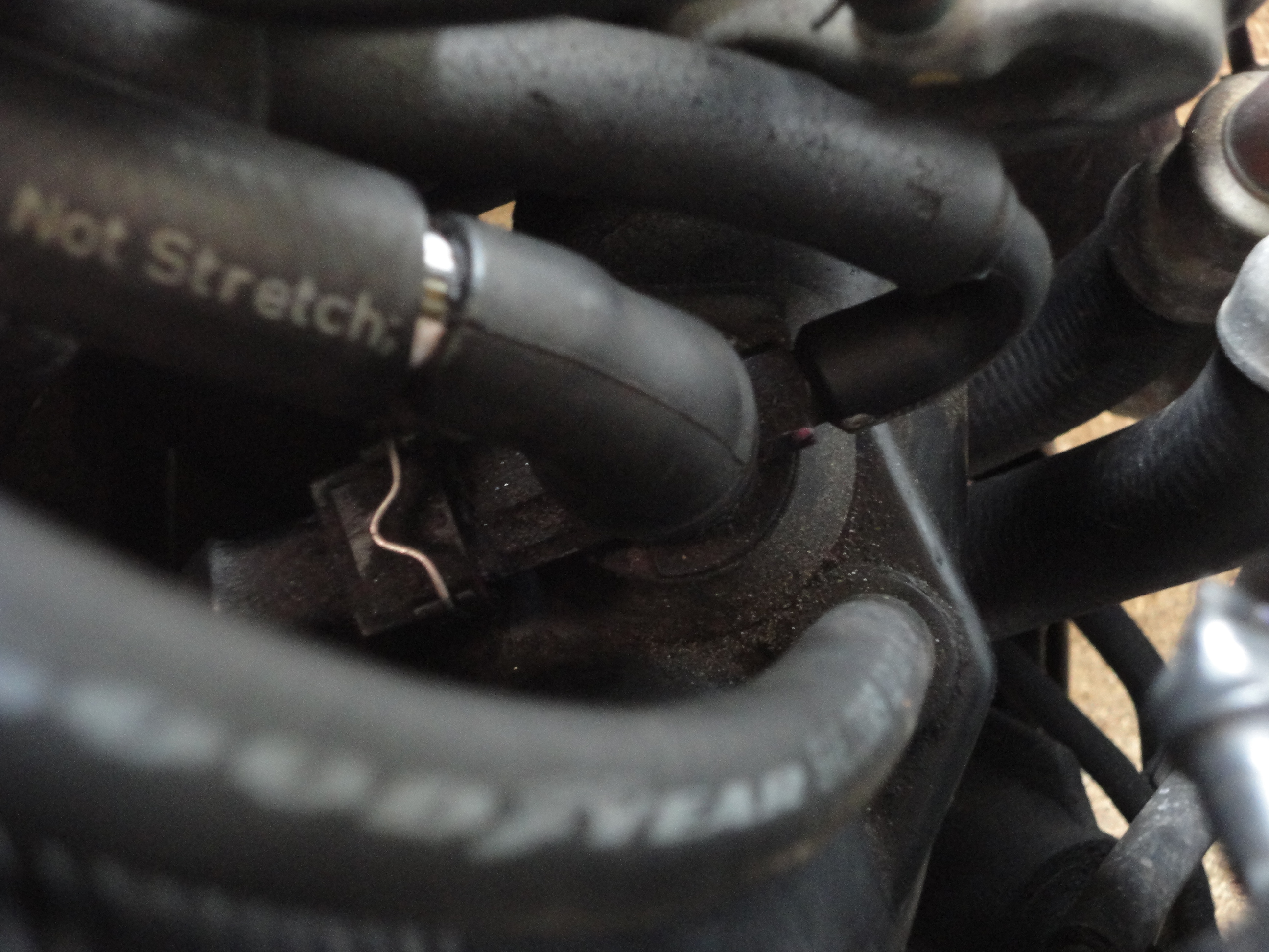

4. Disconnect vacuum lines from upper half of turbo air pipe (2 lines, one on side and underneath) and from lower pipe at PTC Nipple (3 vacuum lines and an electrical connector...see photos).

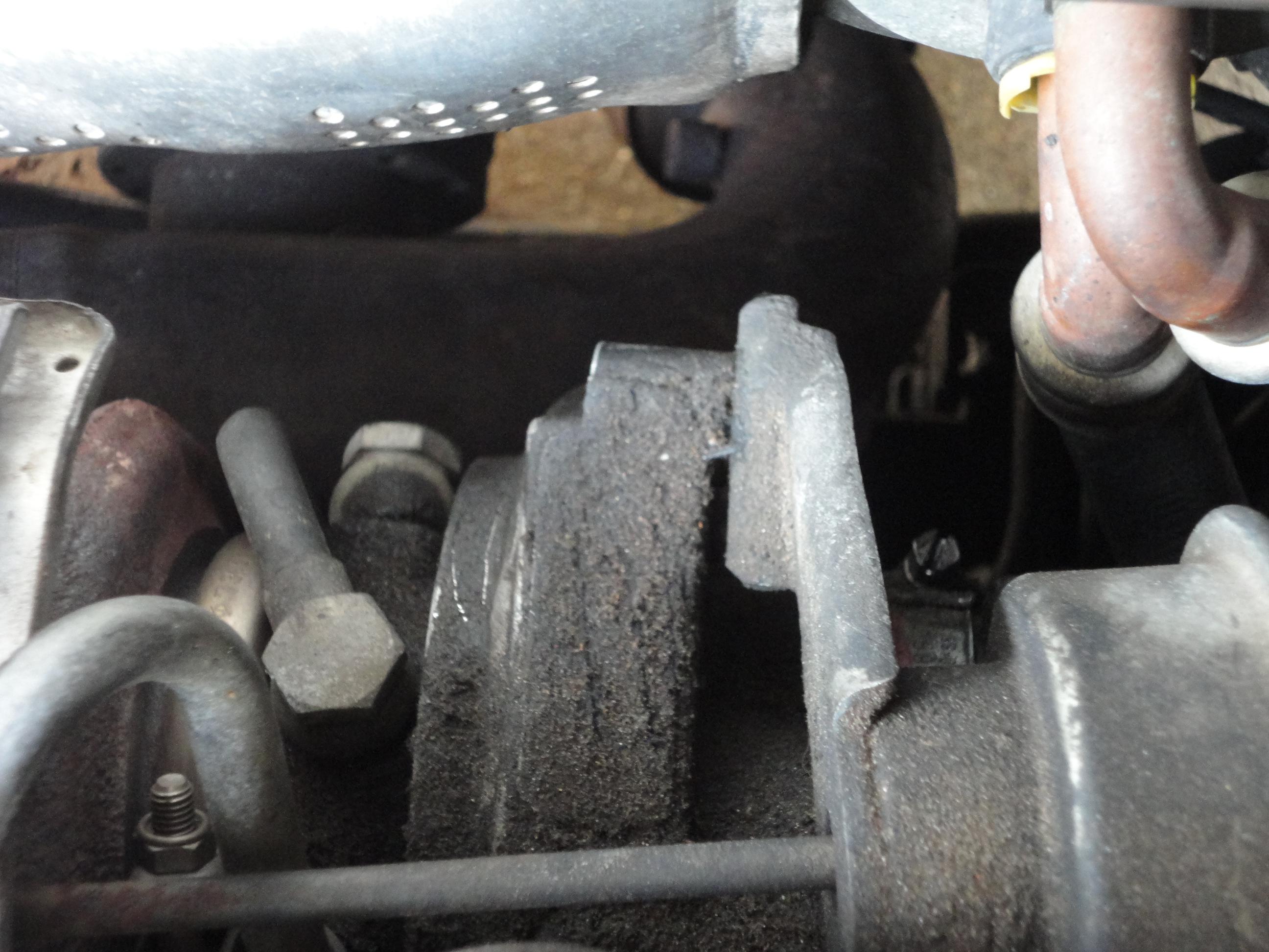

5. Remove hose clamp that holds turbo air pipe to turbo. This is largely a "by feel" clamp and is difficult to see (see photo).
6. Remove turbo air pipe.

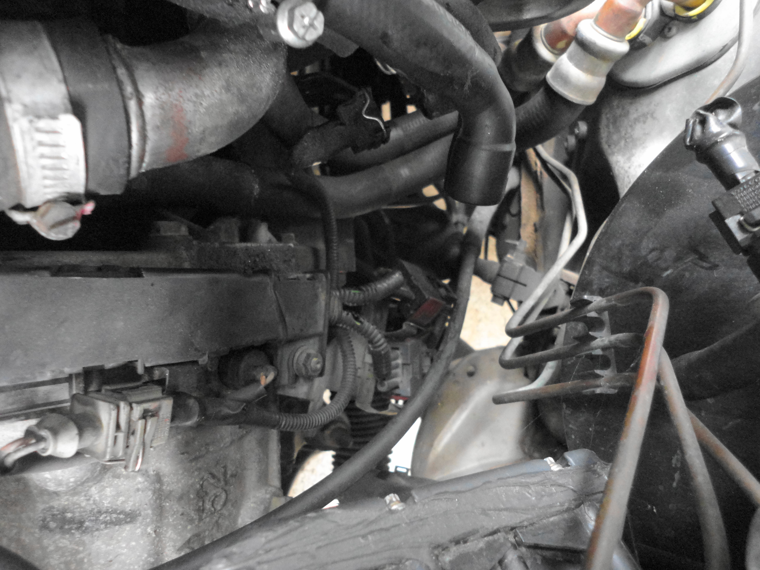

7. The upper and lower O2 sensor connectors are now visible. The red tab is a locking mechanism and must be slid out before connector can be removed.

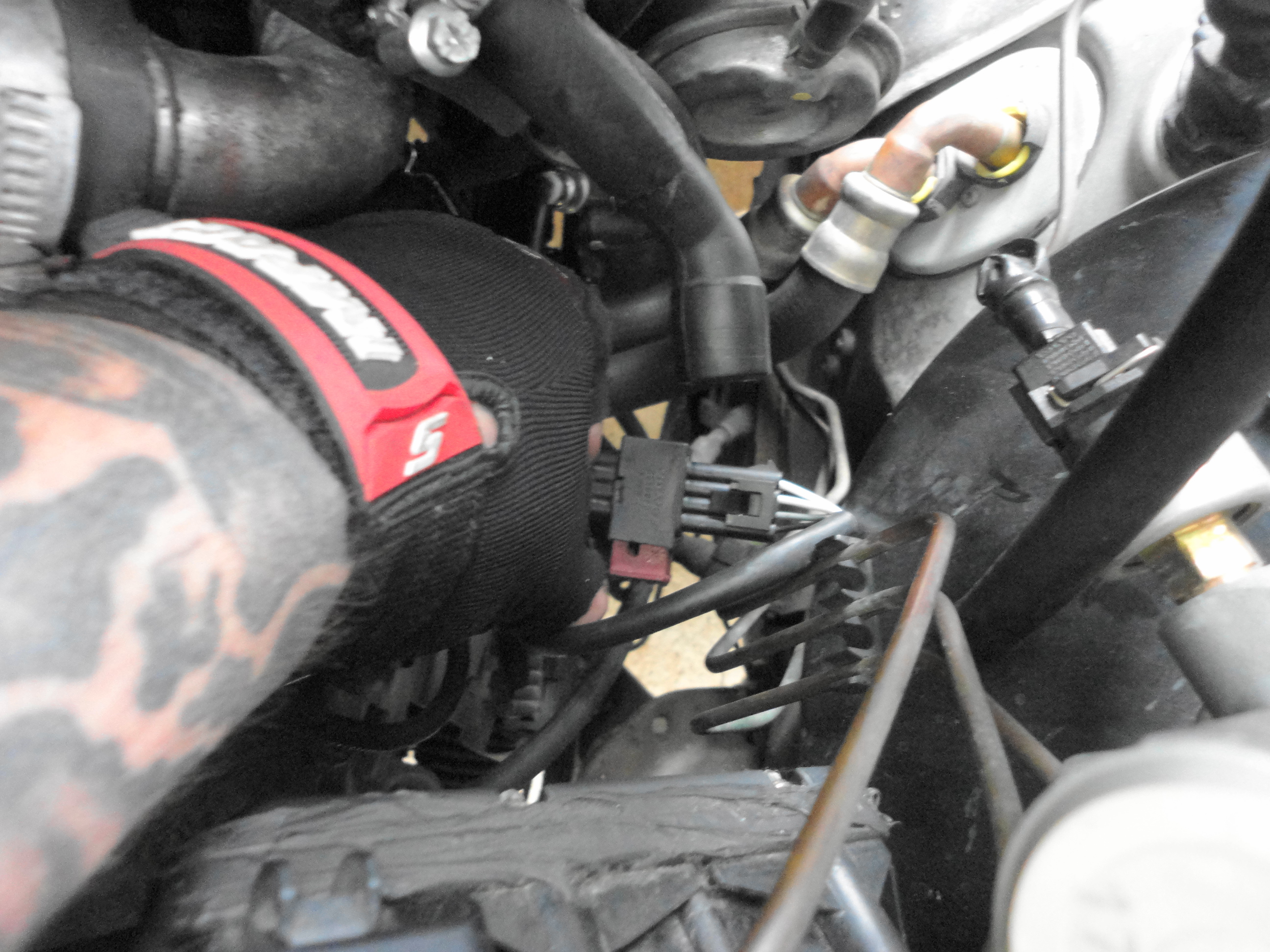

Breaking old sensor loose.

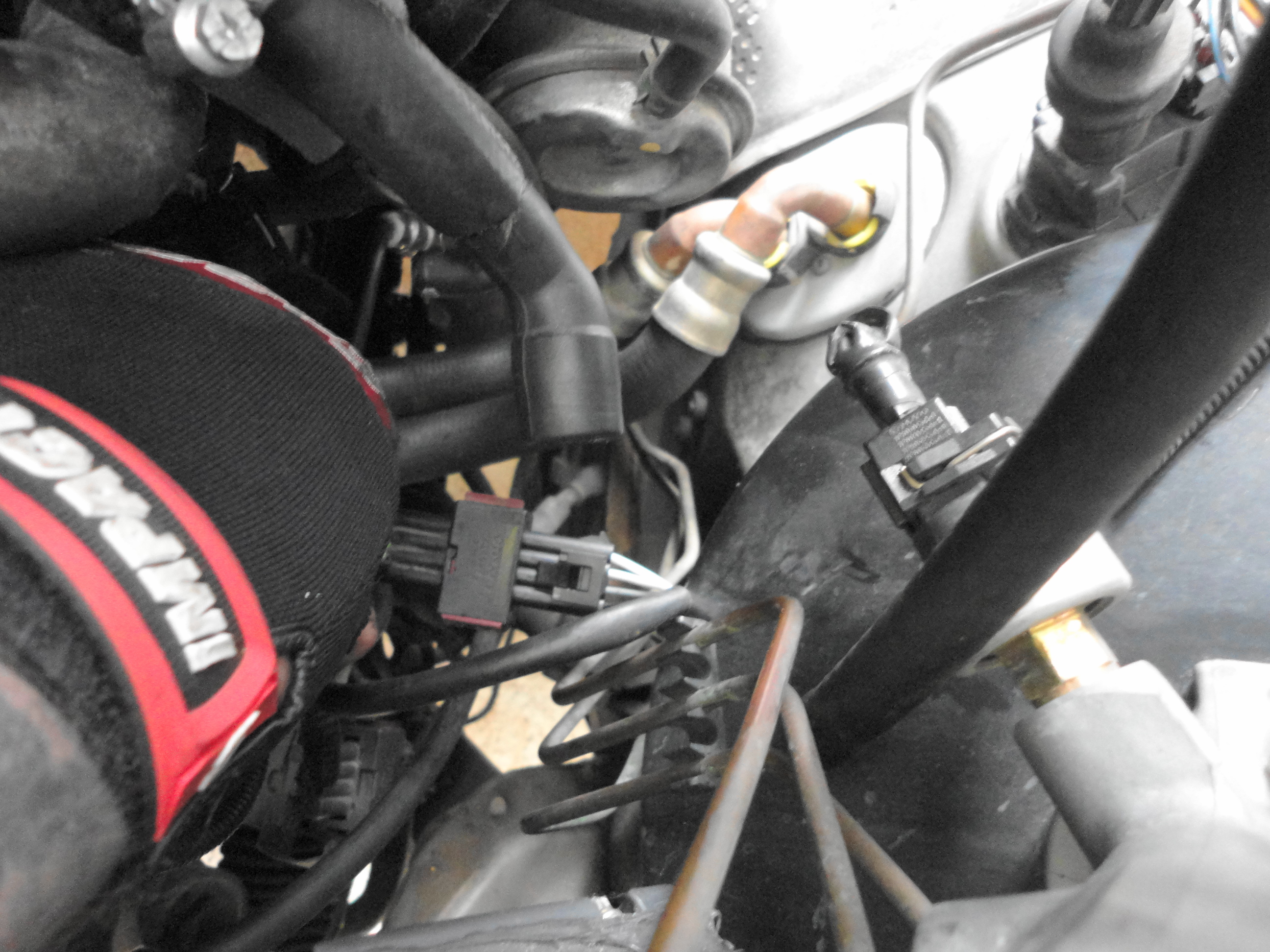

Tab slides out for removal.
Connector with lock tab.
Front sensor in metal clip on left.
With turbo pipe removed O2 sensor connections are visible.
PTC Nipple on air pipe has three vacuum connections and an electrical connection.
PTC Nipple connections.

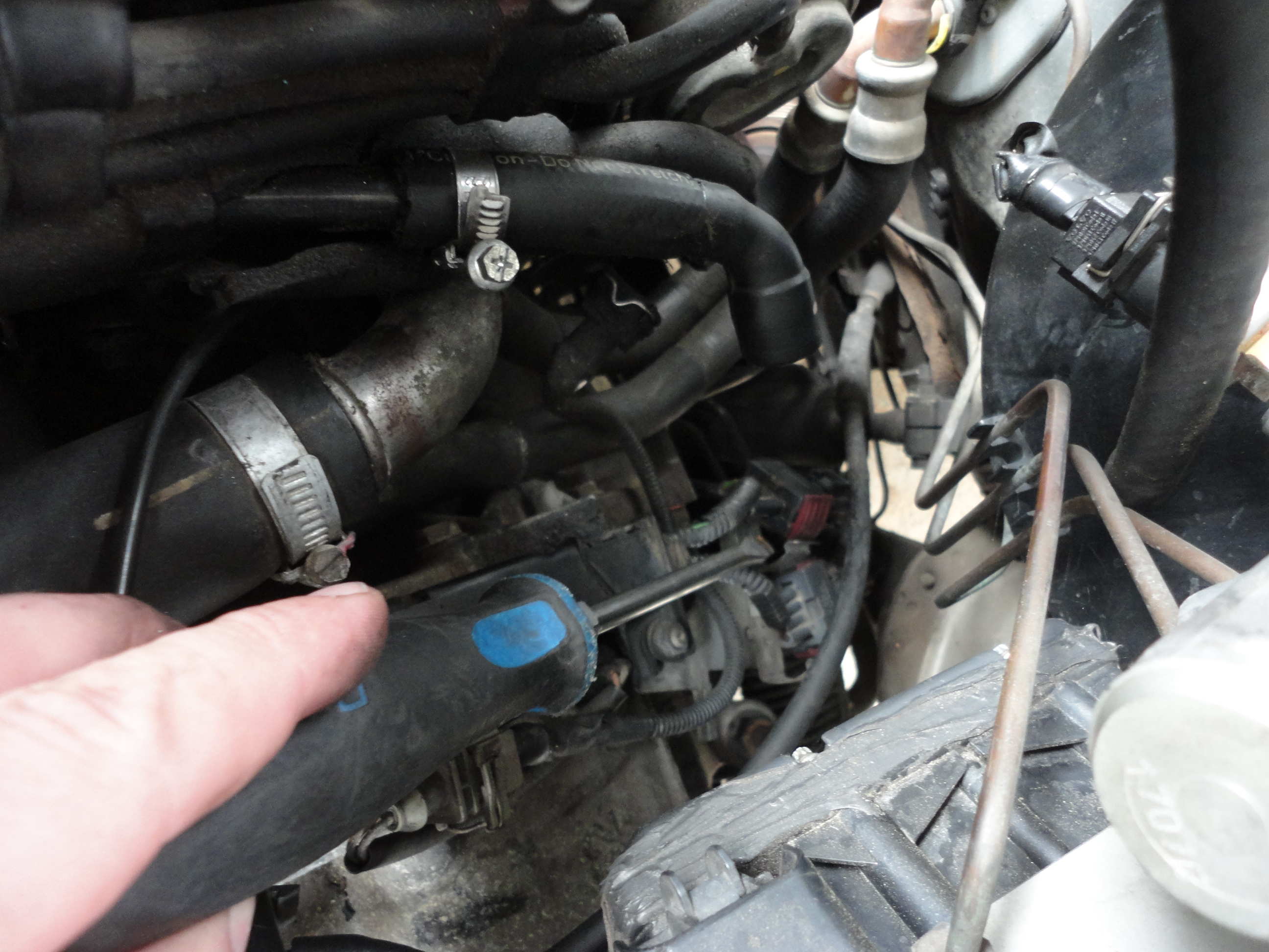

Hose clamp at turbo barely visible below heater lines.

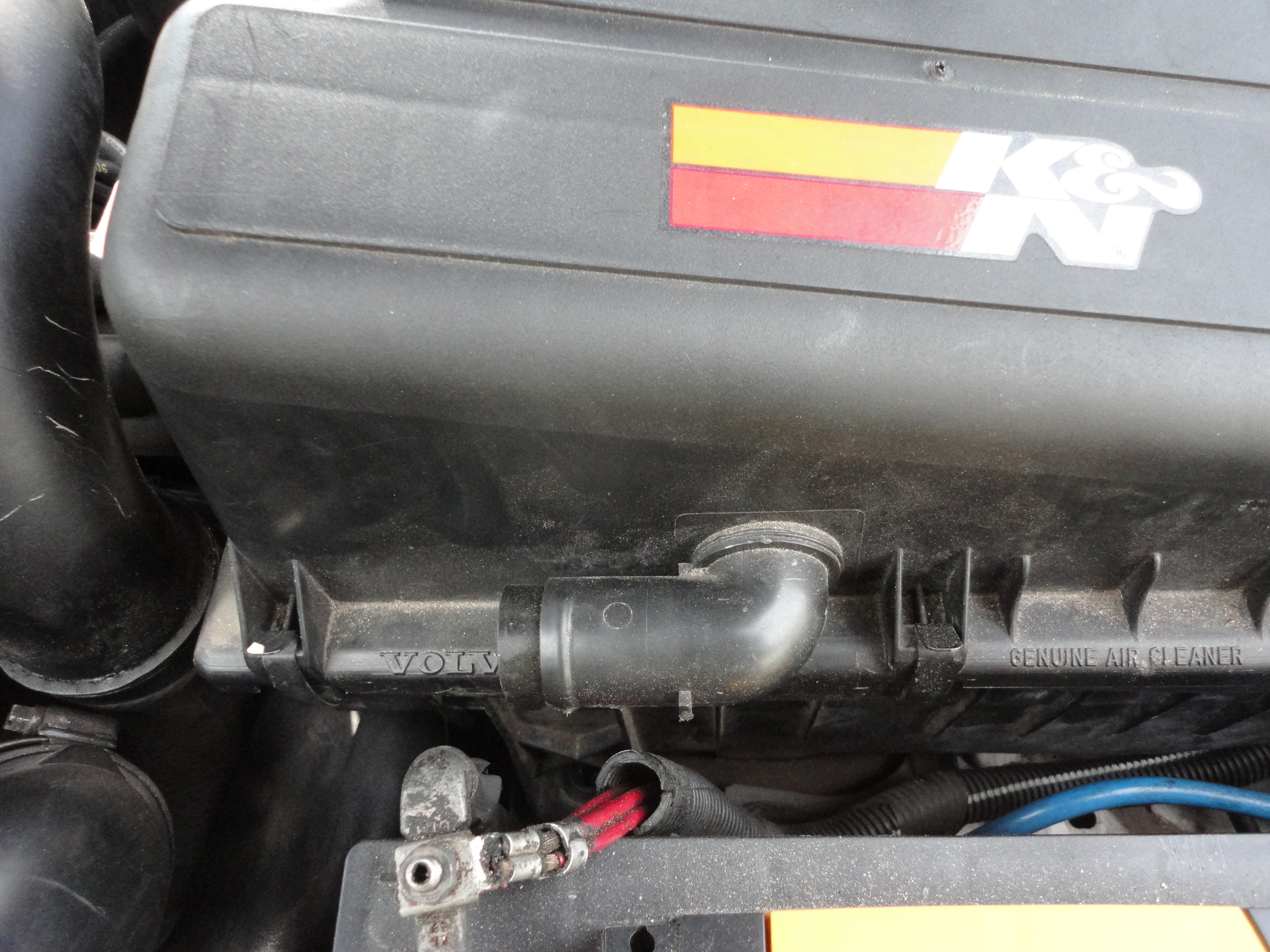

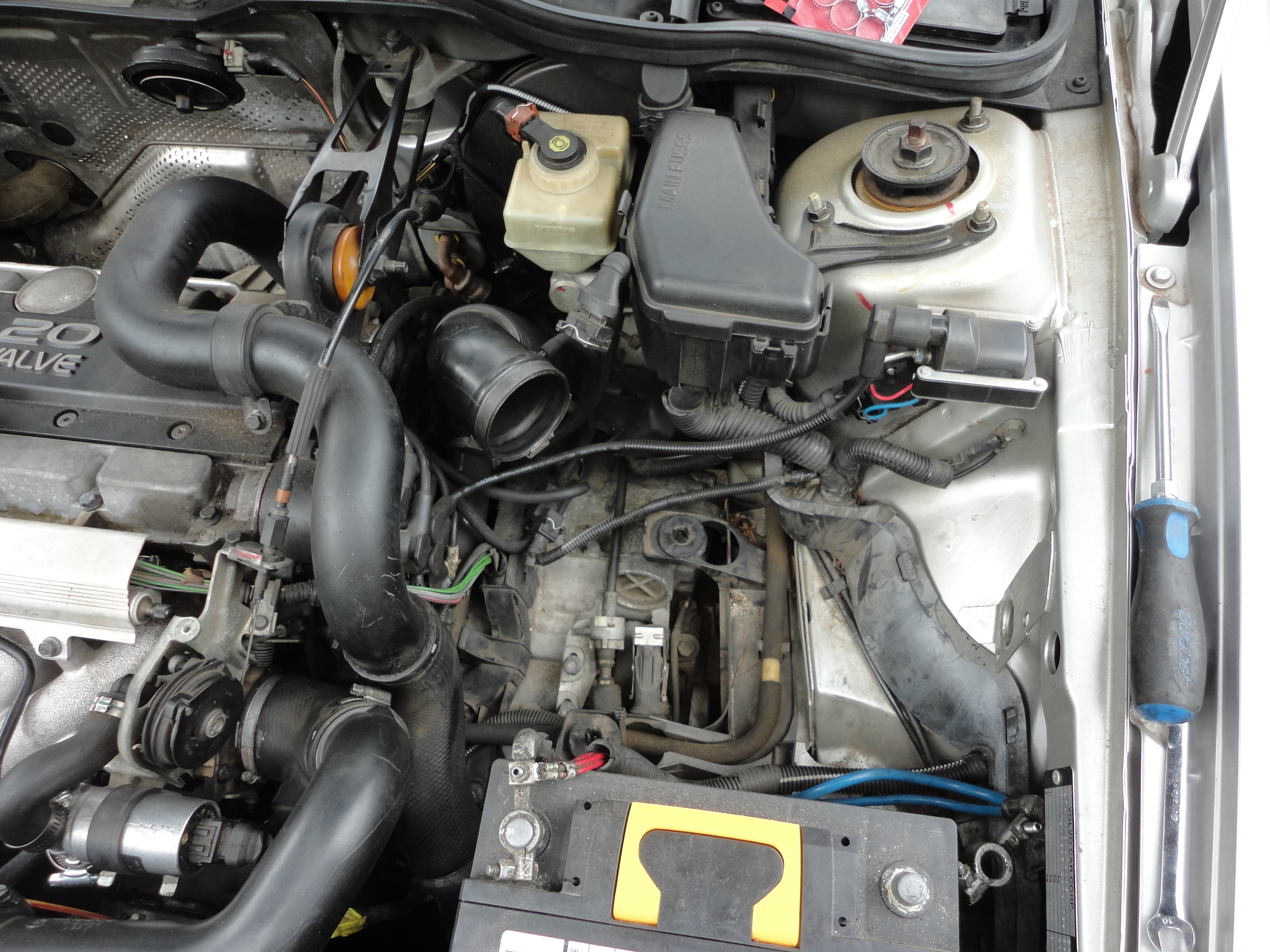

Air box removed.
Air box removed.

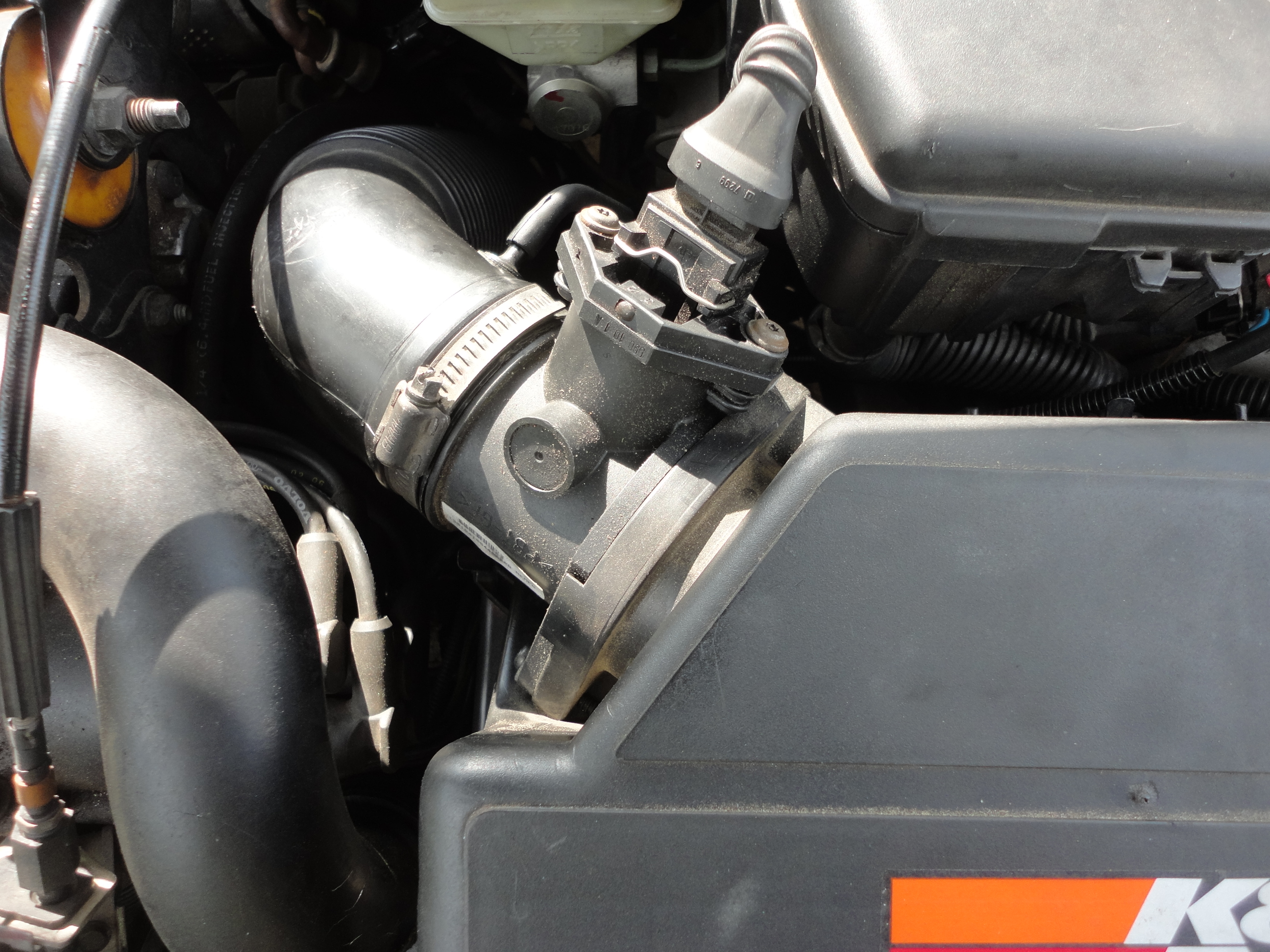

Disconnect MAF sensor and upper hose clamp.

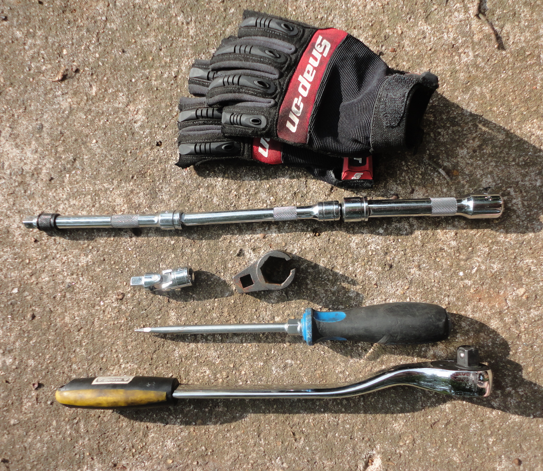

Tools needed.
Tools needed.
