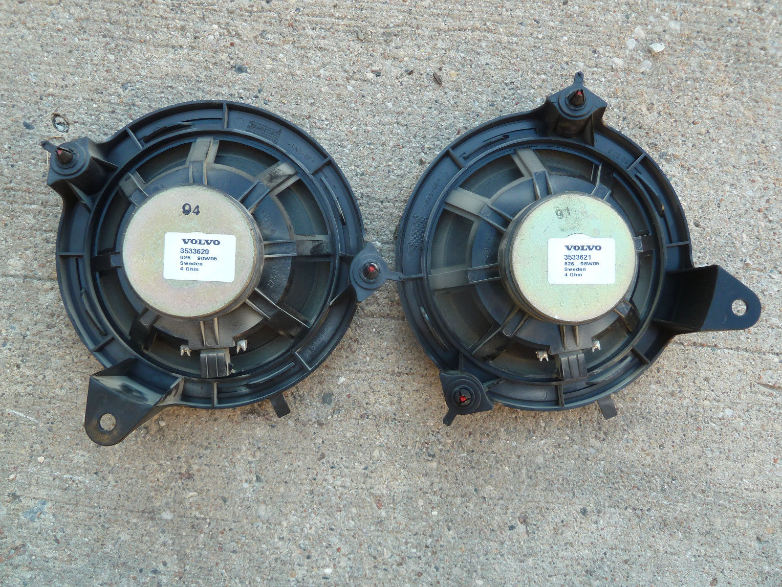

I just used the factory shells to hold the new speakers and soldered the wires from the new speakers to the terminals inside of the shell for the front speakers. The factory plug goes back just like it did on the original speakers. I never changed the speakers on my '99s but that is how I did it on my '98 and I think it is all the same.
On the rear doors that doesn't work so I wound up splicing into the harness.

I'm running into the same problem with my 1998.
Both the front and rear speakers were (as of September 2018) unavailable from Volvo (list price >$100, each).
The rear door speakers look easy enough -- the terminals are part of the speaker mounting frame, which I would want to re-use with aftermarket replacement speakers.
However, on the front door speakers, the terminals appear to be part of the speaker itself, and not the frame that the speaker is glued to, requiring either an adapter subharness or splicing the standard aftermarket speaker wires into the Volvo wiring.
It looks like adapters that are said to work are available on fleabay -- but from the UK. (Glancing at some of the shipping charges, I'm not sure that they really want to sell to the US.)
Has anyone found adapters that will work that are available in the US? I'd prefer not to cut into the car's speaker wiring harness but the 21-year old speakers are failing and driving me nuts.
(PN 3533621 and 3533620 front door speakers)
