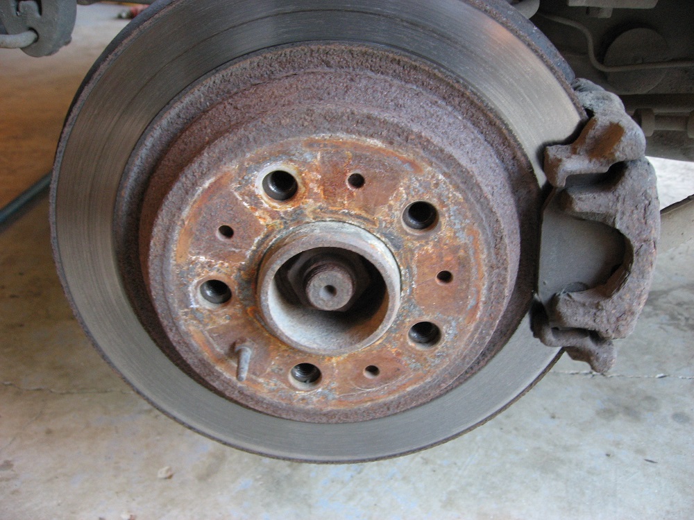

Am I missing something here? Trying to adjust my parking brake at the drums and there doesn't appear to be an access hole to adjust the star wheel for the parking brake pads???
At first I thought that a previous owner installed front rotors on the rear but the drum area of the rotor is there which is not on the front? How the hell do I adjust the parking brake??? Thanks for any insight.

You have to do it through one of the lug bolt holes. Shine a light in there and you'll see the star wheel.

rmmagow wrote:You have to do it through one of the lug bolt holes. Shine a light in there and you'll see the star wheel.
I thought that as well, flashlight and rotated the rotor, never saw the star wheel???

Look carefully at about the 1130 position for the star wheel, looking "up" a bit through the lug bolt hole

Thanks guys, I will have another careful look through the lug bolt hole, wonder why there is not just a plan access hole like most other vehicles and it appears, according to shop manuals, some Volvos....?
