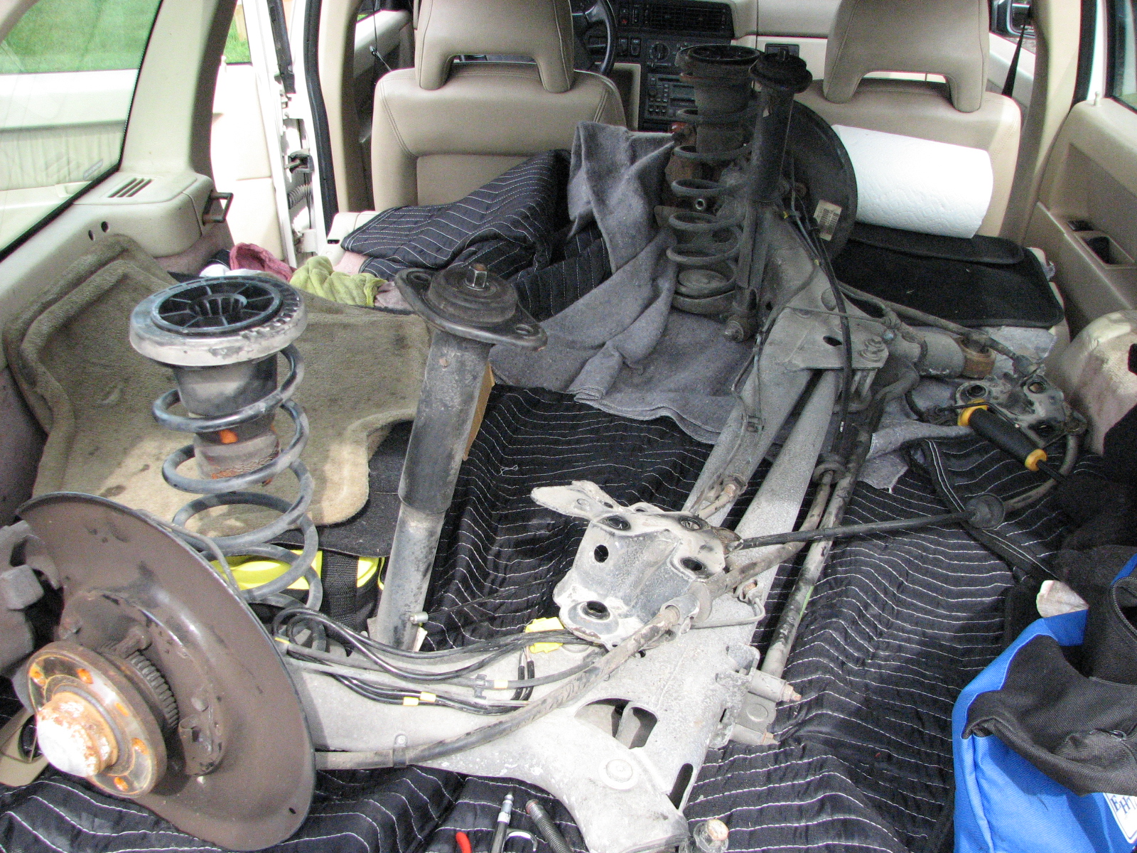

It's a coincidence, I had just done this one last week.
Rear suspension for FWD car, complete was $53.60, plus $6.00 core.
I could not believe what I read on their price chart the week I found an extremely low mileage '98 S70 N/A.
I had taken the Intake manifold for 3" turbo conversion for the T-5R, and the rear disks and pads which were zinc coated and looked almost new.
Long story short, I went back to get the whole rear suspension for the '93 Sedan which also makes it 5-lug as opposed to the 4-lug '93.
I cut the single metal brake line before the Y to the calipers. Kept the calipers attached. Unhooked the wheel sensors at their connectors above the fuel tank and kept them attached.
Disconnected the emergency cables at the handle and pulled them through the floor.
Un bolted the shock mounts from inside the car to leave the shocks as part of the "complete" rear suspension.
Un bolted the three mount bolts at each side. Put a used tire under each side, took out the large bolt through both bushings.
A subtle jerk with a pry bar at each end and done.
Once again, unbelievable. Less than $60.00.
I am going back for the struts and front hubs all in one piece to finish the 5-lug upgrade for the '93 Sedan.
Also, two Antila rims with Michelins that were frozen on the front rotors. $40.00 each.
It was a good picking day.
