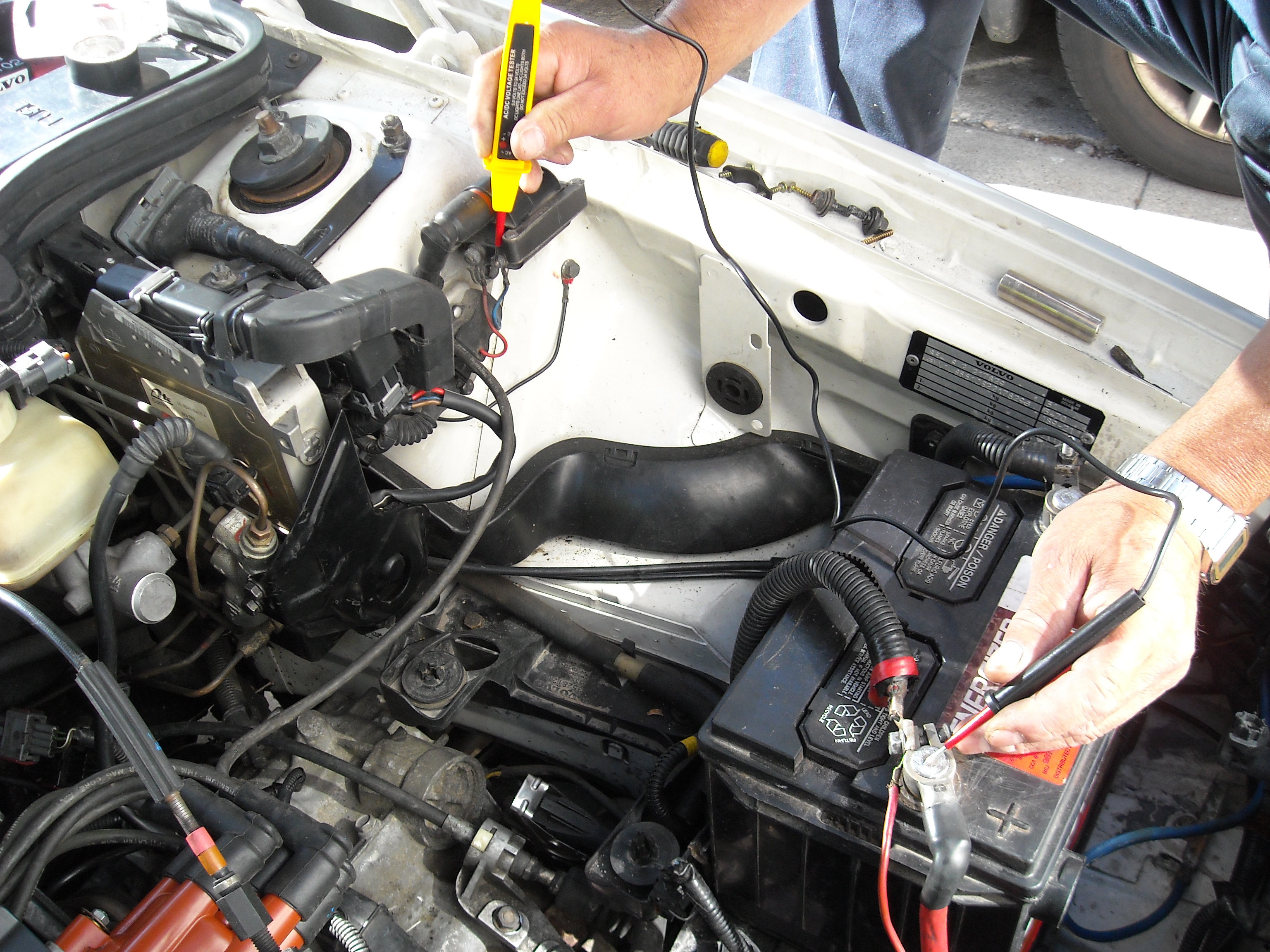

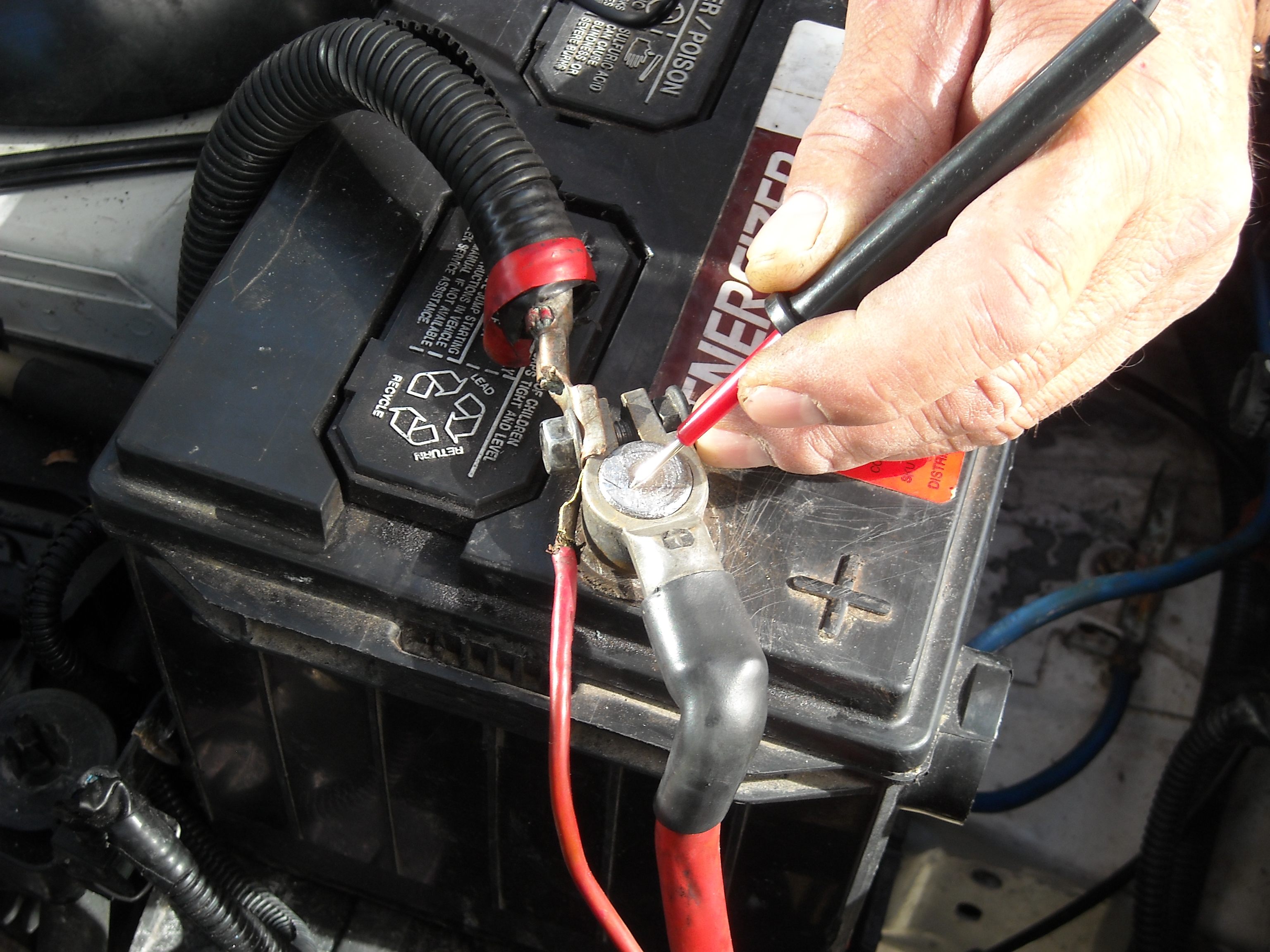

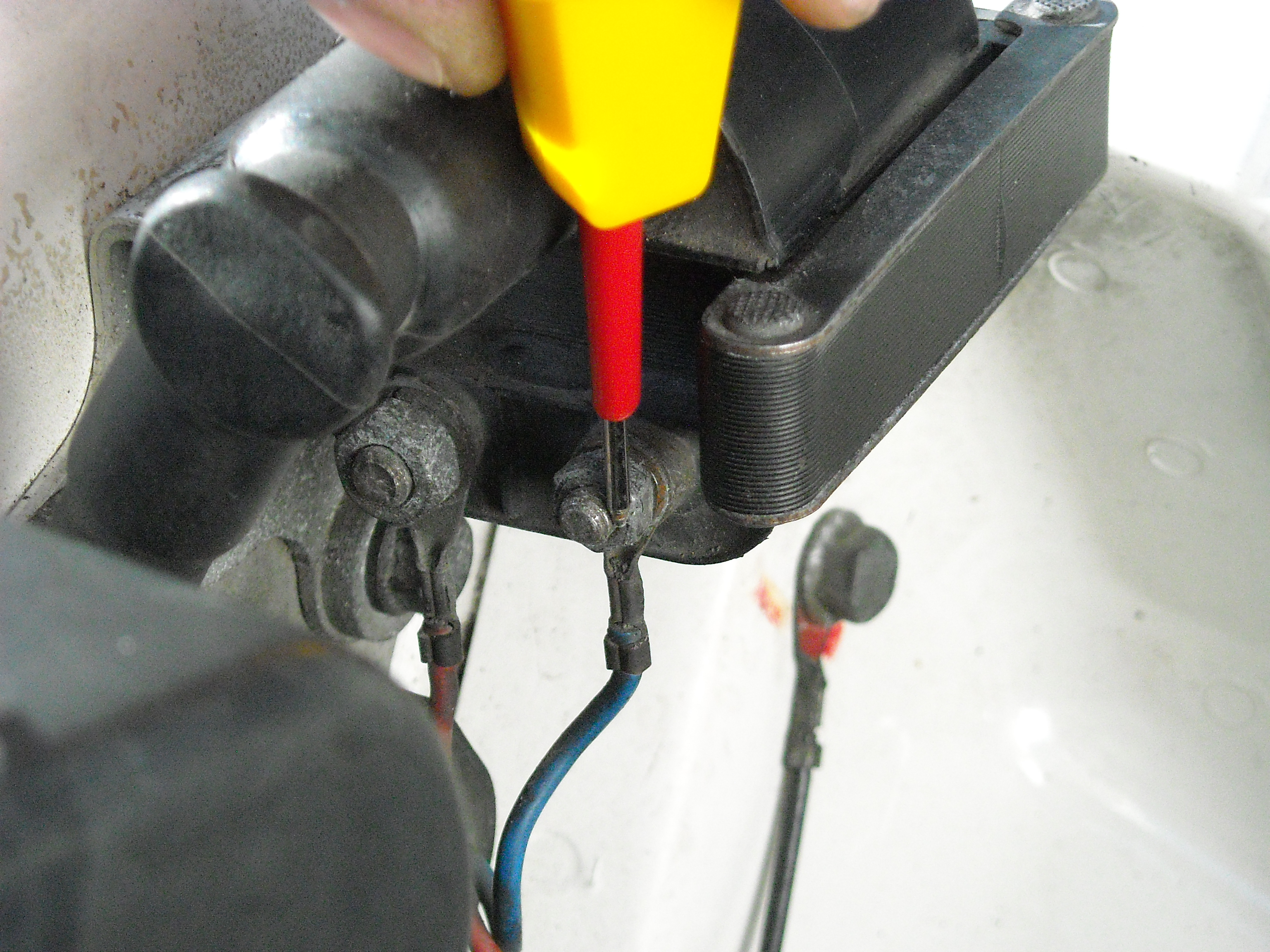

Used a test light to check the pulse
What I found:
Battery is hooked up/ connected and when I tested it while the car was off I had a solid light no pulse when I had my friend turn the key the light went away and I had no pulse, as soon as he took the key out i was back to the solid light. I'm uploading the picture showing where i was testing the positive lead on the battery and the Blue wire which I believe is the one that sends the signal to the coil?
Let me know if i did it right/wrong and I will be checking the timing belt to see if it's broken. Thank you everyone for all the help.

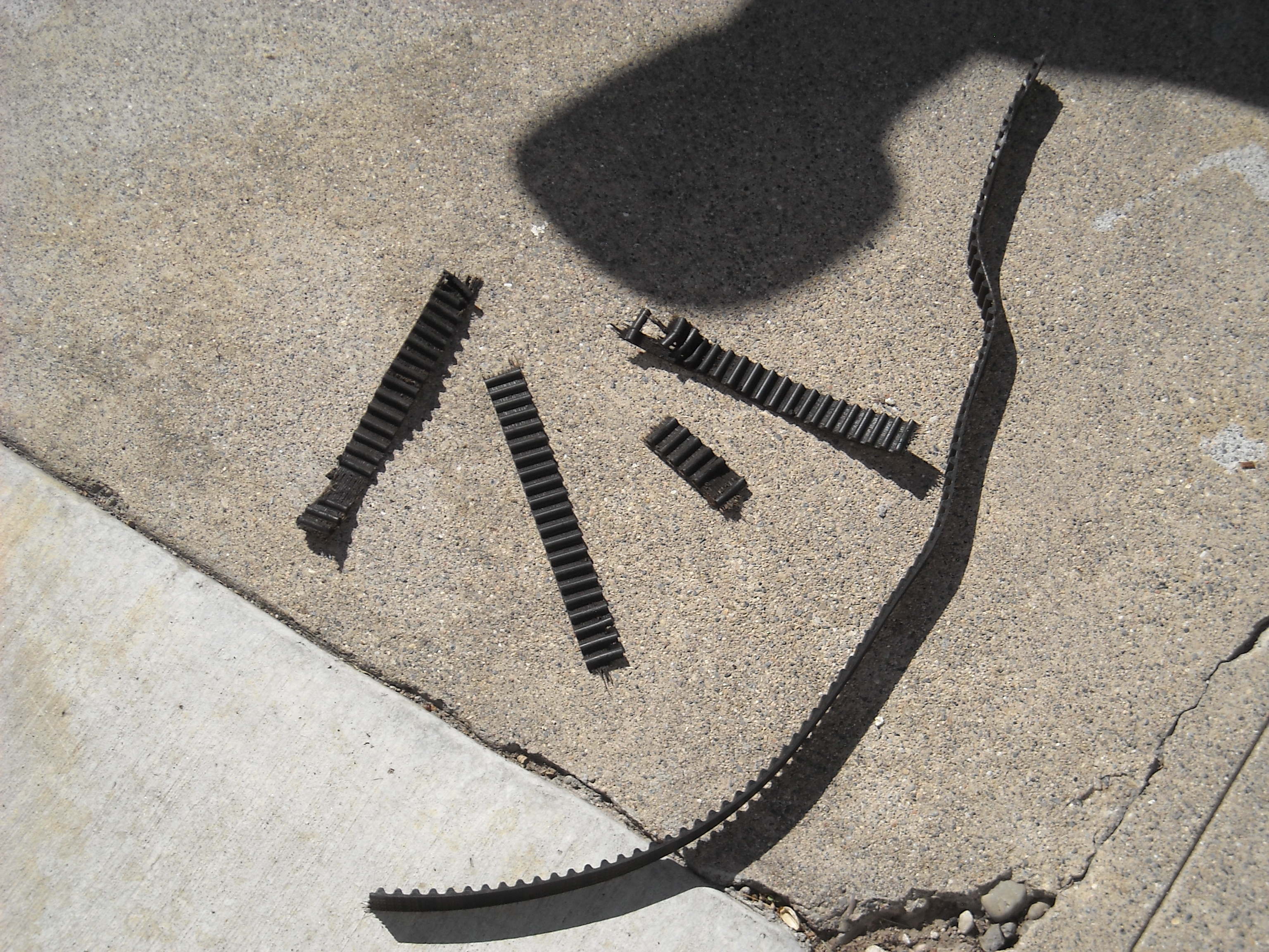

I think we might have found the problem guys
Timing belt was loose and when I pulled it out I had a couple pieces, I will be replacing this today hopefully done by tonight and will be holding off on the pnp switch for the moment.
Really appreciate everyone's help and input very hopeful but I'm not calling it a victory until it purrs and runs.
