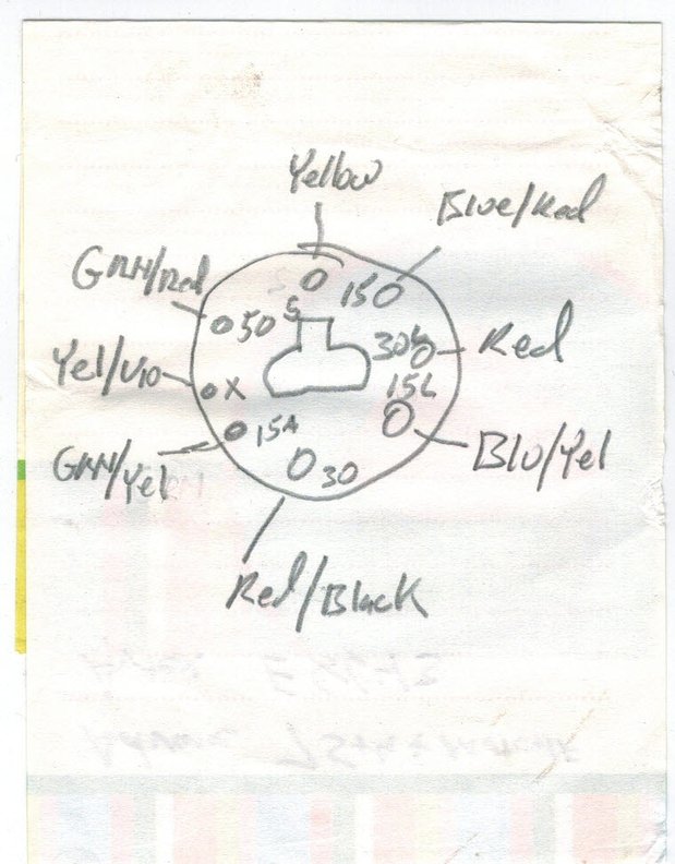

Help, I was changing the electrical portion of my ignition switch (ABS light problem) per Robert's video :D and the switch I pulled at the junkyard today came off easy. Of course mine didn't want to, and the wire connectors separated from the plastic alignment guide :o The manual I have only lists the key positions and shows one trace. Can anyone direct me to, or PM me a pin-out chart or schematic for the ignition switch?

Volvo's Legal Department won't let me - as a moderator - post the schematic but I don't think they can do anything about a scribbled picture.

Thank you sir, a thing of beauty, pin numbers and colors!
Now to put it back together

Thanks again Lee all together and works good.
Note: for terminal 50 my car doesn't have the Green/Red wire, it's Yellow/White. All others as listed.
