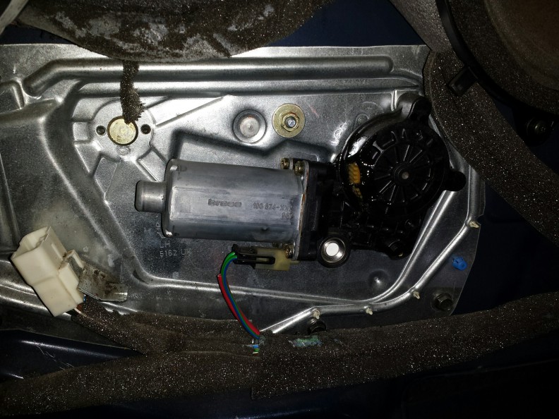

Hello, I hope someone might be able to help. I've done a little searching on the forums and I wasn't able to find anything exactly representative of what my issue is.

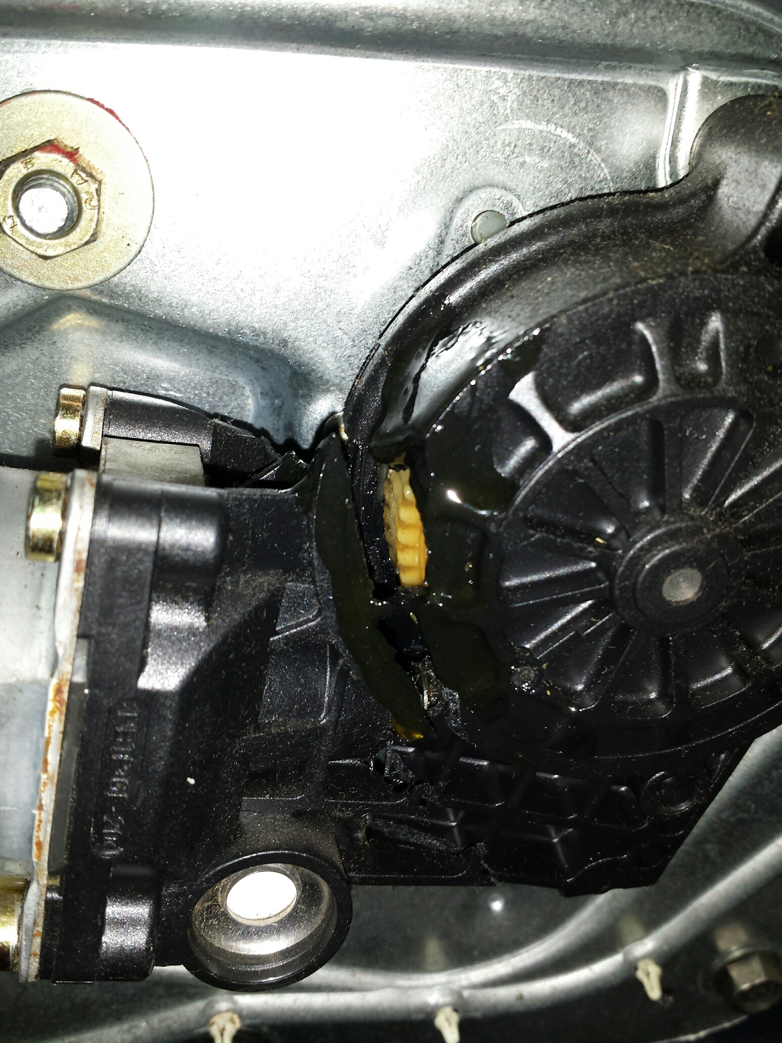

The power window regulator broke in two after the door was slammed closed pretty hard. If I hold the regulator in place, the window slides up and down without issue. The motor works fine, and is held in place by four torx screws. Can the black plastic part be replaced separately or do I need to purchase an entirely new regulator? If I can replace just the plastic and not the metal motor, what should I look for online or in a local parts store?
Does anyone have instructions on how this is replaced?
Please see the attached pictures. Thank you for your anticipated help.
-David
2000 S70 Window regulator broke in half - pictures included

The Black Plastic Casing is sold together as an assembly and is about $250+:
http://www.eeuroparts.com/Parts/9411/Wi ... r-9152723/
Your best bet is either ebay (about $40) or junk yard...

I have a few of them for the left hand side and a complete regulator, with motor, for the left rear. I think I paid around $28.00 for the motors and I will sell them for the same. The motors are complete with the gearbox. PM me if you have any interest.
