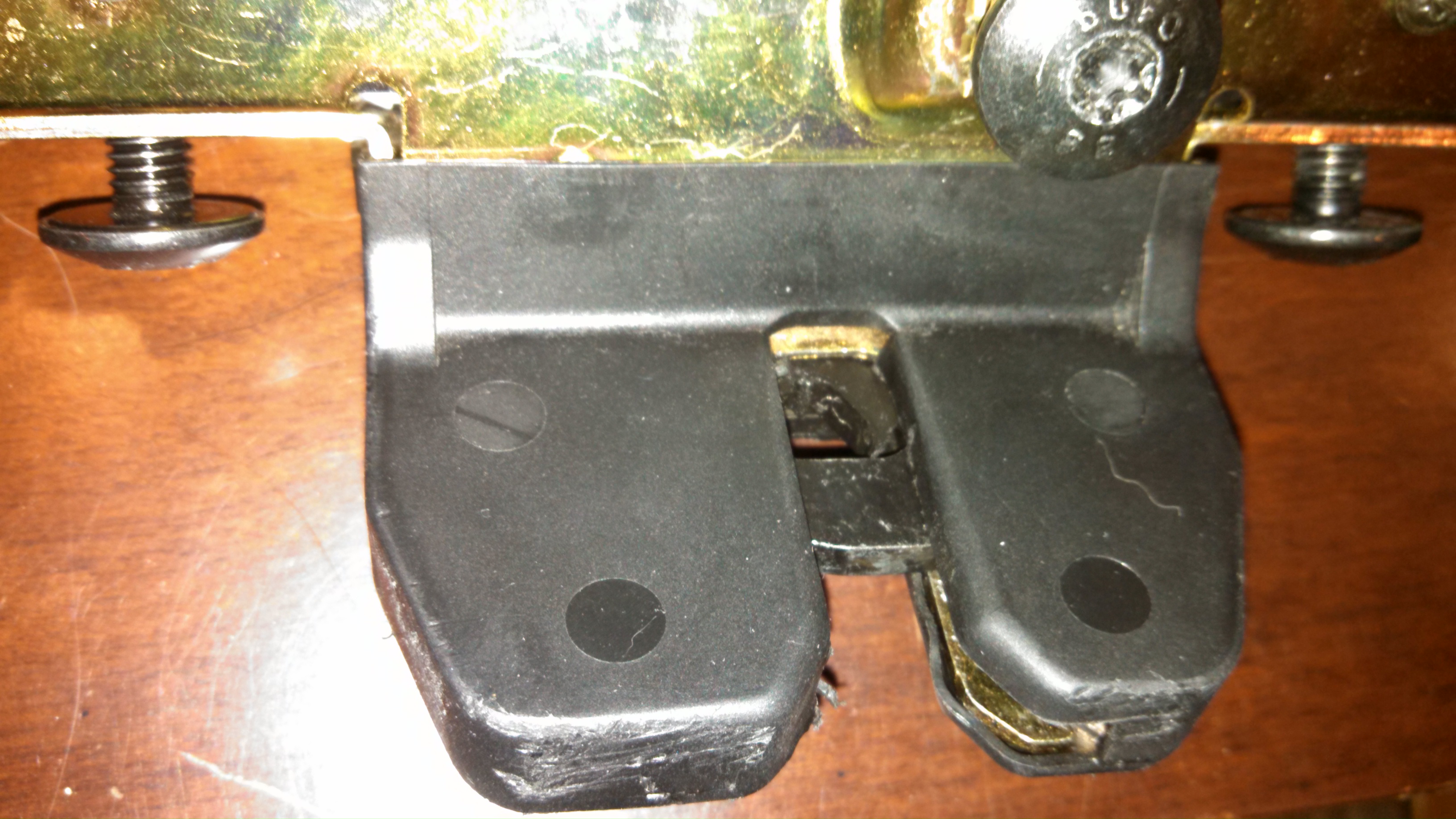

We have a 2000 Volvo V70 XC, AWD, 5 cylinder, automatic. After on & off issues with the tailgate latch, it broke late last year. We replaced it with a used one in January. Unlike the previous latch, which gave some warning signs & would intermittently work, the replacement one just broke.
We had no issues with the latch prior to this, and do not use the tailgate very often. When it broke this time, the tailgate bounced back up about a foot when I shut it. After looking at it for a few minutes, I saw that the actual latch (the plastic part that slips over the post in the trunk) was in at least 2 pieces. Found the ratchet tie downs & strapped the tailgate shut, although the Trunk Open indicator now is lit all the time.
My used replacement ran about $90 & lasted about 9 months. Thus far, replacements I've found online are in the $140+ range.
Not wanting to throw (more) good money after bad, I'm hesitant to drop $150 on another latch assembly, in which the latch itself seems to be made of non-durable plastic. New or not, without changes, any one I replace it with is the same problem waiting to happen (again). Because of a pretty costly repair this summer (replacing fuel pump in the tank), we just don't have the extra cash available to replace the same latch again.

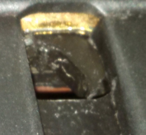

Is there any way to fix/replace the broken part of this latch? I'm going to try to post a picture of the old one, zoomed in on the piece that actually breaks (rest of the latch is fine).
Broken part of latch
busted volvo latch.PNG (386.33 KiB) Viewed 2413 times
Latch Assembly
Latch Assembly

Hi, are you sure it's broken? Can't you get a screwdriver into that gap and pry the latch back to normal position, so when it hits the loop on the base it levers it into place? Pic looks like it's in closed position. My latch gets stuck every now and again, especially in cold weather.

DrJammer wrote:Hi, are you sure it's broken? Can't you get a screwdriver into that gap and pry the latch back to normal position, so when it hits the loop on the base it levers it into place?
It's a little blurry, but in the close-up photo you can see 2 pieces of the lock mechanism. There's a jagged edge above the bottom of the latch mechanism, over to the right. The one currently on the car is very much the same, except it has already had a piece of the latch to come out of the mechanism.
