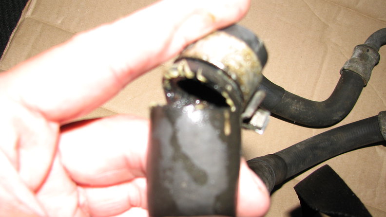

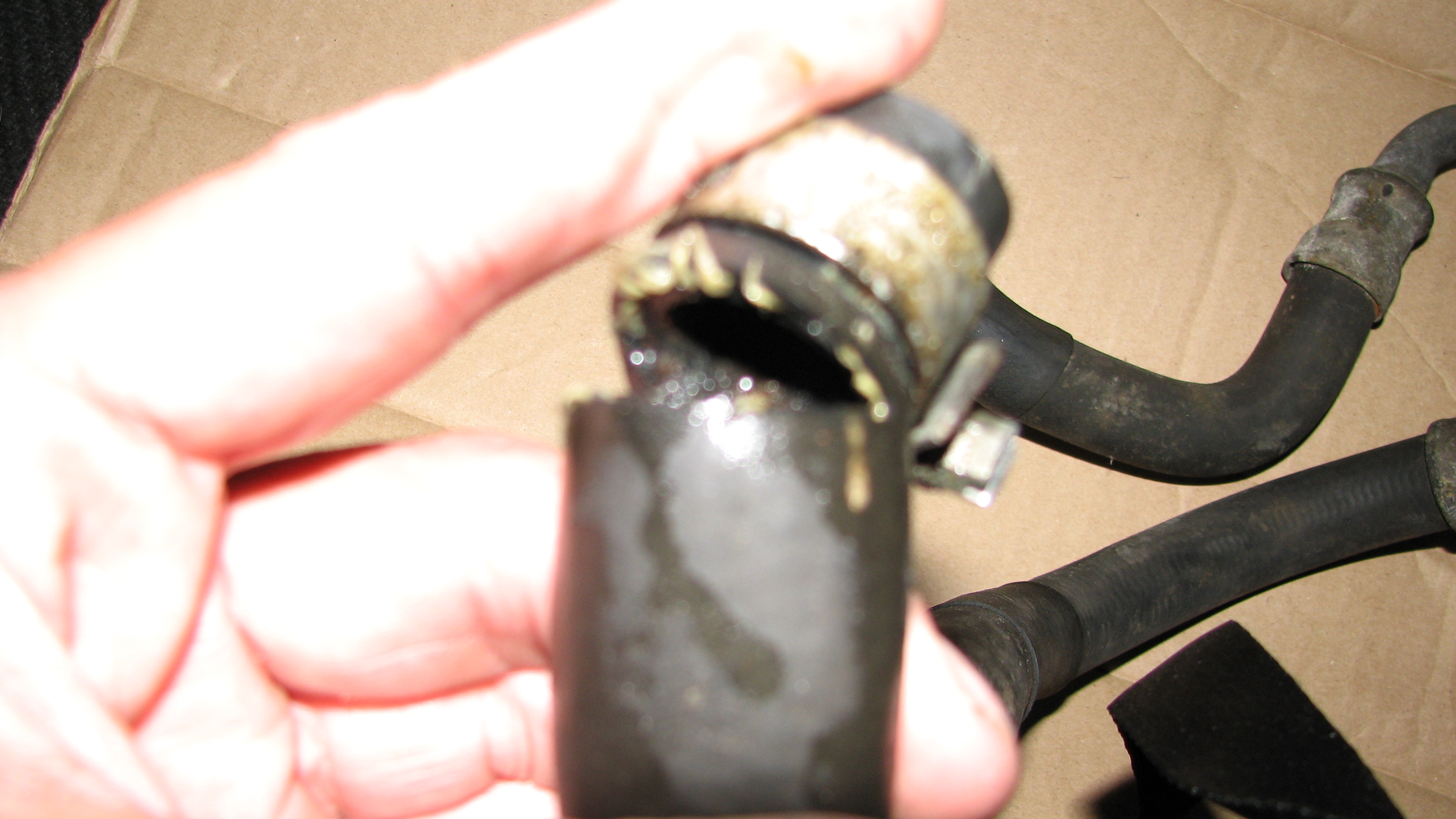

Try this link.
Definitely a heater core. 40 bucks shipped from eBay.
https://www.matthewsvolvosite.com/forums ... =1&t=66581
