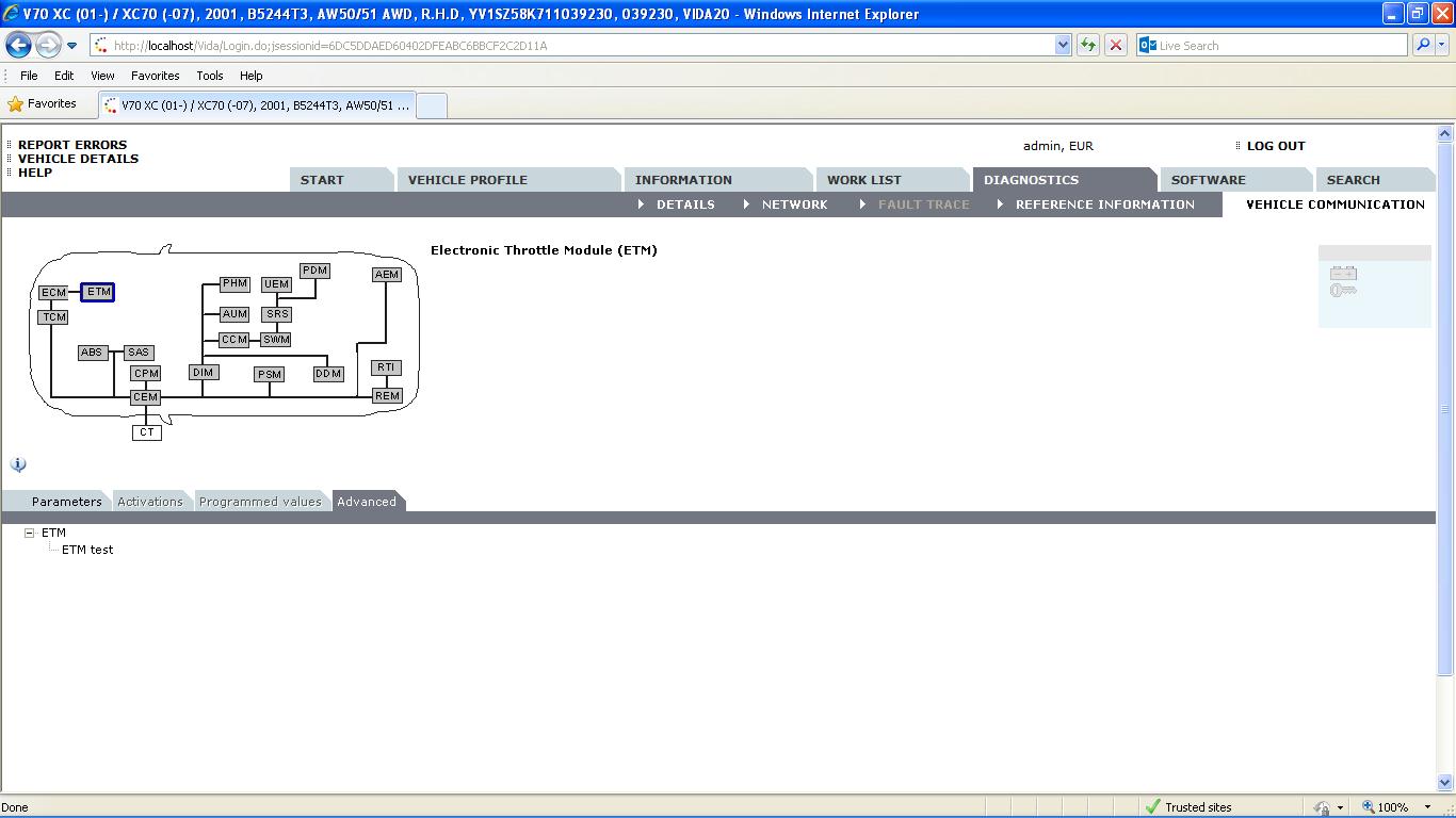

under what heading is the ETM test program?
to give you an idea, when i say the thrttle sat at 30 deg and the accelerator was to the floor, i was leaving a stop sign while a buddy was looking at VIDA. it randomly will act up and then randomly snap out of it.
precopster
- Posts: 7543
- Joined: 21 Aug 2010, 00:20
- Year and Model: Lots
- Been thanked: 128 times
As below. In Vehicle Communication-Advanced tab -choose ETM module of course.
