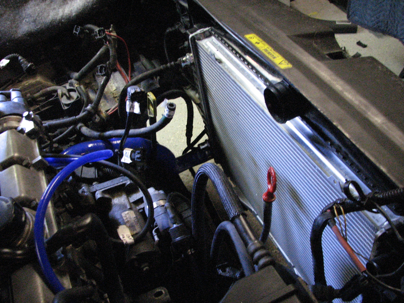

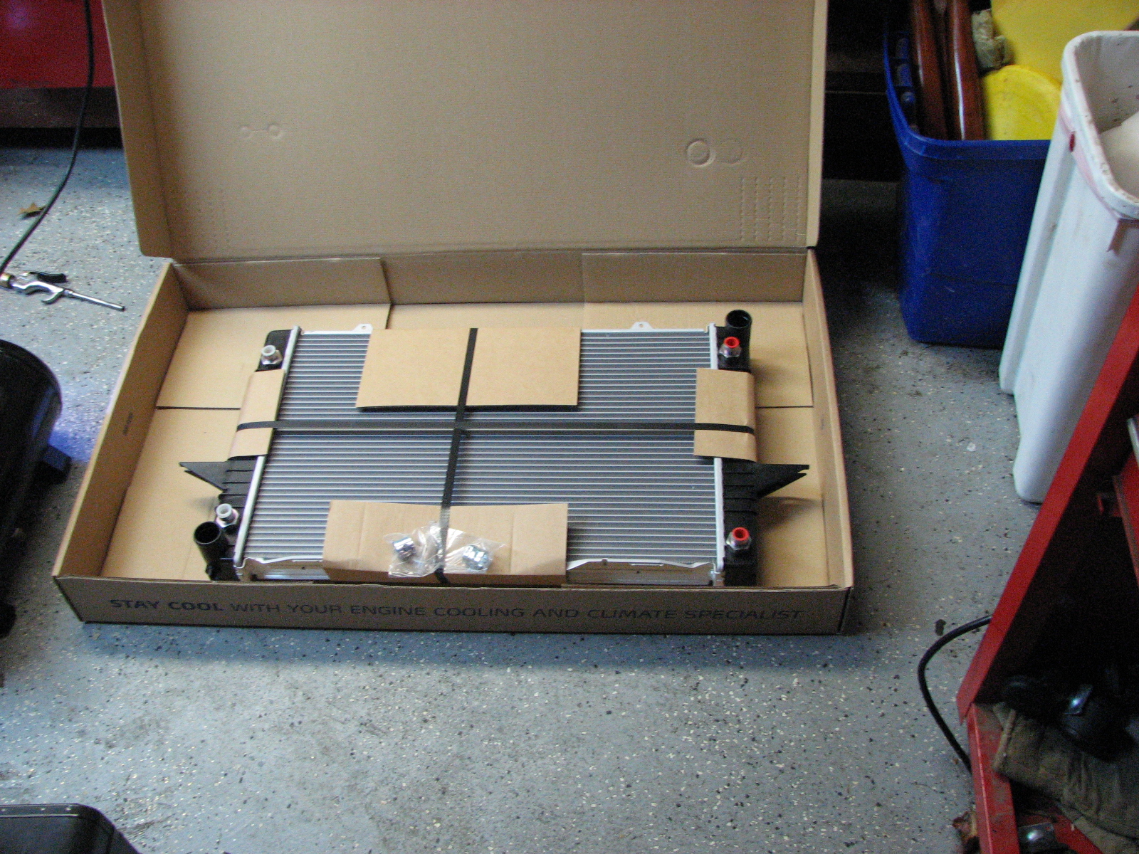

Also, the engine temperature did not stray. The car with the broken thermostat was the Wagon. I only believe that had broken while parked in the sub zero winter last year. It was never driven with the failed thermostat.
That came out when it was still negative 17F in a heated garage while installing blue stuff.
You kind of asked for it, so.. You know I like to show it. Jovial, I had fun dealing with it.
