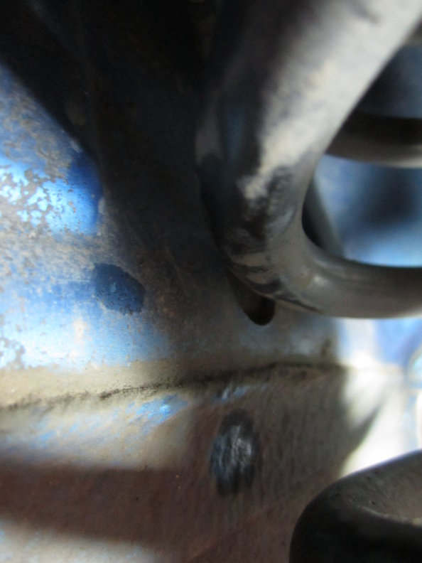

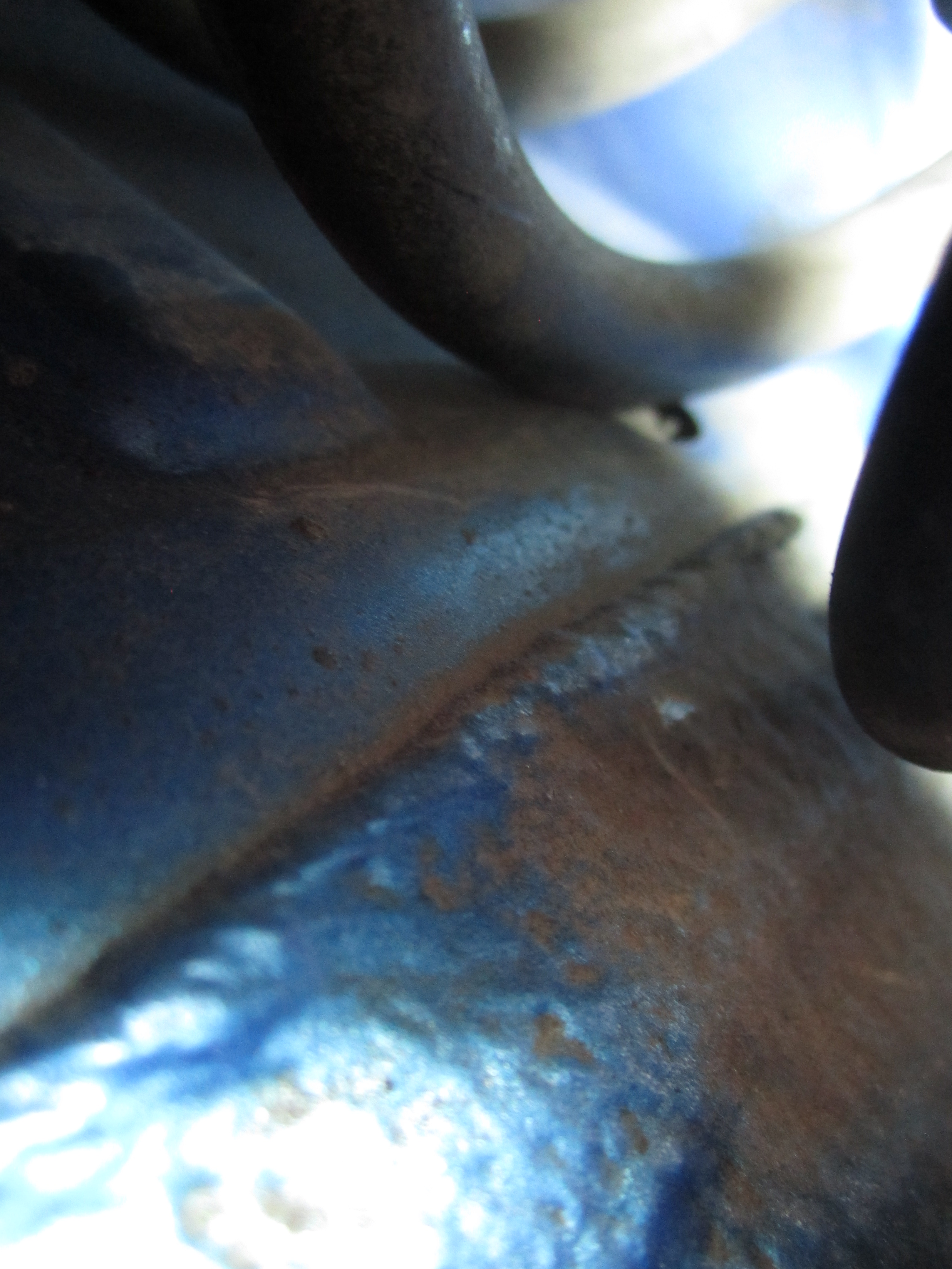

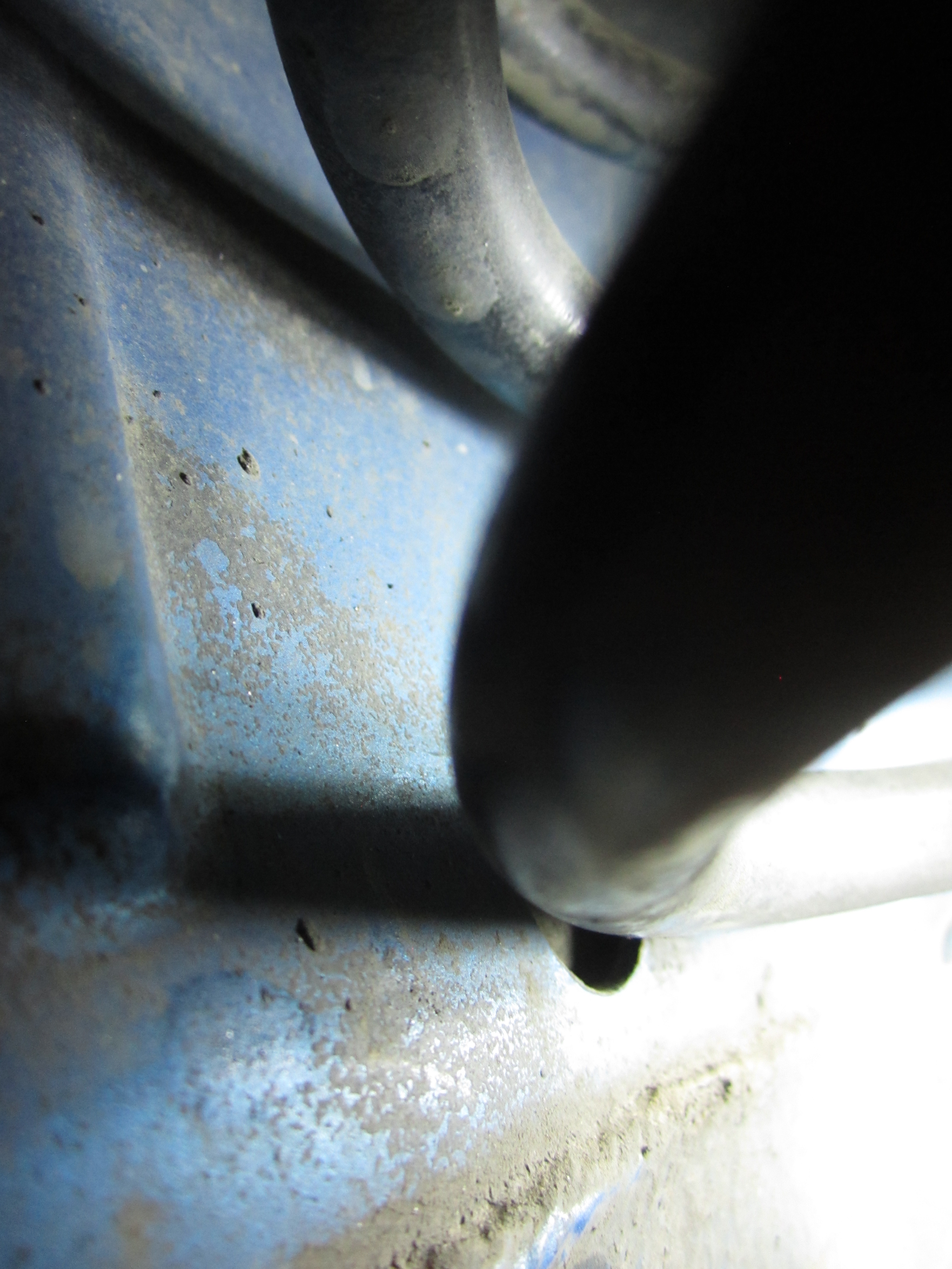

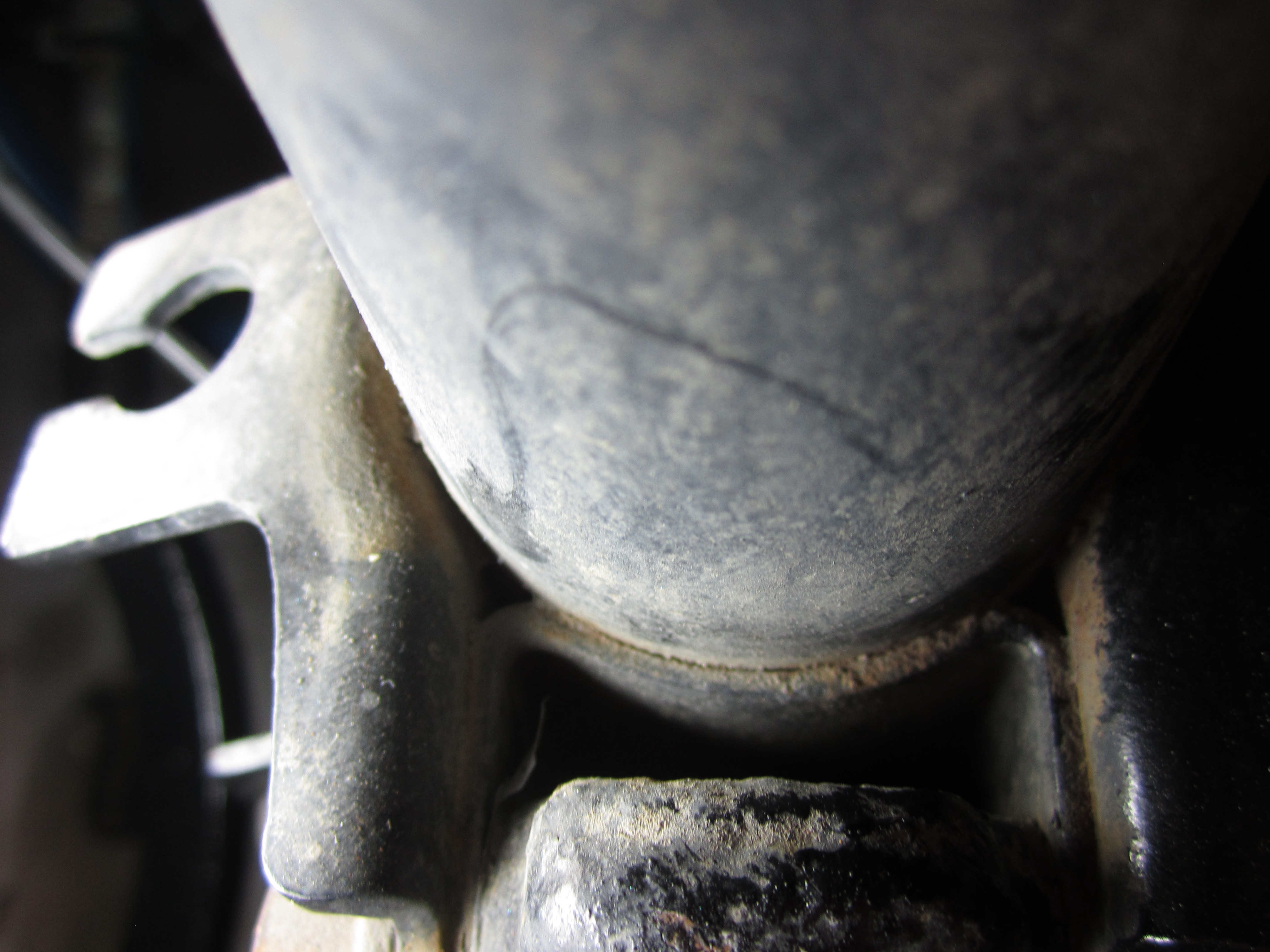

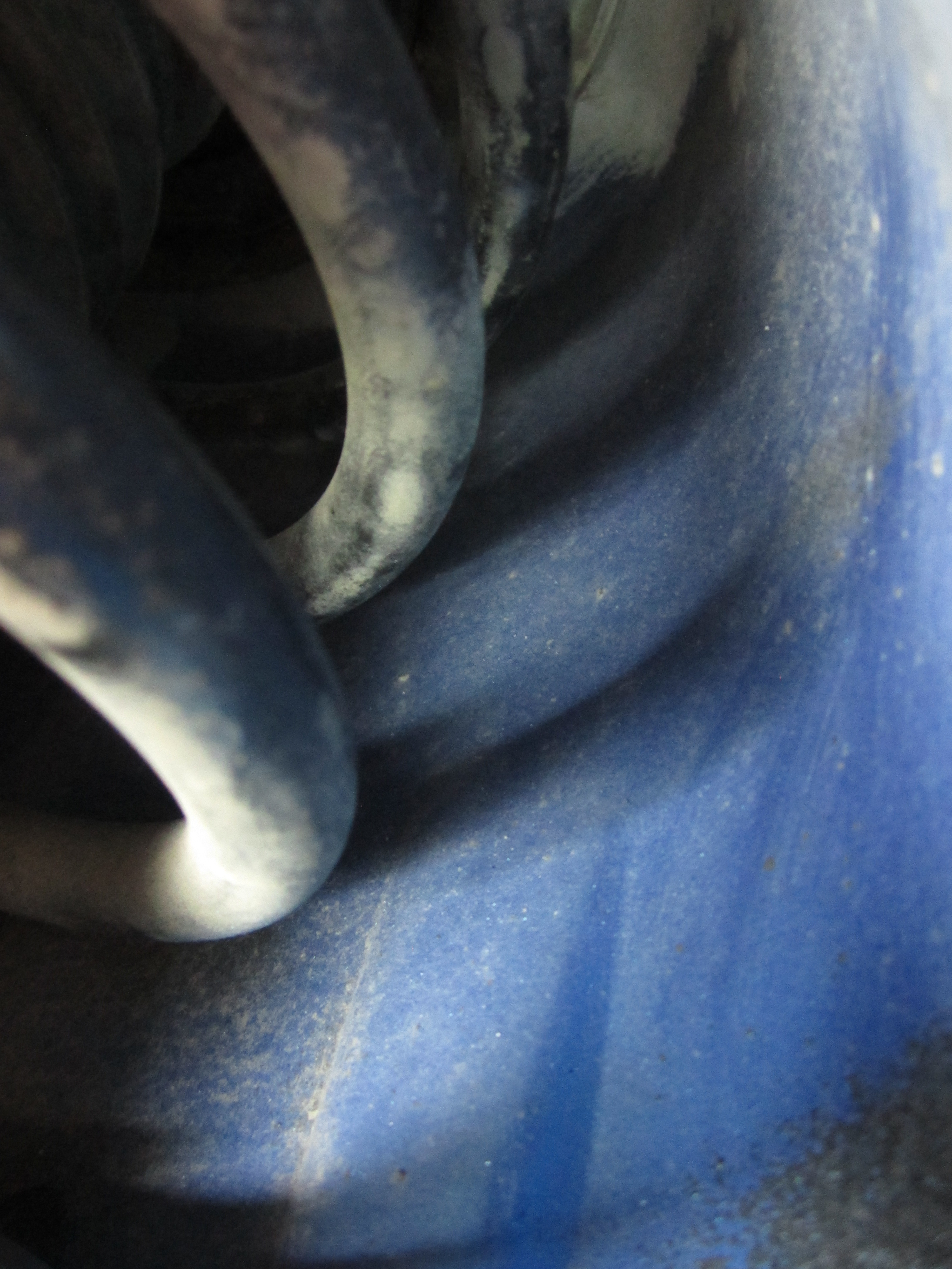

No input at all? I have tried to photograph what I see as the springs rubbing on the inner fenders:
LH front spring rubbing on inner fender
LH spring rubbing on inner fender (2)
RH spring rubbing on inner fender
RH spring rubbing on inner fender (2)
Knuckle to bottom of strut mounting
All pictures were taken with the front wheel removed and sub-frame supported on axle stands.
I believe when the wheels are re-fitted and weight is returned to the suspension, as the control arm will become more level, it will move the strut/spring away from the inner fender, but not by much. If memory is correct, there should be a small amount of movement on the knuckle to lower strut mounts to allow for some camber adjustment. Last picture shows a lot of possible adjustment room. I'm wondering if I were to loosen the lower strut mounting bolts, and push the strut inwards a little, and then try to move the upper strut mounting bolts further out, would this balance the camber movement, but possibly move the spring out slightly from the inner fender, or make it worse.
