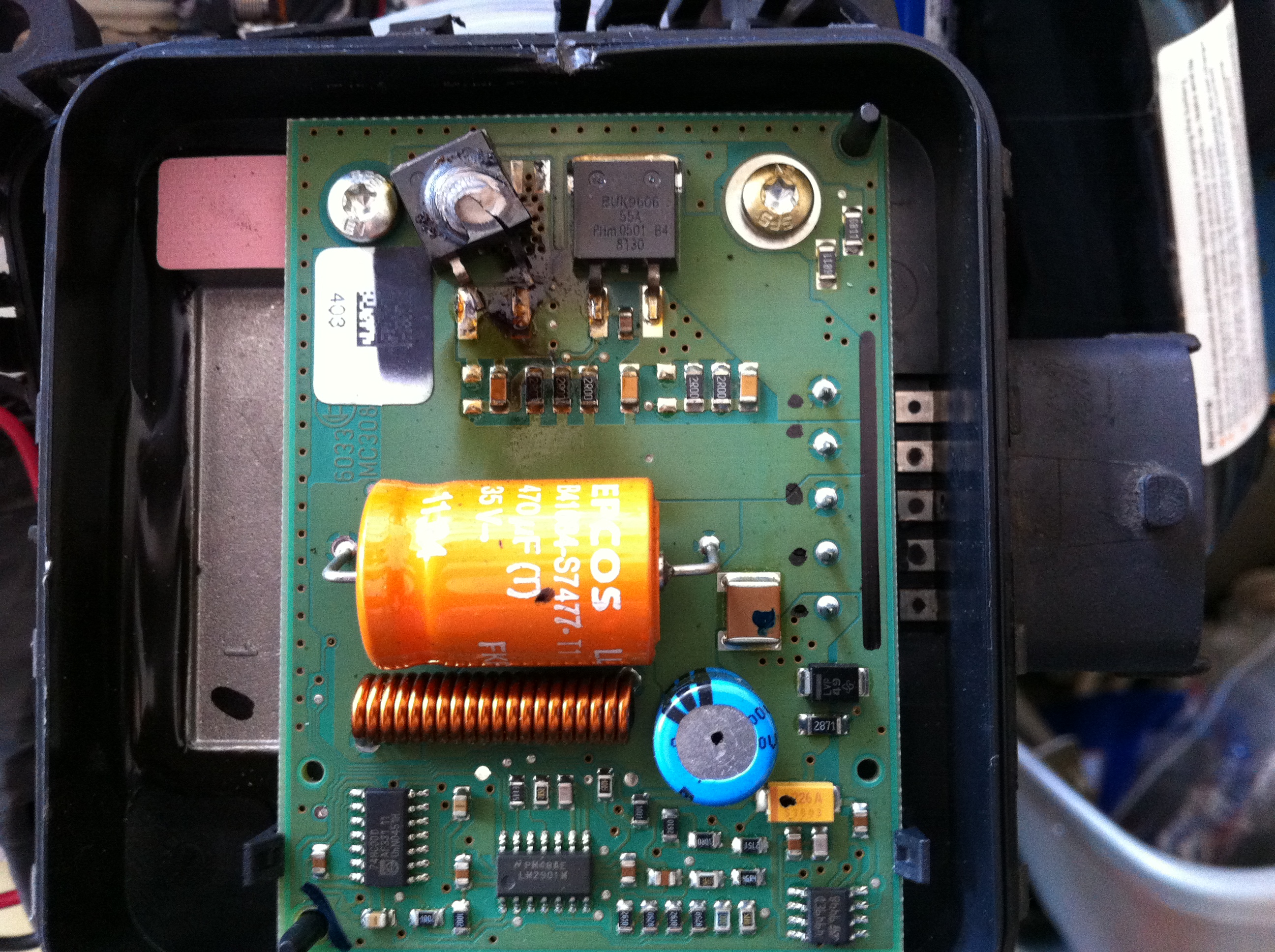

Leaving work several weeks ago my Volvo stumbled and died. I had it towed home and spent the weekend troubleshooting. The car was not getting any fuel at the rail and I never heard the fuel pump come on. I checked the fuel pressure sensor and it seemed to work fine. I ran the fuel pump from the battery and it would run and generate pressure at the rail. So I decided the PEM must be bad and ordered a new one. Opening up the old PEM I could see the FET and diode was damaged.

I would appreciate any ideas. I will post pics of the damaged PEM and also the error codes tonight.
