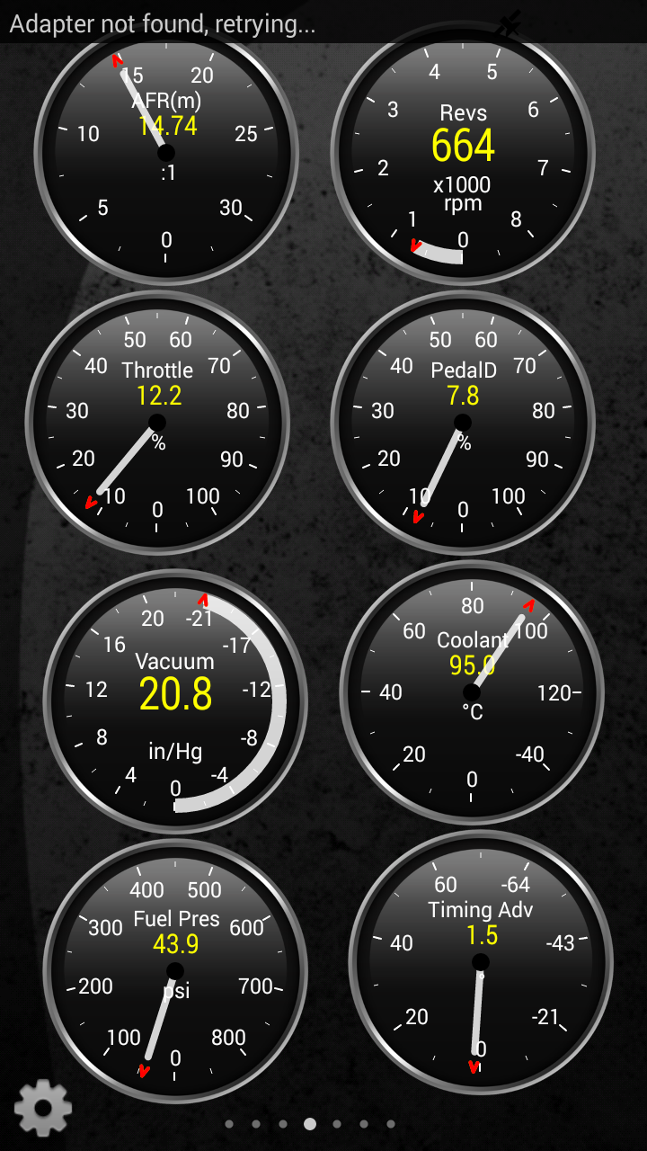

I get diff reading for throttle, see sceenshot. Need someone to jump in with a Vida reading.
