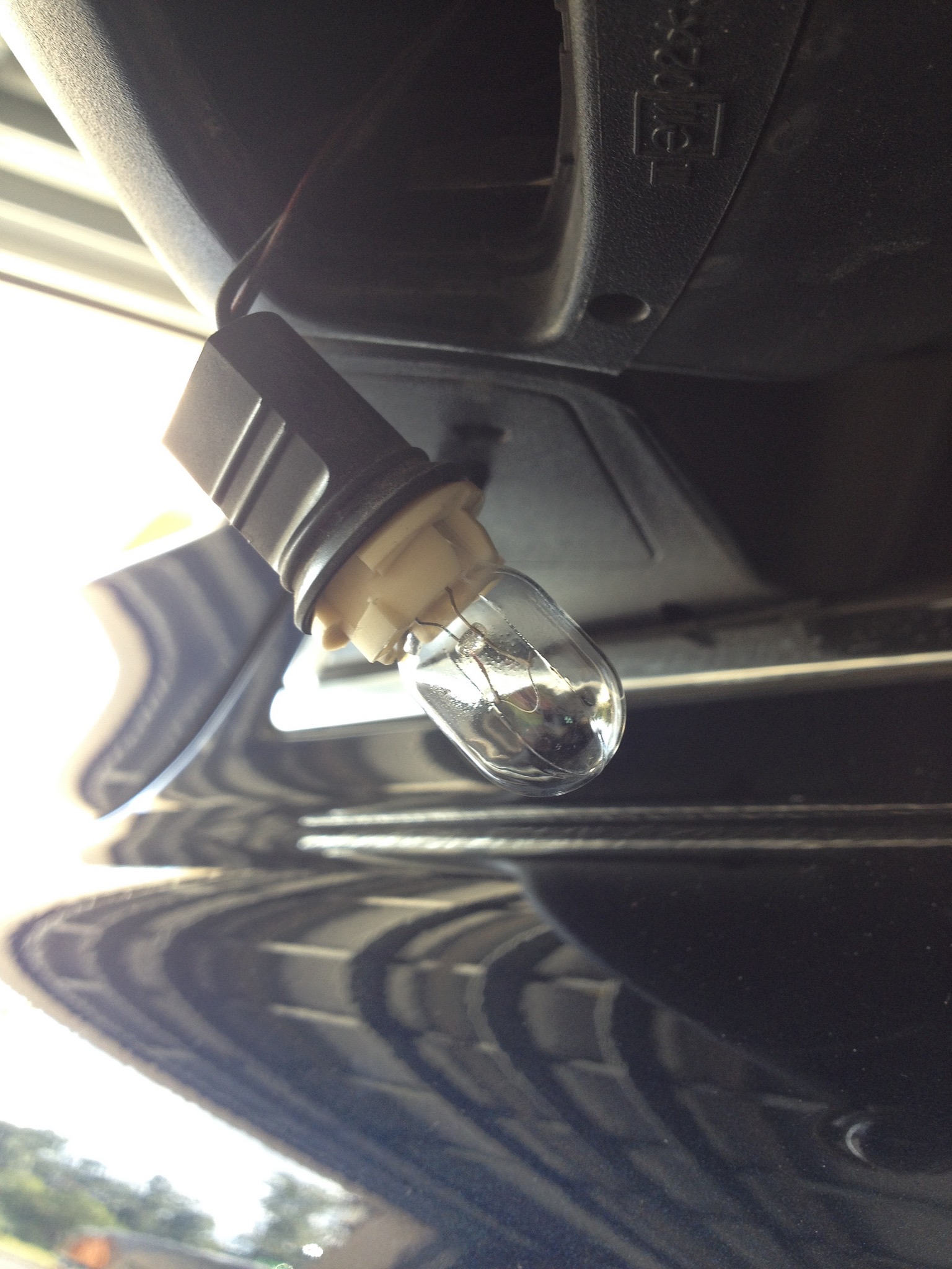

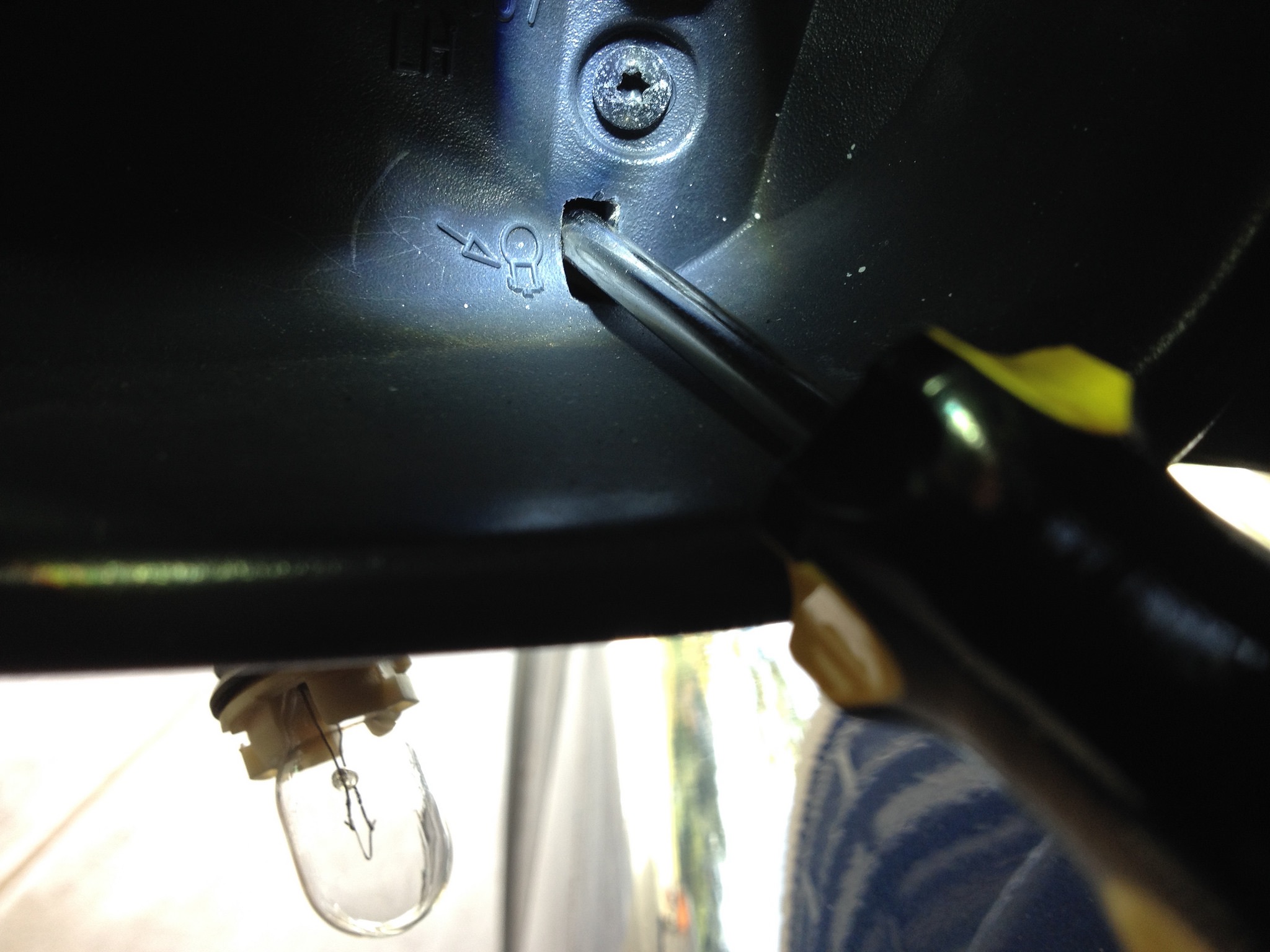

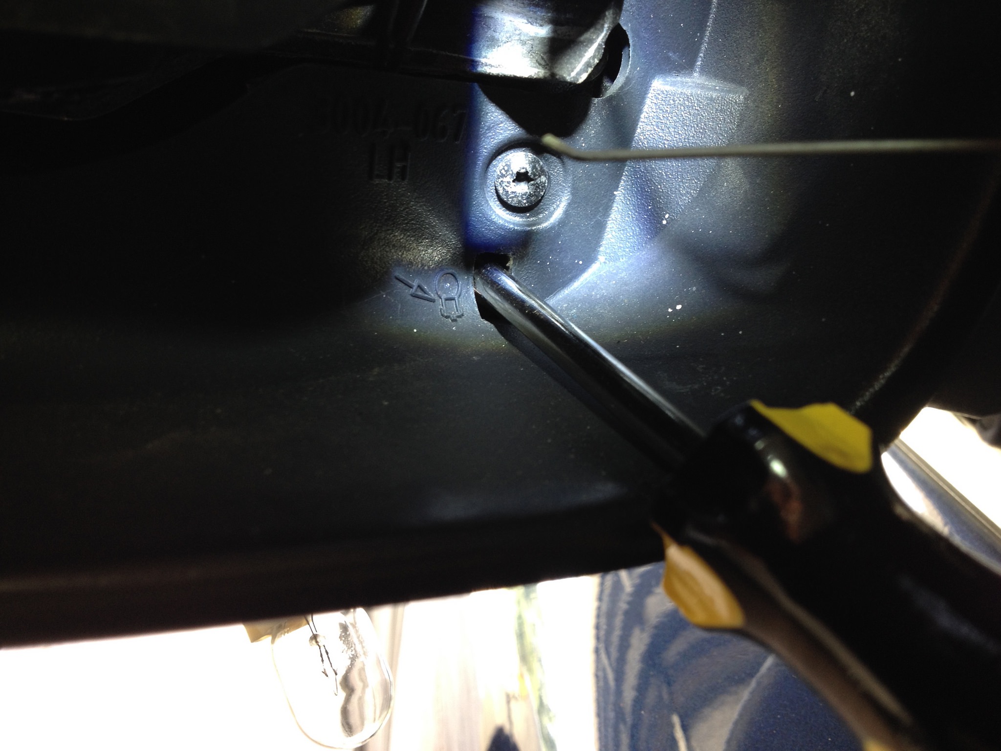

replacing standard bulb with LEDs.
flat edge screwdriver into slow and slowly twist.
Removed mirror by tilting outer edge toward door, inner edge toward engine. Horizontal plane.
PULL outer edge away from car. You'll see mirror clips when it pops out.
bulb shown dropped from mirror
