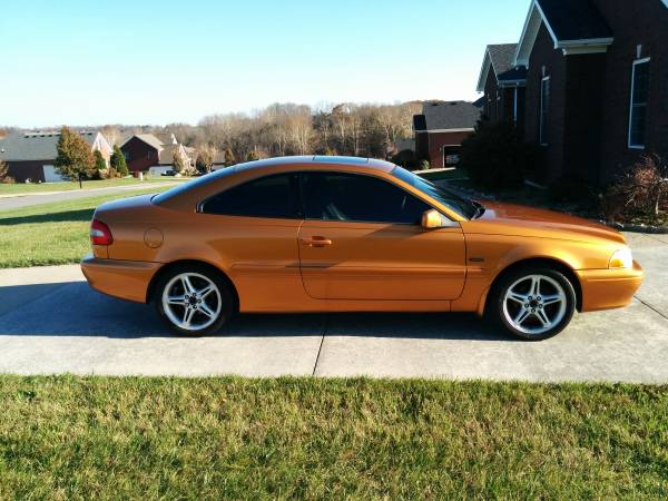

I purchased this yesterday.. its a 98 saffron 5 speed with 204k miles. The main thing ive noticed, it feels like there is no boost. I removed the turbo heat shield and checked the wastegate and it wasn't stuck or anything. The previous owner said he did the PCV on it awhile back so I don't know if there is a vac hose connected wrong or what. Any ideas where to start ?

Wow....nice ride!

Does it feel like its not boosting in upper ranges where your R does, like a LPT that behaves differently than your HPT 850, and you just need to get used to the boost coming in earlier, and peaking out lower?
Beautiful car!

Actually it feels like it doesn't boost as good in the lower RPM, my R has a chipped ecu and boosts 15lbs. so im probably just use to that.
The C70 is a HPT car
. Thanks for the compliment

Now I'm twice as jealous!
