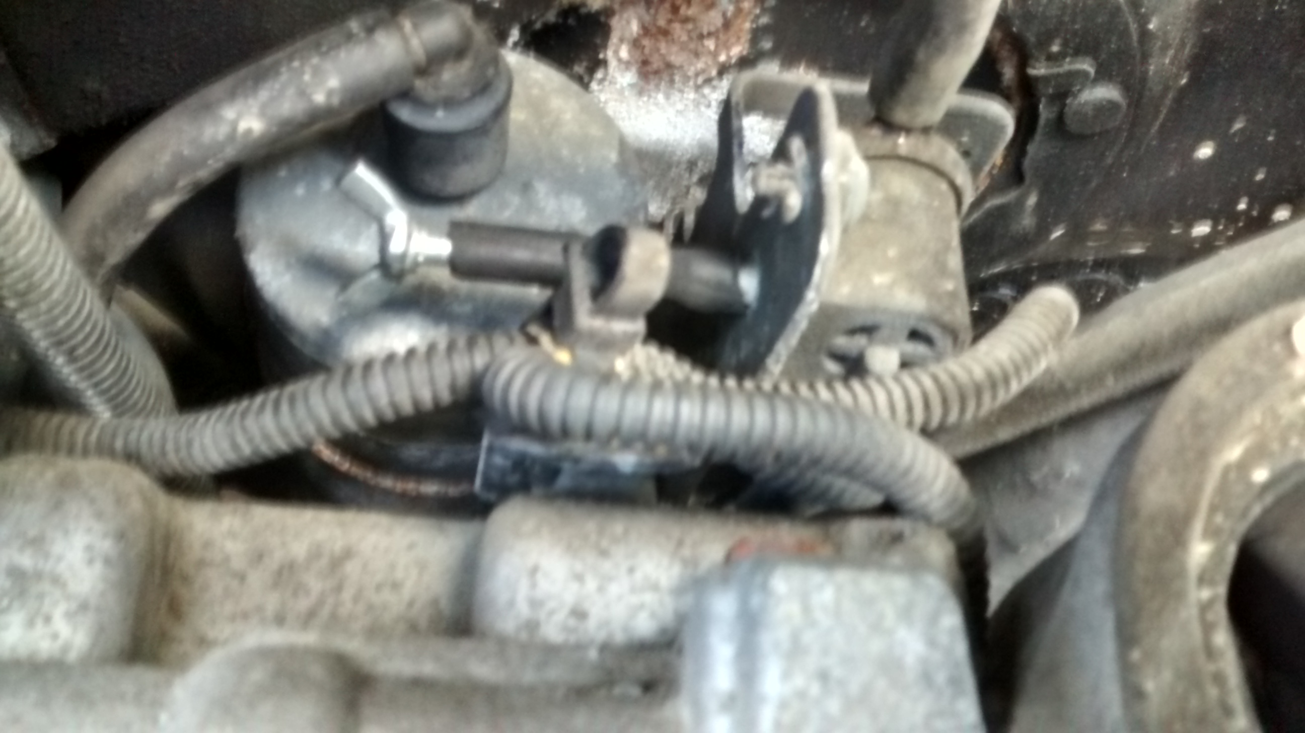

Large evaporative leak, Ive been battling this leak forever started as a small now large i found a spilt hose on the purge tank in the fender well and replaced all of those lines and just about every small vacuum line i could lay my hand on,replaced the gas cap,purge valve,air injection pump switch,smog pump,air pump control valve,check valve etc car runs great just sick of the check engine light popping up after a hundred miles or so,suggestions?

Not sure of this, but I recall there are vacuum pipes at the rear of the car at the fuel tank. Seen pipes split there and can be hard to see.

I'm chasing the same one. The only place I haven't gotten into is the top of the tank at the rear of the car. Access from the top coming through the rear behind the back seat area.

It sounds like you've checked most of the usual suspects. I don't know if the '98 has the roll-over valve, but on my '97 a damaged rubber connector hose at the roll over valve was the culprit for the 0455 code. On the '97 the roll-over valve is located near the fuel filter at the RR corner.

My 98 has a rollover valve, definitely check the hoses back there.

After the J hose, the second most common cause of p0455 is probably the hoses at the rollover valve. It's not a fringe suggestion, I would say he definitely hasn't covered the main culprits ... not yet!
