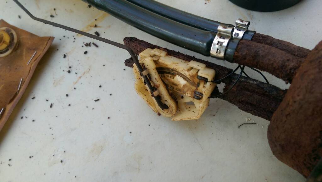

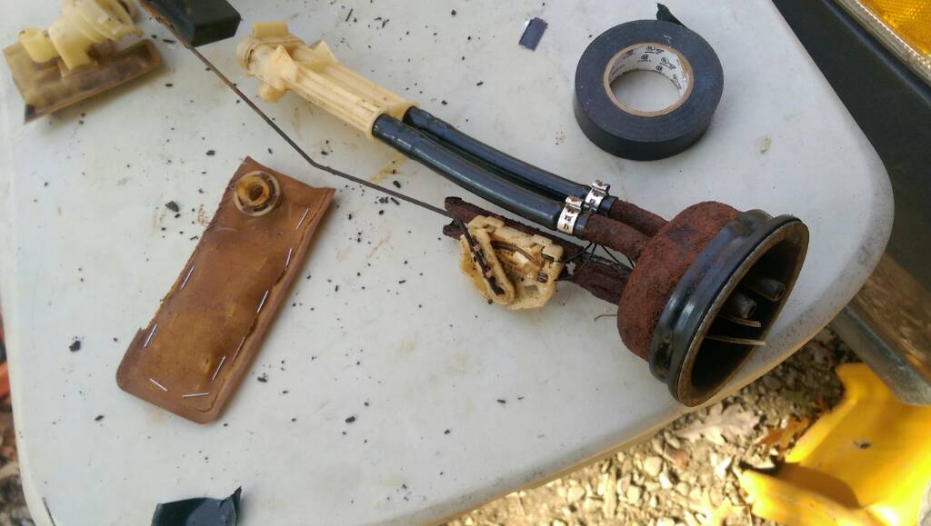

So here I have this new, self caused, problem with my fuel gauge. Here is a quick recap of how I got here.
Bought the XC with a bad fuel pump. Replaced that. Wiring was all goofy. Fixed that but it only measured as half full. Could also only get only 200 miles out of a full tank. Today I dropped the rear suspension and tank to get at and replace a leaking quick disconnect and fuel line. Also pulled this... The LH fuel "pump" and float assembly. It was pretty much falling apart. While cleaning it the wiring for the float disintegrated and now my gas gauge isn't working the same. Bonus: I now have fuel "pumping" from the LH tank!
What happened now is my gas gauge now measures empty if I leave it disconnected, or it measures as half full on an empty tank if I connect the wires.
Can I.... And I am going to experiment, somehow connect the LH wires to the RH so at least get the gauge to show me when it is truly empty?

Update : Because the wiring on the sender fell apart, there was no current going through the wiring, meaning that the gauge showed an empty tank. When I cut and connected the wires the resistance on the 7 volts going through the gauge was higher than designed and showed half a tank(even though it was actually empty).
The solution was add a few resistors to act like the LH sender was showing empty and if the RH sender was also empty then the fuel gauge would show the true level of the gasoline. Down side is that when I fill up the tank the fuel gauge, it will only register one side of the tank and show only half full. Still a positive now I can really tell when the car is low.
Started with a 330 ohm and that was too much. That just showed empty. Now I'm at 141ohm and it shows what I think is in the tank. I will see how it goes..
