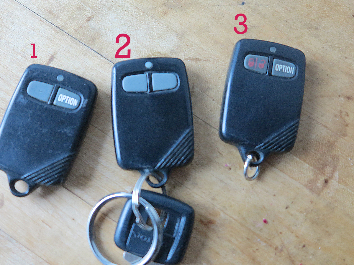

I would like to understand it and then restore the Keyless FOB.
Here are three photos to help make sense of it.
Item marked 3 was recently purchased from eBay seller. It needs programming.
1 is damaged, 2 works some time. I am using key to lock/unlock the car.
ELVAT8C - PROOE2 transmitters

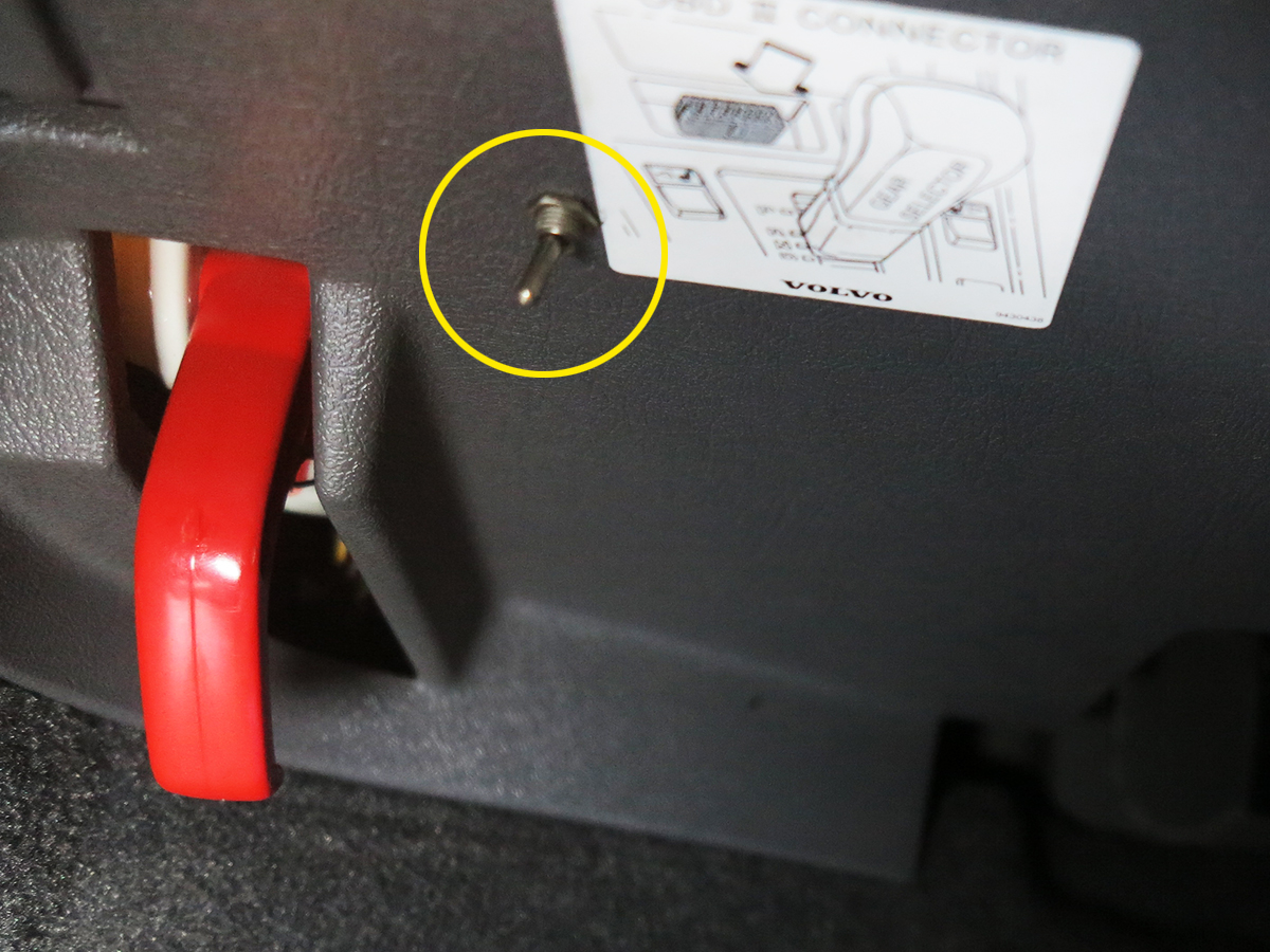

A pin like switch near hood lever. Not sure, but assuming it is part of FOB since it is wired. What does it do?
A switch - wired to FOB

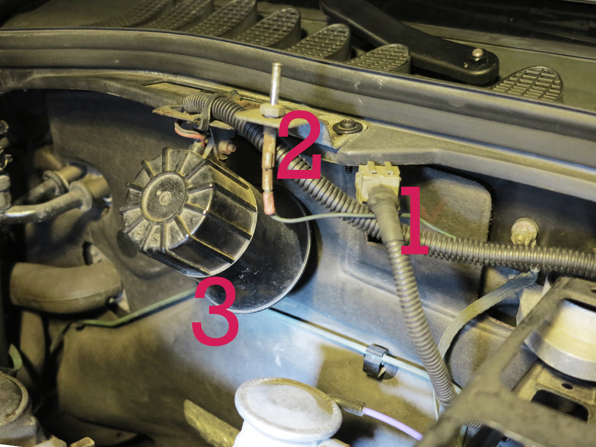

A view of engine. 1 sensor, 2 a vertical pin with spring like it goes up and down, not sure what it does, 3 a horn like object (car horn works)
Alarm - items at engine

That doesn't look like the factory-fitted alarm system – the fobs and alarm horn look different, and the factory system doesn't have the switch by the hood release, or the pin that you mentioned. The alarm horn nut mentioned is probably not relevant in your case.
The 'sensor' is the unused connector for the factory alarm horn. The pin is there to trigger the alarm if somebody tries to open the hood (the factory system has a sensor in the hood latch instead). The switch by the hood release is probably something to do with disabling or resetting the alarm. Years ago, I had a car with an aftermarket alarm, and it had a hidden switch that (I think) would let you disarm the alarm if the fob stopped working.

Thank you for providing clues.
I am the the first owner, so looked in to the purchase record file, and found this warranty paper along with a user manual. It is Audiovox Pursuit. The manual refers to a valet switch, I am assuming it is that pin near the hood lever. Now I need to figure out valet switch ON/OFF position.
It has remote starter, did not know.
Audiovox Pursuit
Audiovox Pursuit

After reading the materials and instructions -- some online -- the switch in the photo is indeed a valet switch. It is a toggle kind, but not sure of OFF and ON. The LED in valet setting should stay ON -- something is not working.

Every toggle switch that I've ever seen is notched for the
installation of a legend plate that indicates it's position.
You pic doesn't show it, but on the back side of the threaded
portion, you'd find a notch milled from one end to the other.
That indicates the open or "Off " postion.
In your pic, the valet switch is on.
