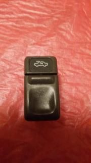

I had a couple bulbs out on my sunroof and tracs switch so I decided to replace the bulbs. Here is a write up on how to do it if anyone needs it..
Here is the replacement bulb youll need. I had to order from Radio Shack. ( part # 272-1092 ) It was like 5 bucks for 4 bulbs..Image

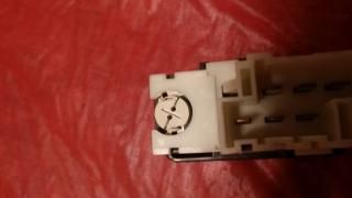

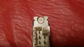

First off.. remove the switch, simply pry it out of the dash and it just pops out. Then unplug. Once you get it out flip it over and youll see the bulb..
Image Image

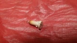

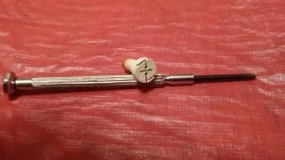

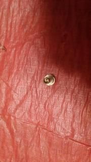

Use a small screwdriver and turn the bulb counterclockwise and remove the bulb

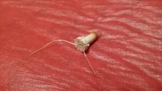

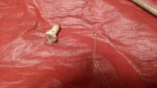

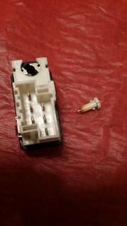

Once you remove the bulb take a small tip screwdriver and stick in the slot and youll see the end of the bulb wire. Peel the wire back and unwrap it from the bottom of the bulb ( both sides ) then pull the bulb out

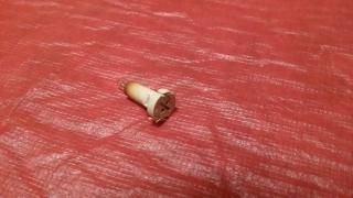

Once the bulb is out you'll see the two holes in the bulb holder, insert the two wires in the holes of the bulb holder and then wrap it back around as the old wires came out. Trim the extra wire off.
Insert the bulb back into the switch, give it a partial turn clockwise, and re-insert the switch and there you go :)
