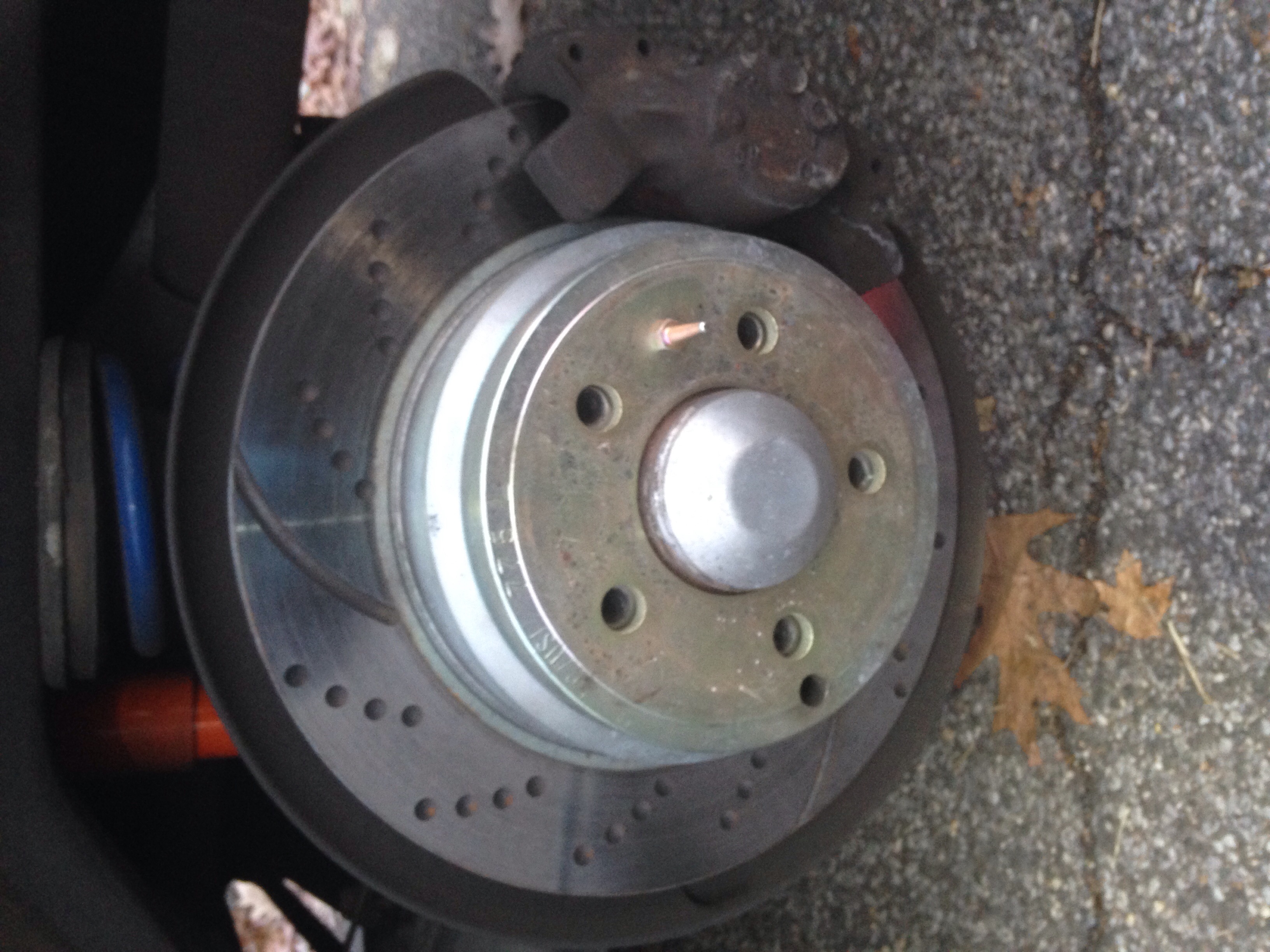

I noticed my rear axle wheels do not free spin. I replaced my rear rotors w/ EBC Rotors & redstuff ceramic pads along w/ SS brake lines from fcpeuro.com. It seems the previous owner put new hub/wheel bearings on both rears. So either the Hub nut is to tight or one of the pistons on each caliper is stuck in the open position. Any thoughts MVS?

First thing I would check is the adjustment on the e brake. Even when its adjusted properly you will have some slight rubbing. Take some slack off and see what happens.
- Posts: 36156
- Has thanked: 1611 times
- Been thanked: 4072 times

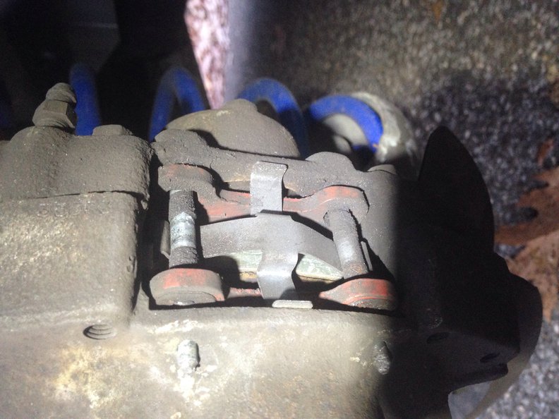

In likelihood of occurrence
Frozen caliper - looking at your pix and NYC location - I would go with this at 93% probability
Sticking emergency brake - usually happens if it isn't used regularly, and then used one day.
Seizing wheel bearing - almost always accompanied by nasty noises in wheel.
