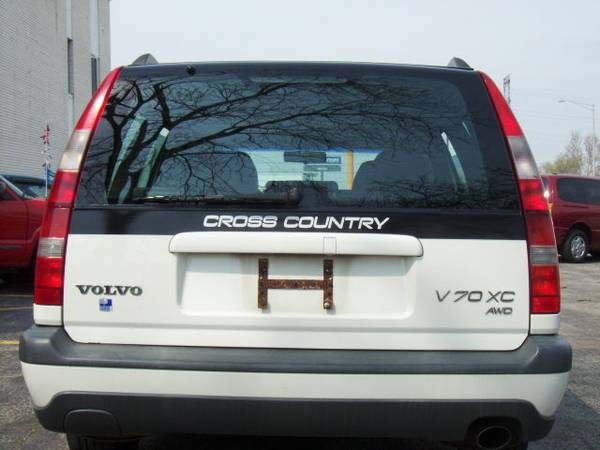

Not bad from the rear.
White XC1.jpg (31.37 KiB) Viewed 3273 times

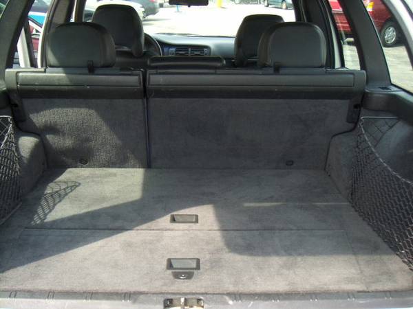

Looks as new back there.

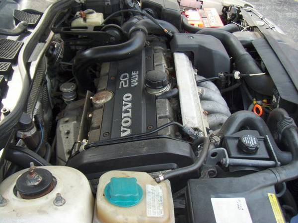

Engine bay has degraded a bit since then.
White XC6.jpg (42.91 KiB) Viewed 3273 times

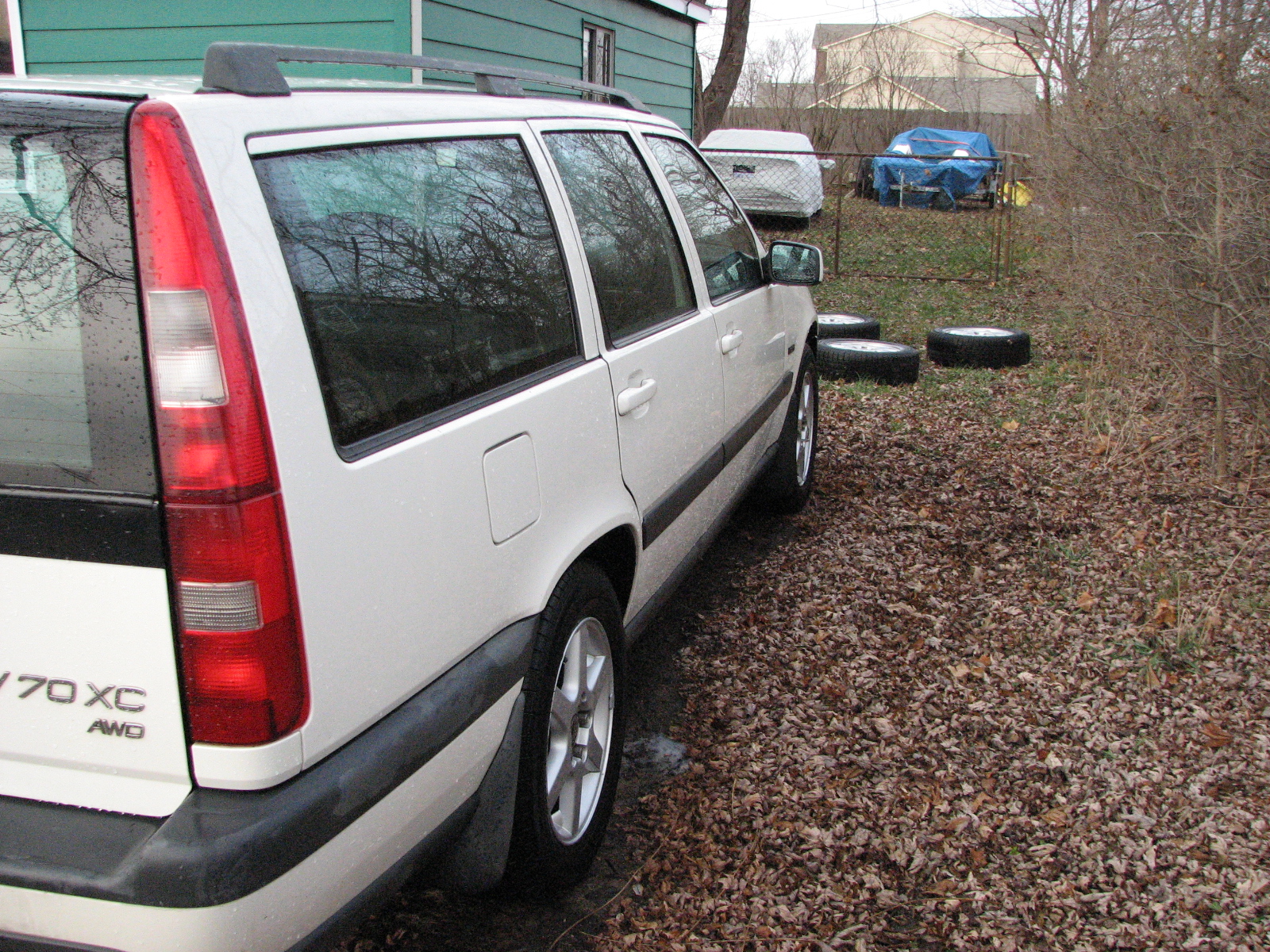

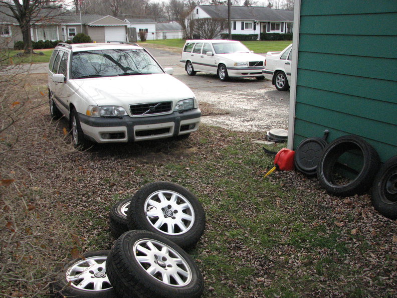

Washed the wheels today while putting the hose on the spool for the winter.
Gave it a short bath.
Whole lot of white in that driveway.
T-5R hiding in the backyard with water craft.

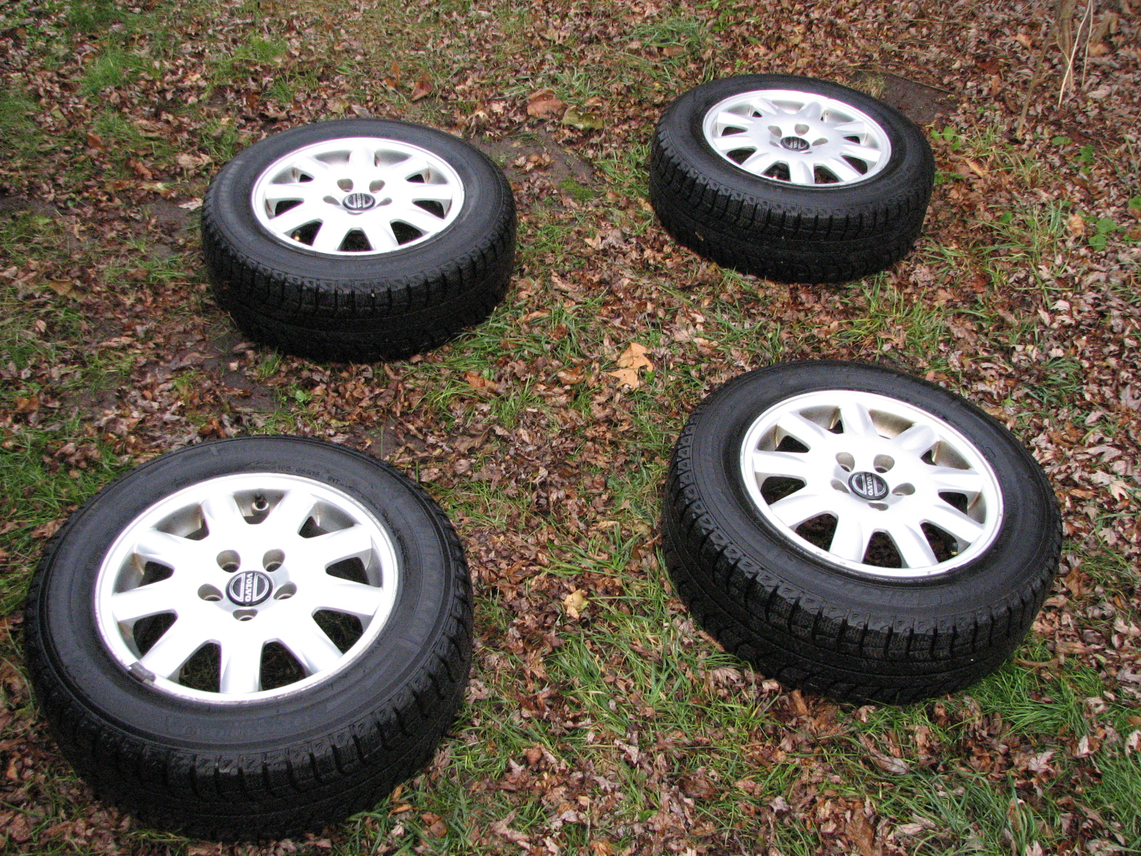

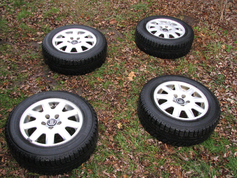

I bought these wheels for the winter tires attached to them.
The neighbors must be curious as to my mental state. Me too, I might think?
That being said, I will open the hood tomorrow. Weather permitting.

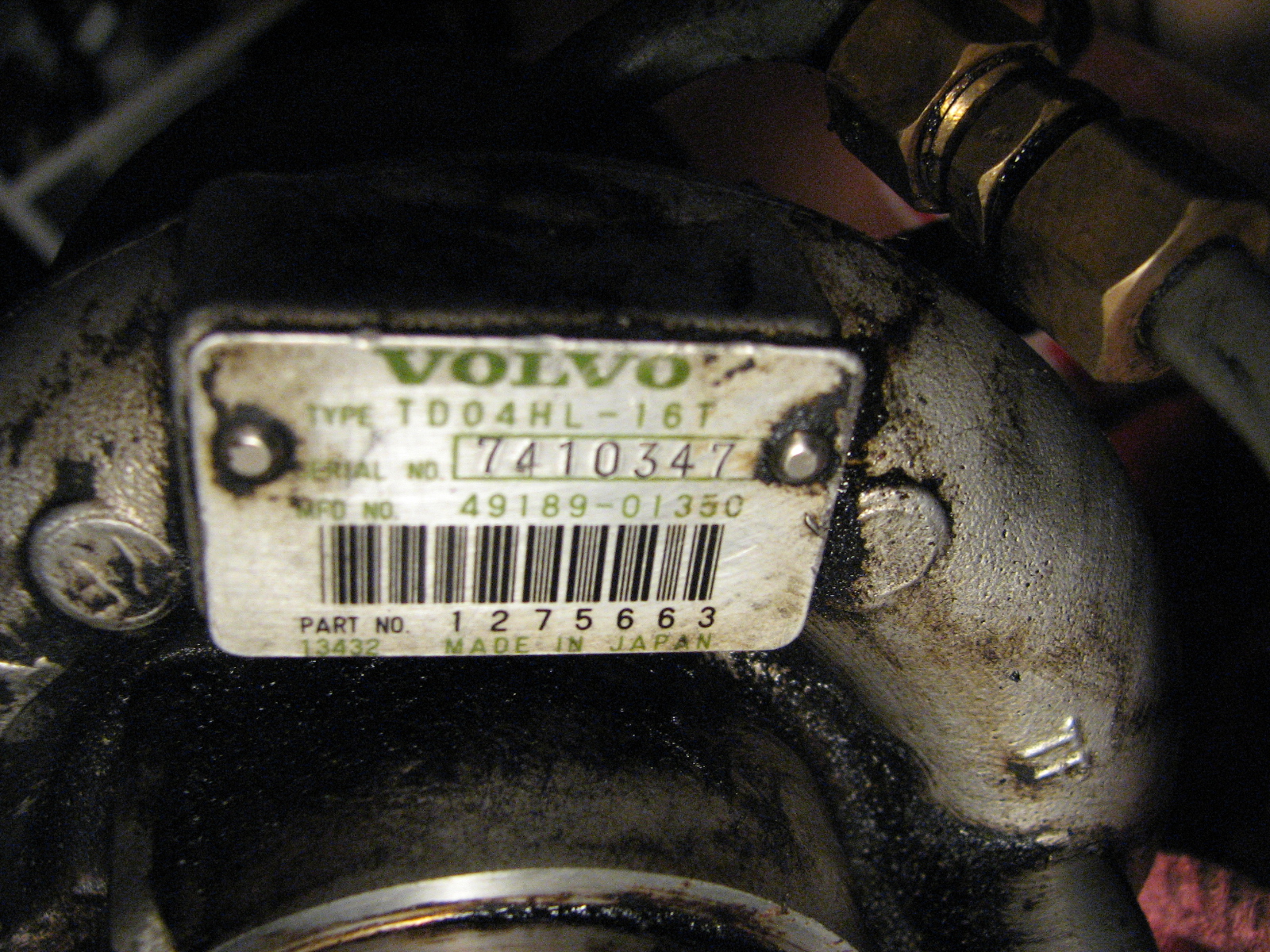

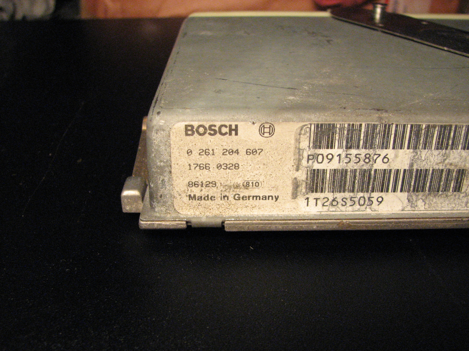

So, I had picked up a few things at the pull yard that could apply to any of my cars. I m thinking of making the LPT into an HPT by way of a '98 T5 ECU and 16t compressor.
As I mentioned in another post, if I blow it up, it was just meant to be. I will have to fix it. Again.
I want to look up the original mapping.

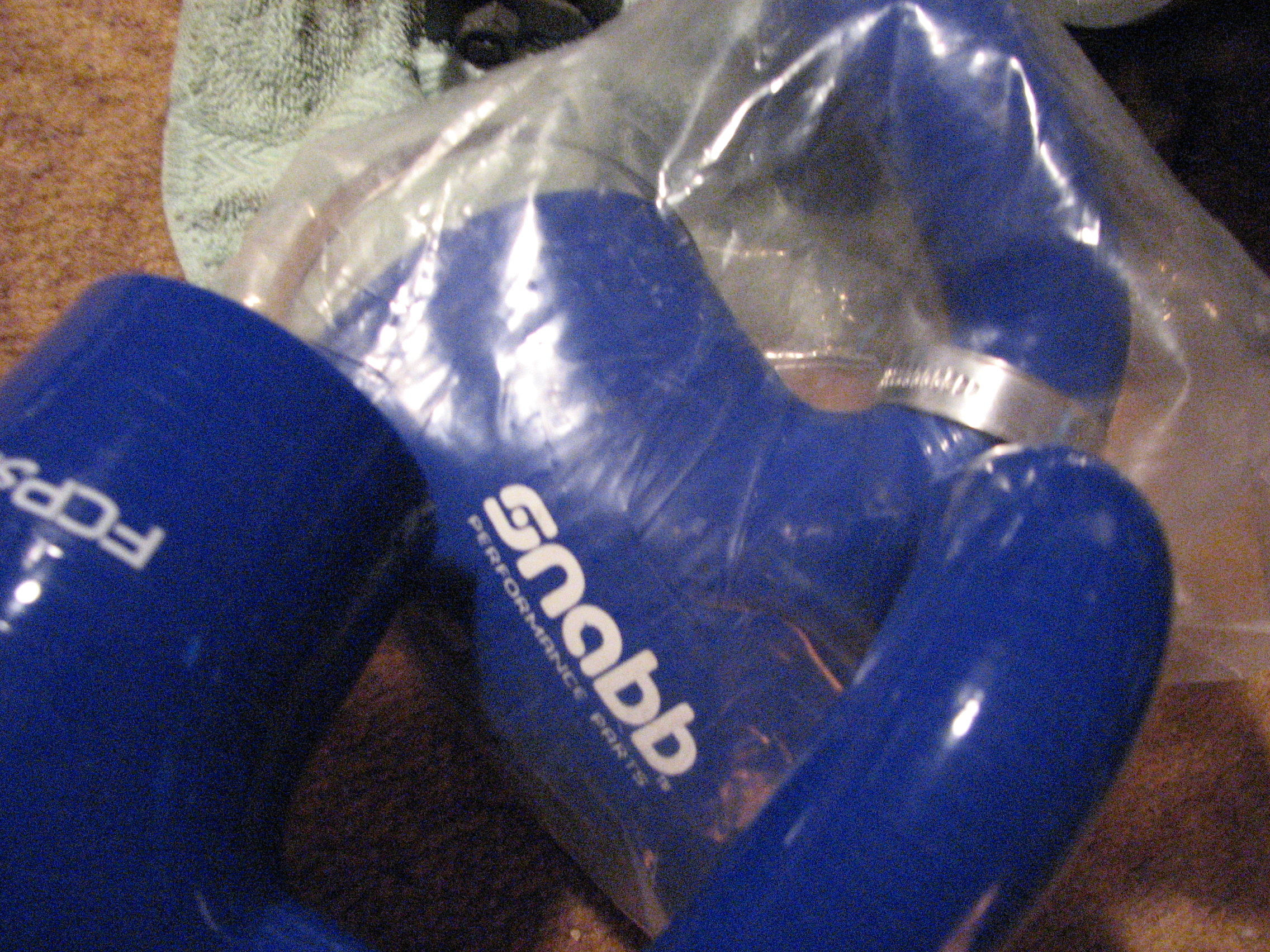

Since I will have the manifold off, I will go ahead with the 3" N/A throttle body and manifold with the 960 throttle plate.
I have already ordered, and received the Snabb 3" intake turbo to throttle body conversion tubing.
This was the one for the '96 wagon project. I have just received the same one.

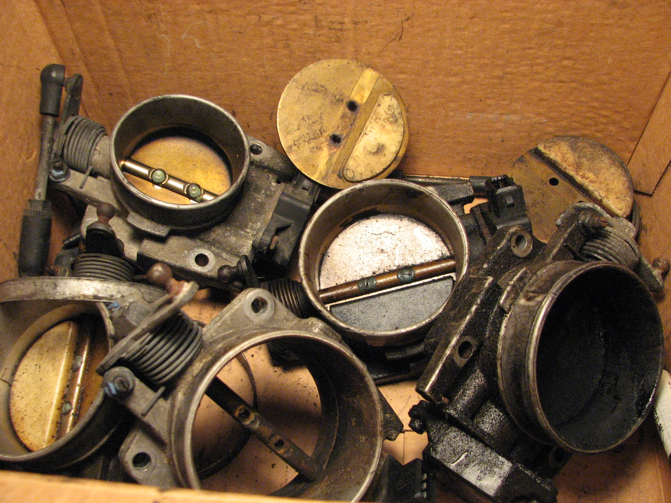

I brought home ah N/A manifold I had picked up last year before I bought the XC. Also my box of throttle bodies. I have enough to make two of the modified type. I will throw one on my '94 black N/a wagon when I get to that.
box of throttle bodies again.

I have already put T-5 ECU in, which automatically deletes the SAS and maps for higher boost. I also have the 16t from the '98 T-5 but that will happen later.
