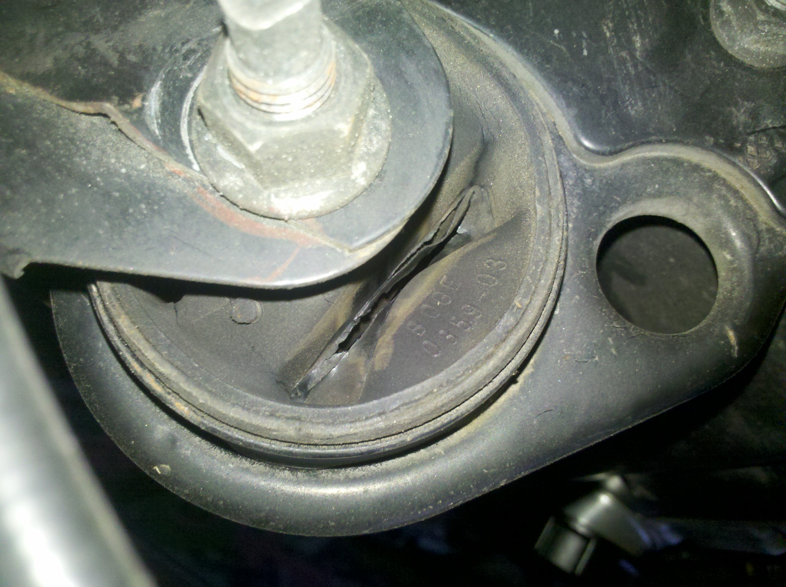

I also checked the upper torque mount of the engine. There is a little tear in it, as can be seen on the picture. But it is in the indented part of it, where it seemed to be only paper-thin anyway. To me, it looks ok. What say the others? By rocking the engine, nothing really moves out of proportion, so I'll rule that one out.
upper engine torque mount

Good thing you replaced the drive axle. Skandix (in Germany) does sell a new inner CV tri-pod bearing for €25 for future reference. Donn't rule out the engine mount as a possible contributor to your symptoms. If it's not too expensive I would replace the damaged ine if I were you. Also check the strut mounts and bearings as I understand they can cause vibrations etc. if the brake pads are still ok you can just replace the discs for less than €100 a set I would think if you shop around a bit, there's so many choices also German made. And 2x on checking the straightness and roundness of the front wheels. Good luck and keep us posted.
