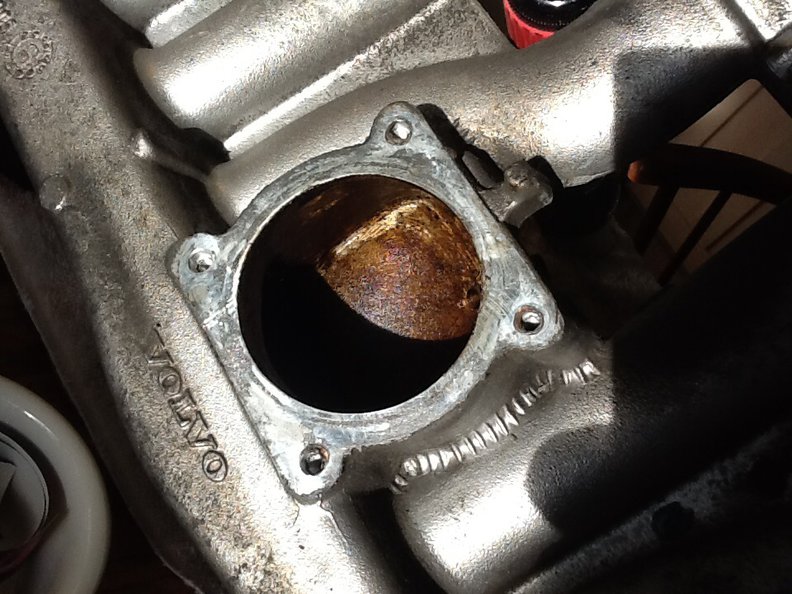

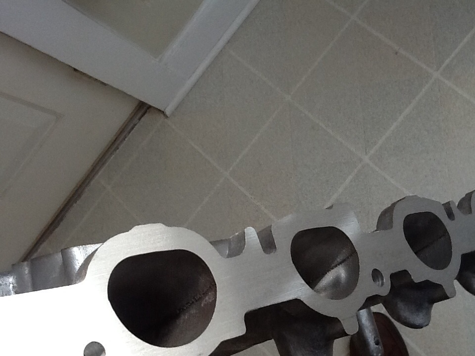

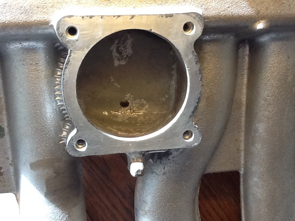

I just my intake manifold back from a head repair shop and it is spotless. Well worth the $20.00.
- image.jpg (151.14 KiB) Viewed 1622 times
- image.jpg (227.44 KiB) Viewed 1622 times
- image.jpg (251.33 KiB) Viewed 1622 times
I used oven cleaner (don't let it soak overnight because most "eat" aluminium ) + pressure washer and a toilet brush is what I used on mine.
It didn't get rid of everything but it was clean enough and cheap
I also tried burning it off with an air compressor and a large propane torch. Didn't really work IMHO. Great for drying though
If you have the option to have it cleaned like kahl, I would go that route.
