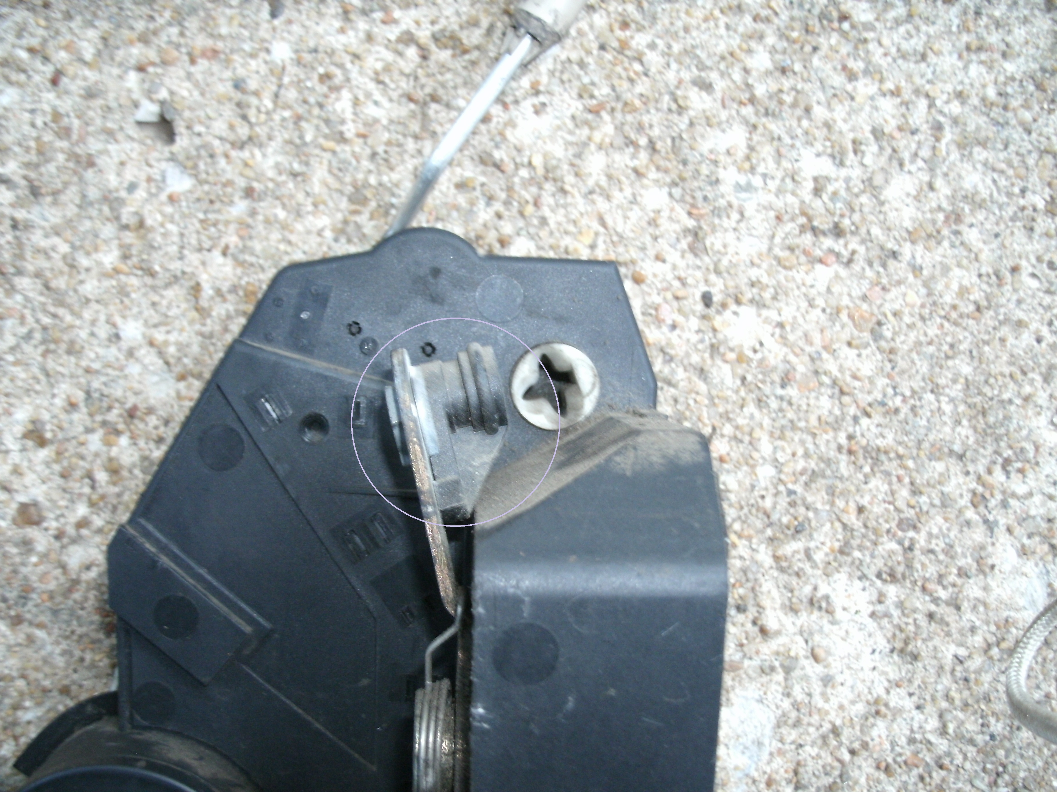

I did some research seems that part # 8618024 is a link which goes between the exterior door handle and the actuator. If correct the car is missing this.
Am I correct?
Madness
Am I correct?
Madness
Ozark Lee
- Posts: 14798
- Joined: 07 Sep 2006, 08:24
- Year and Model: Many Volvos
- Location: USA Midwest
- Been thanked: 76 times
It might be missing but I doubt it. It isn't a loose part, it is captive in the latch assembly when properly installed.
The part number you referenced is shown in the circle on this picture.
...Lee
