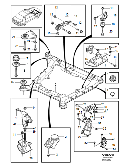

Attached is the diagram from VIDA. #1 is the passenger side engine pad. The repair steps use a wood block and jimmy prier bar to pry up the engine. I guess floor jack with wood block under the oil pan is much easier. Just need to lift it a little bit.BEJinFbk wrote:There's no reason to loosen anything but the bolts on the mount you're replacing.
The jack under the oil pan is the important part. This is a pretty easy swap.
TASCA has pretty decent pricing on stock parts.
For my car (AW42 AWD), there is no rear side engine pad. Seems a good thing for me as the rear pad is harder than front. Instead it has #38 and #42 on the driver side. The repair steps does not illustrate this part though. Not sure if it is easy to access. Maybe take off the left wheel and fender liner it could be visible.
