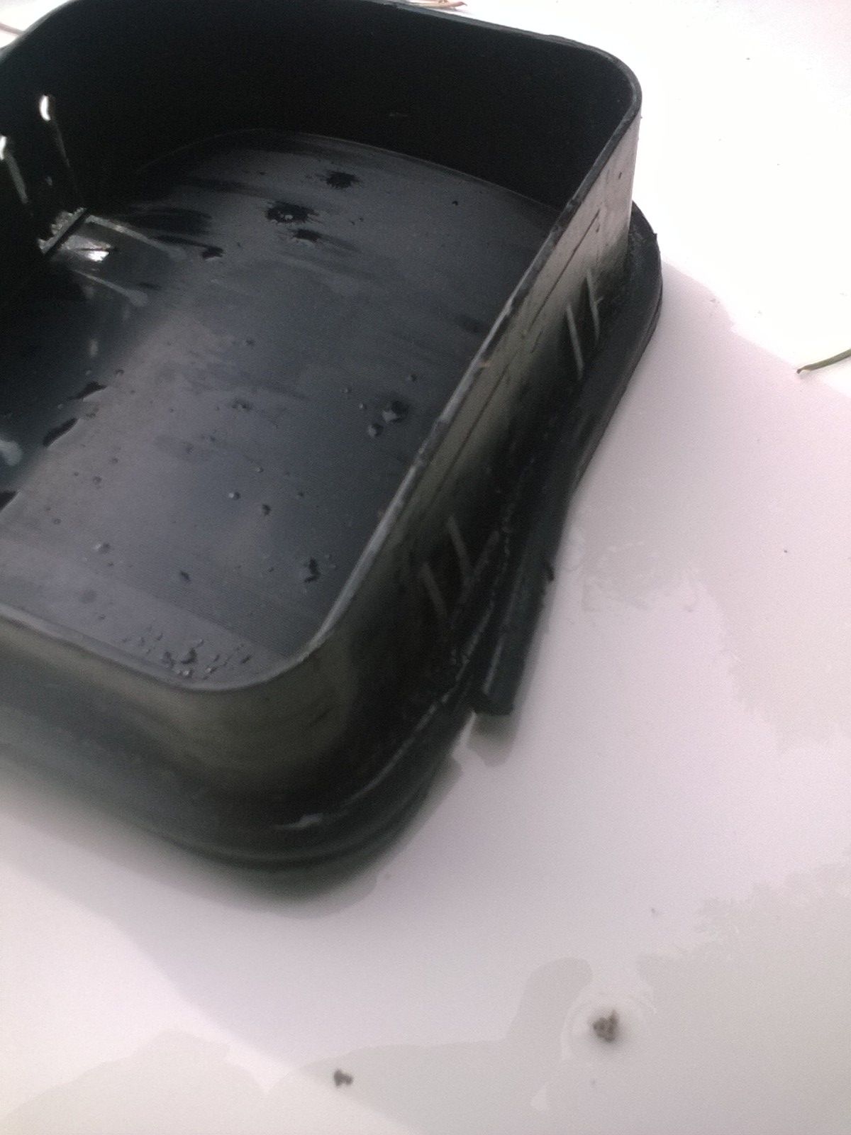

Same problem. In my case water was leaking past shield over HVAC fan inlet. Could not figure out how the water got from passenger front to Driver rear. Answer: thru hot air duct under carpet.
Sealed shield with silicone--no more leaks. (except that **&$* sunroof. Pollen plugs the drain tubes.
