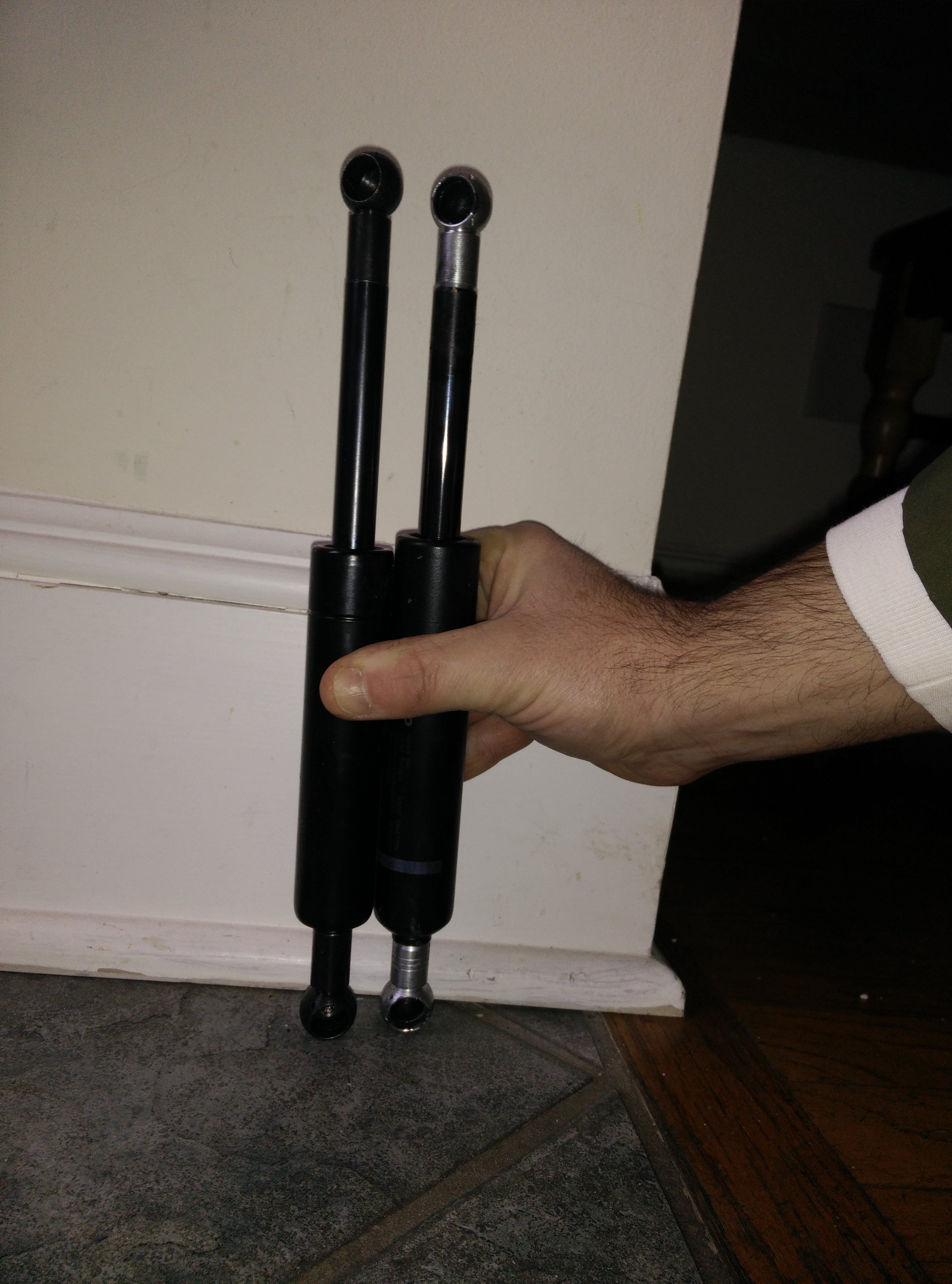

Thanks. I will take a look at the bolts. In the meantime here is a photo I just took. From my phone hopefully this work .

Stabilus only.

Yeah -- I only use Stabilus.

Few months ago when i replaced mine,Stabilus wasn't available.
I bought Monroe Max Lift instead and the price was around 50eur/pair & 2 years warranty.
Stabilus had the same price but wasn't available.
