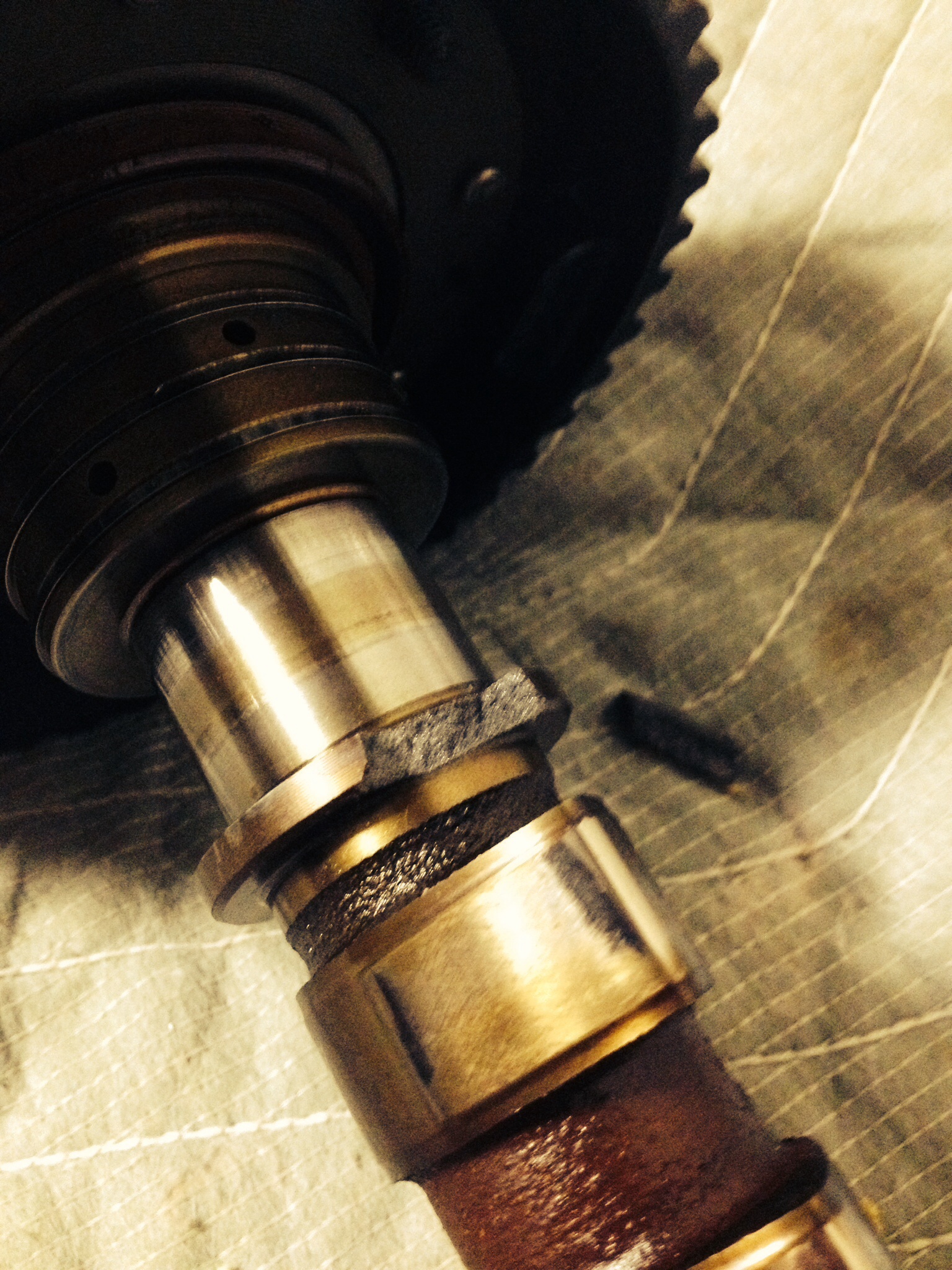

How bad is this Intake Cam?
Post by Florida Wheel »
I did it.

Chamfer the edges of that fracture and it'll be fine. That flange is only for fore-aft location. There is no force fore or aft but the cam has to be controlled so it doesn't move either way.

That's what I was hoping. Thanks Jimmy57, that's great news.

Can you explain how it happened? Just want to learn how to not happen to me. thanks!,!

I was having trouble getting the VVT cover off. It was hung up at the front by the exhaust cam gear. I was using a pry bar type tool to work it off and at some point this happened.
