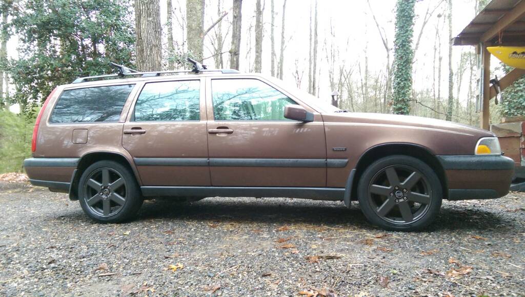

Finally settled on what I needed to do to my wagon to achieve the look I wanted. First I went from 225/35/17 tires to a set of 225/50/17. That filled in the wheel wells better. There is only the slightest rubbing at full lock. Next I tried out a few combinations of struts/springs. Chose some struts meant for a V70 GLT and kept the XC springs so the front kept a good ride height. This my result.
I'm happy. But I wonder of springs from an AWD V70 would make much difference.

Looks great!
I have a set of Volans that I want to put on my XC. Now that I know that 225/50/17 tires work, I might go the same route.
Just curious, what tire make and model did you choose?
