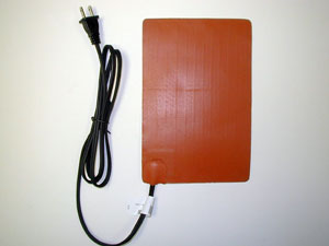

The other big item in Fairbanks is a silicone heat pad:
These are typically installed on the oil pan with high
heat silicone and give you hot oil from the get go.
I also have a long skinny one on my transmission.
