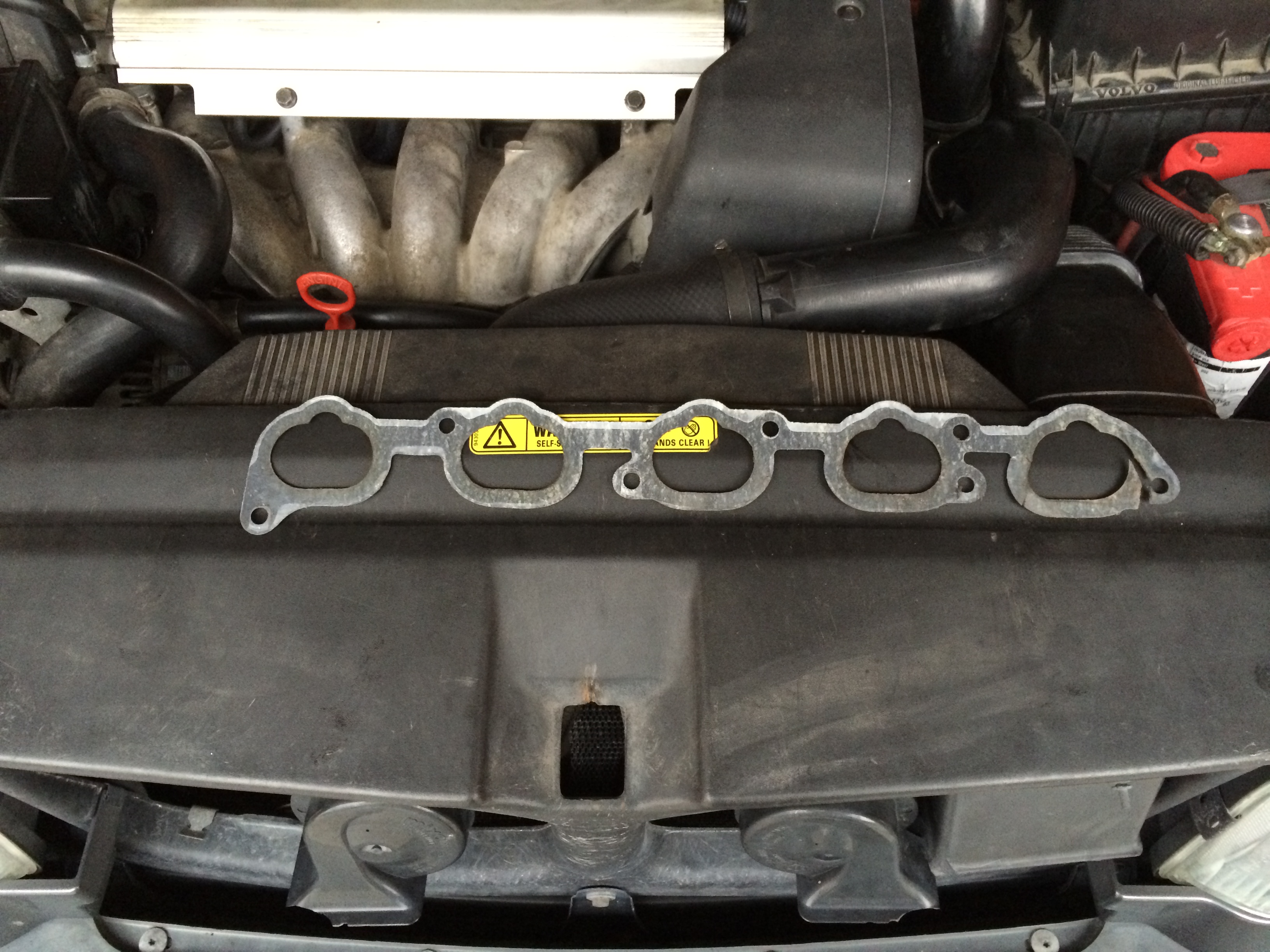

The hissing sound you mentioned here, makes me think it could be a torn intake manifold gasket on the cylinder 5 intake runner. Maybe check your intake gasket next. From reading the previous posts it sounds like your vacuum lines should be ok.Though, its hard to tell sometimes with the hissing noise either a pully or the serpentine belt makes, along with the hissing from the idle air control valve.
Last spring my 850 Turbo had the code for a misfire in cylinder 5 with the 3 way Cat damage code along with other strange codes. I think the knock sensor codes may have been in the mix too. The engine ran poorly and could barely hold an idle without some throttle. Shown below is how the old intake gasket looked like on my car when I removed it. After replacing the gasket with an OEM Volvo one the codes haven't returned and the engine runs smoothly.

The intake manifold gasket wasn't original to the car as I replaced it when I put in a new PCV system around the May 2013 timeframe. I think mine became torn was some of the intake manifold bolts were loose on that side and the manifold jiggled around slightly and eventually tore through the gasket.
Normally a hissing sound shouldn't be heard from the IAC area. When the key is in position II (engine not running) the IAC valve should buzz, but shouldn't produce a hissing sound. With the engine running, does the hissing sound come from the top of your manifold by the IAC area or from somewhere down below?
The hissing sound on my car was coming from below the IAC area by cylinder 5. A new intake gasket was installed when I replaced PCV system as part of my Stage 0 plan. I thought maybe the hose that connects the oil trap to the PTC may have broken where the hose bends to go around the engine block. But while feeling around in the area I couldn't find an air leak. I did a tune up on the car, bought a new MAF sensor, and a installed a new fuel injection relay, but had similar results. At last the problem with the intake manifold gasket was identified. I found this out by one of the lower intake manifold bolts were loose by cylinder 5. After tightening up the bolt and checking the other intake manifold bolts the engine ran better but the damage was already done to the gasket. The next day I went to my Volvo dealership and bought an OEM one (I didn't want to wait for shipping
). With the new OEM gasket installed the hissing went away and my Volvo ran better than ever. Another interesting anomaly with this issue was the boost gauge needle didn't go most of the way down the vacuum (left) side when I coasted.
